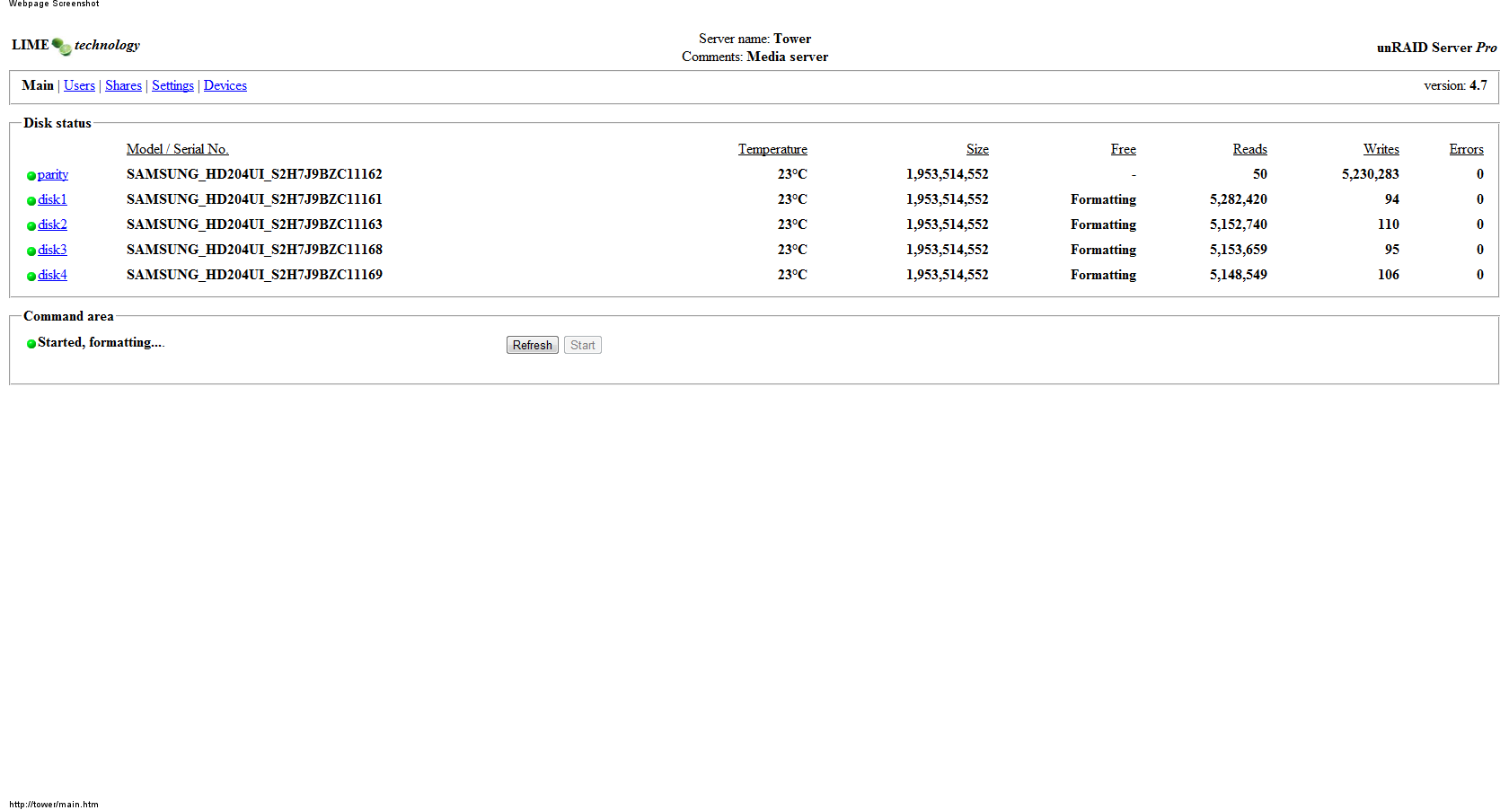

Just recently got an unraid setup. I installed 5 disks in the computer, all brand new and completely without format. I choose a parity disk and 4 data disks, and then clicked format and start. The party disk built over 8-9 hours, but the formatting never finished. After the parity finished rebuilding, all the disks spun down while the disks still show formatting status. I can not stop the array via unmenu and no indications of progress on the format are in syslog.
I have attached a complete syslog, and a screenshot of the main console. I'm happy to back out at this point and run preclear_disk.sh manually before formatting (so it happens fast), but I don't want to damage anything backing out at this point. If I force umount all these disks and reboot, then run preclear_disk.sh, will everything just work?

syslog-2011-08-21.txt
