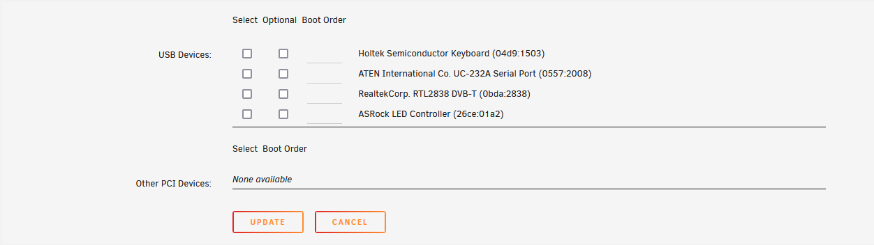

PCIe Passtrough "None Available"
I would like to passtrough Coral AI (M2) to HAOS VM, but this function none availabe in my UNRAID server. :(
I think I have everíthing set up to make it work, but it still won't.
Some can help me?

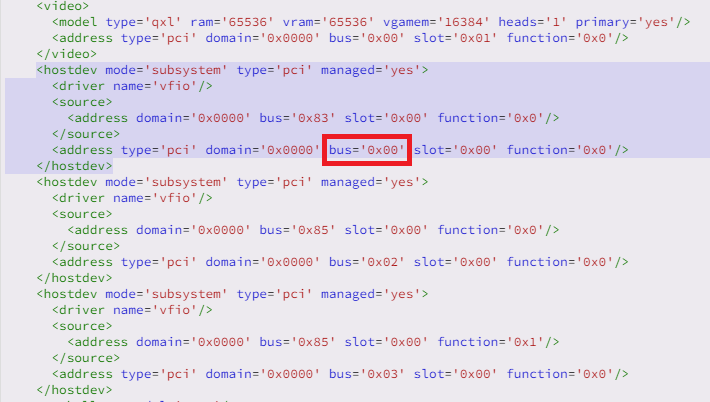

  • Stop vm, Edit xml and change to XML view via the slider top right    Make a copy of the XML before changing. Creating diagnostics will have a copy of the xml in it also.
  • Yes you can edit here /usr/local/emhttp/plugins/dynamix.vm.manager/include/libvirt_helpers.php   Around line 766 you could do this   if (in_array($arrMatch['id'], $arrBlacklistID
  • Thank You very much. This is working for me!

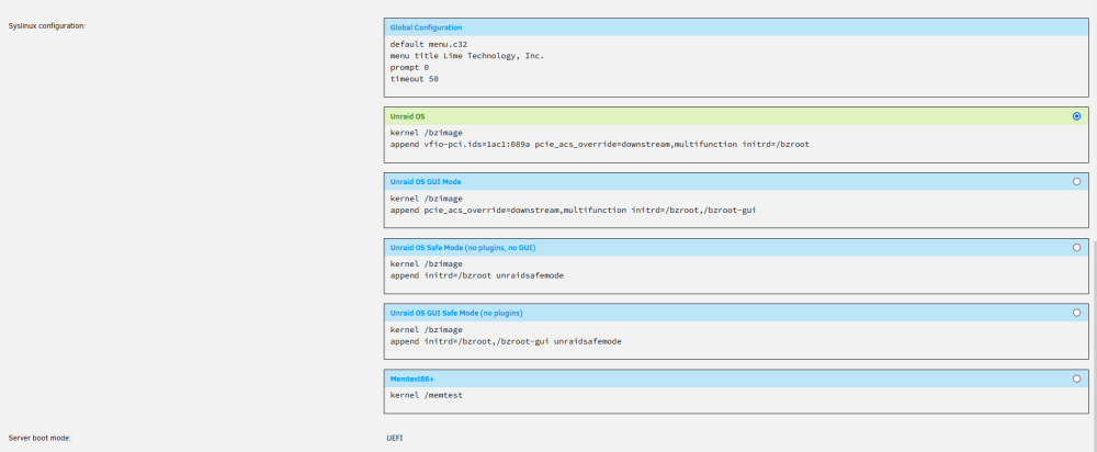

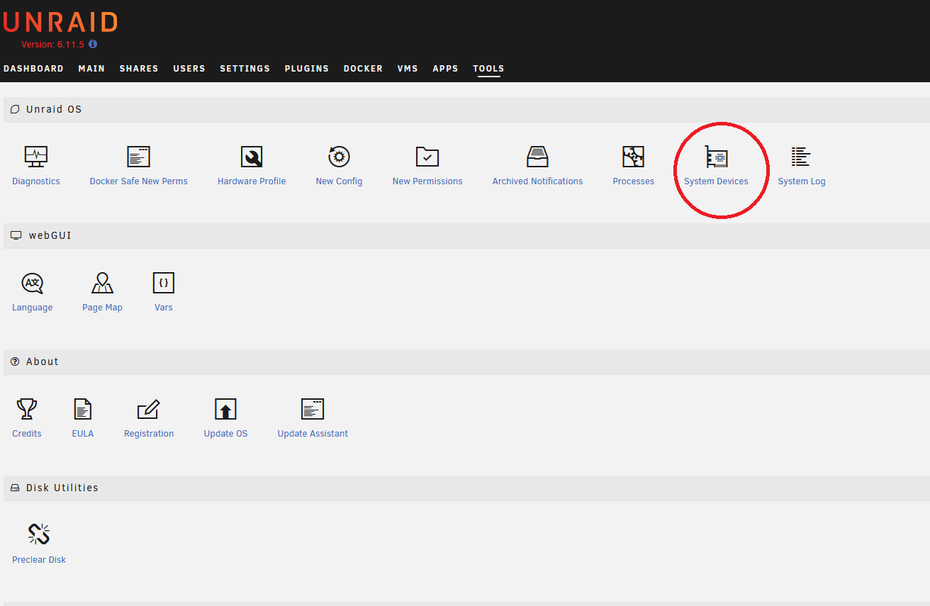

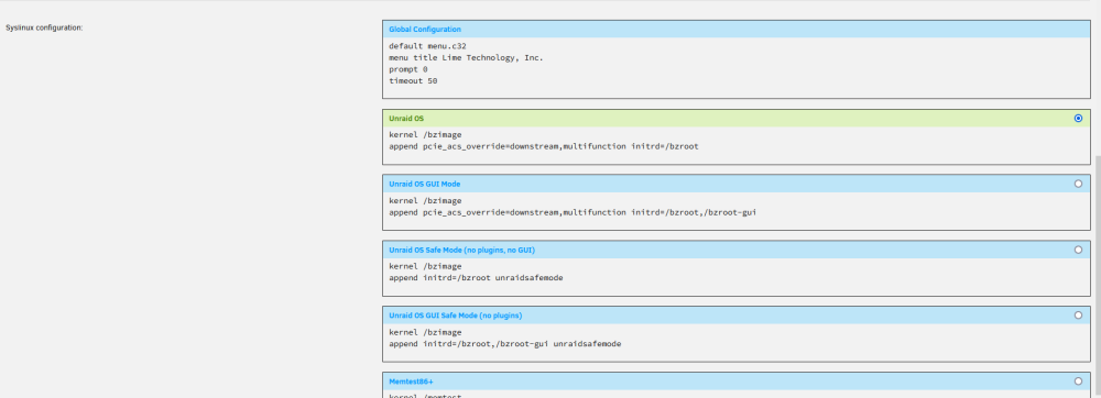

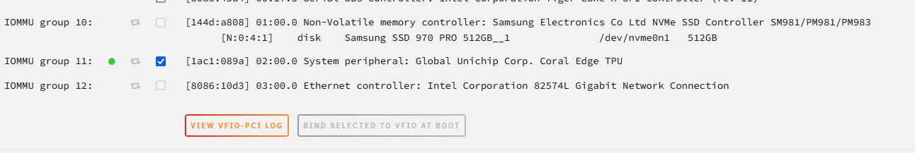

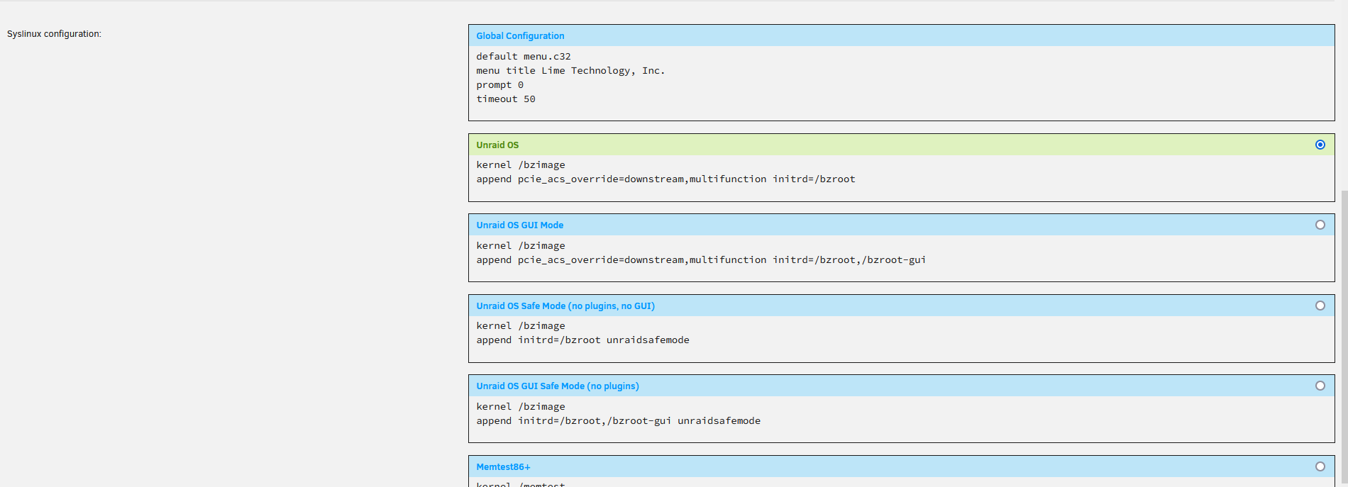

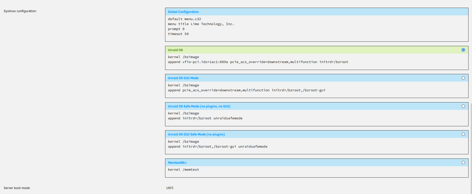

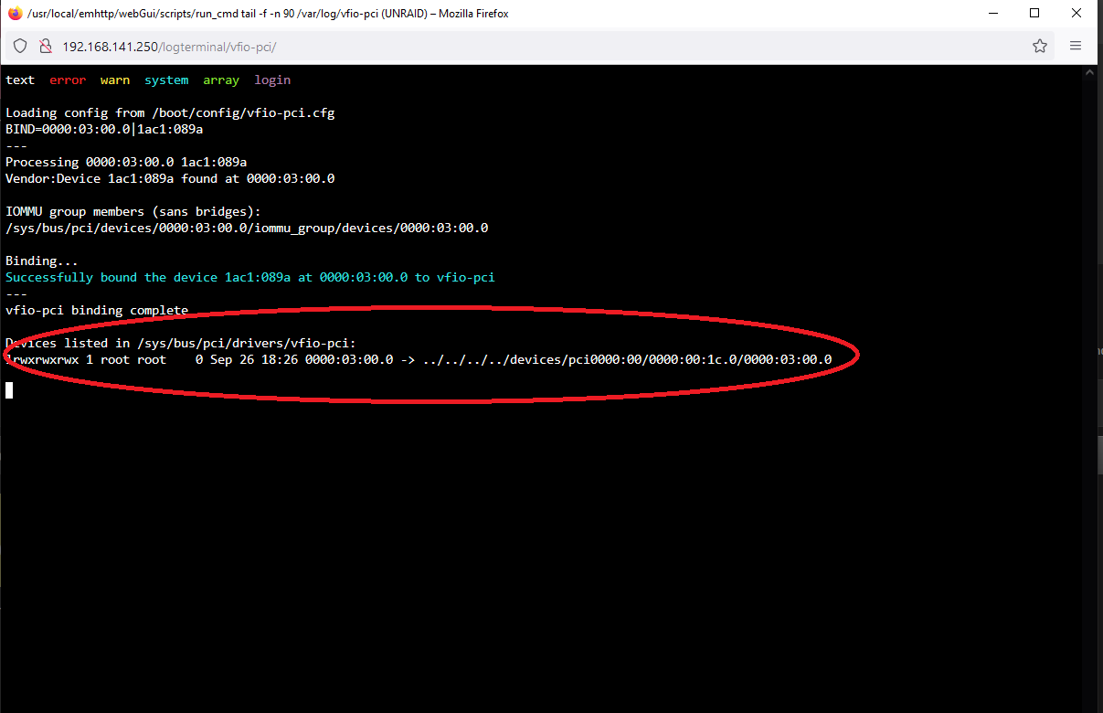

delete vfio-pci.ids=1ac1:089a from syslinux, reboot, and you should see it listed for passthrough.
I deleted it and reboot, but It is still not visible in VM config. :(Unraid.thumb.PNG.0e47a35dc07cbb5291b957d1f80f7524.PNG

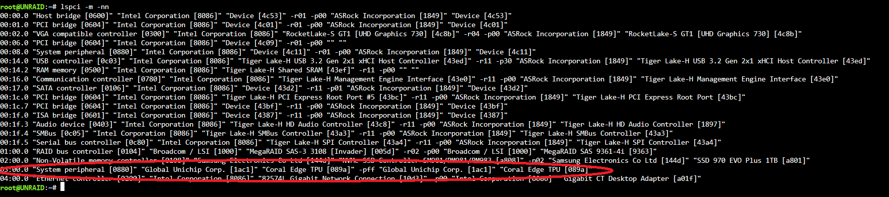

Do you know the device class for the devices you are looking to passthru.
lspci -m -nn will provide that info.
Devices with these classes will not show. starting with 05|06|08|0a|0b|0c05
i.e. Video start 01 or 03, audio 04

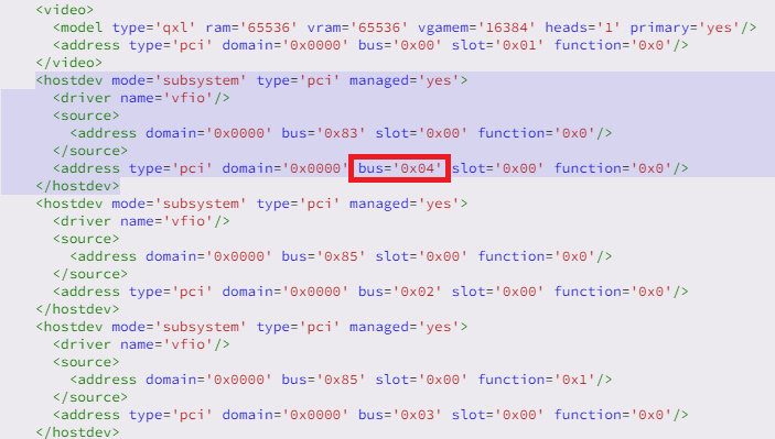

Will look into type 08* but currently the gui blacklists. You should be able to add as a manual xml change.
How can I add manual?

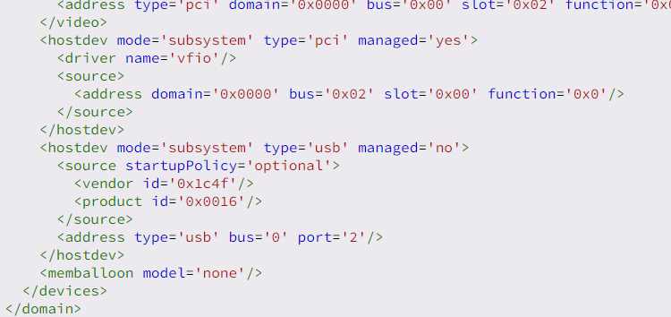

      <driver name='vfio'/>
      <source>
        <address domain='0x0000' bus='0x02' slot='0x00' function='0x0'/>
      </source>
    </hostdev>

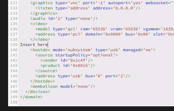

Add the above after the /video section. Be careful to on the source address. Device must be in its own IOMMU group. If you make changes via the gui page these changes may be lost.
I'm sorry, but I don't know which file should I put this in...
Stop vm,
You will now see the XML view scroll to be bottom. Be careful not to remove sections.

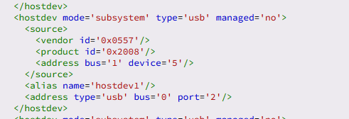

So would look like this. But you may not have the usb part as that is a passed through USB device
Ok, I will try it tonight.
These addresses az OK for my case?:
it was from your first post but looks like it may be 03 in the current lspci but difficult to see with red circle

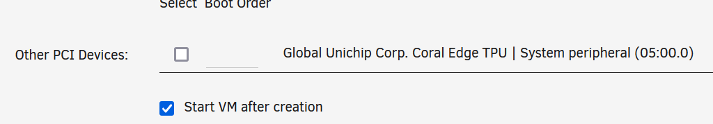

Is there a reason there's a blocklist? Is it just to try to prevent people from being silly and passing through things like core system components? IMO, showing them in the UI but graying them out would be a better user experience for this.
Is there a way I can hack the UI code to remove the blocklist, at least for 08:80?
01 is storage, not video. 03 is video. 08:80 is just "system peripheral" which is a bit vague.

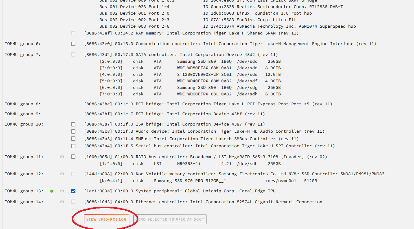

Yes on my Dual CPU Supermicro MB the list would be large is below. Should have been 0001 and 03 for video.
I can look to see if bound to vfio it could appear in the list or maybe some other option on system devices.

root@unraid:~#
This is what is current omitted.

I just totally deleted the blacklist regex check, and now I see the Coral:
If I select it, then revert libvirt_helpers.php back so that the blacklist is in effect again, will modifying the VM in the web UI remove the device?

17 hours ago, SimonF said:
Stop vm,
how did you find the address?
thank you for your answer but for me it doesn't work in the vm I don't see it
