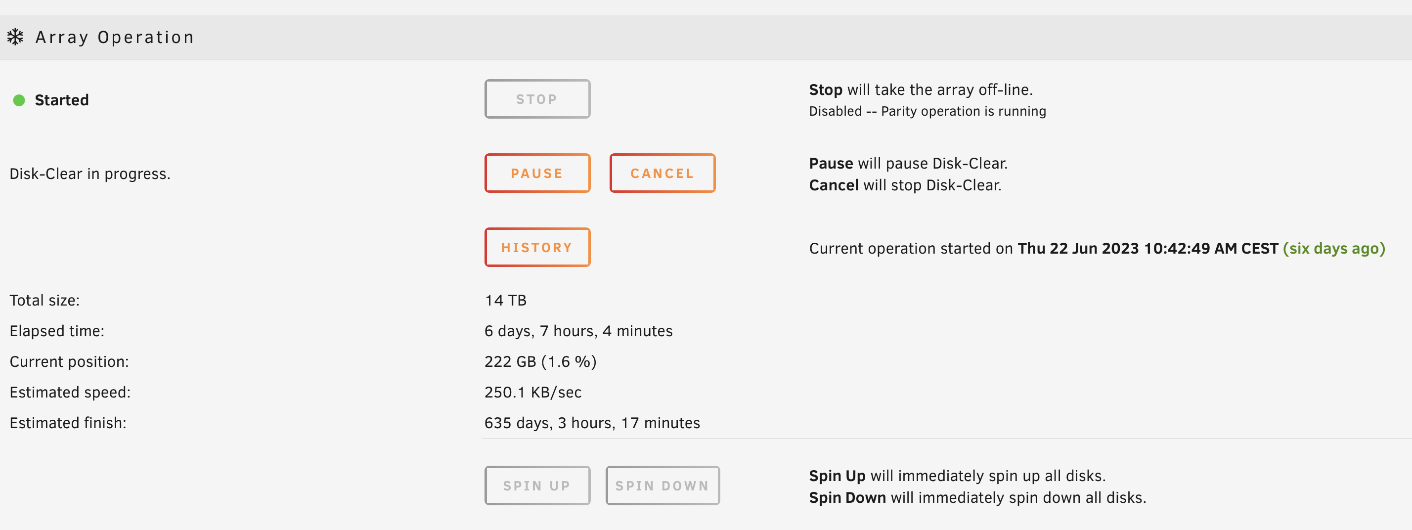

I have installed a 14 tb drive. Disk clear is running really slooooowly. It. is projected for 500-600 days.
Is there a way to skip disk-clear or speed it up?
I need the drive online asap.
Thanks
There is something going wrong!   You are likely to get better informed feedback if you attach your system’s diagnostics zip file to your next post in this thread.
Not sure why the clear is going so slowly :(   I would normally expect it take something like ~2 hours per TB.

You cannot use the drive until it's been cleared, if you forced it it'd invalidate your parity protection.
Maybe a reboot could help, if not it could be a hardware issue...

probably need to try a new drive.
