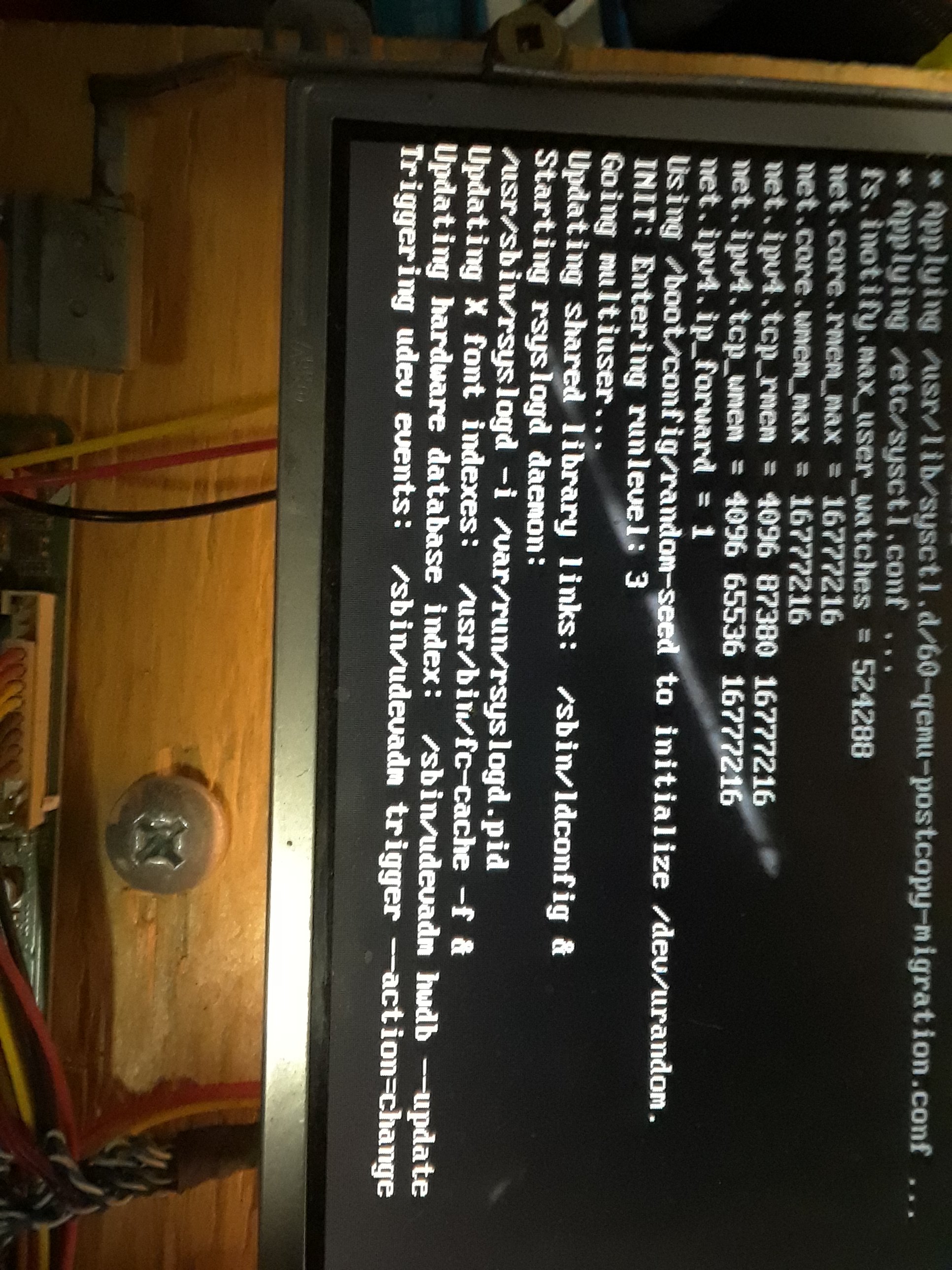

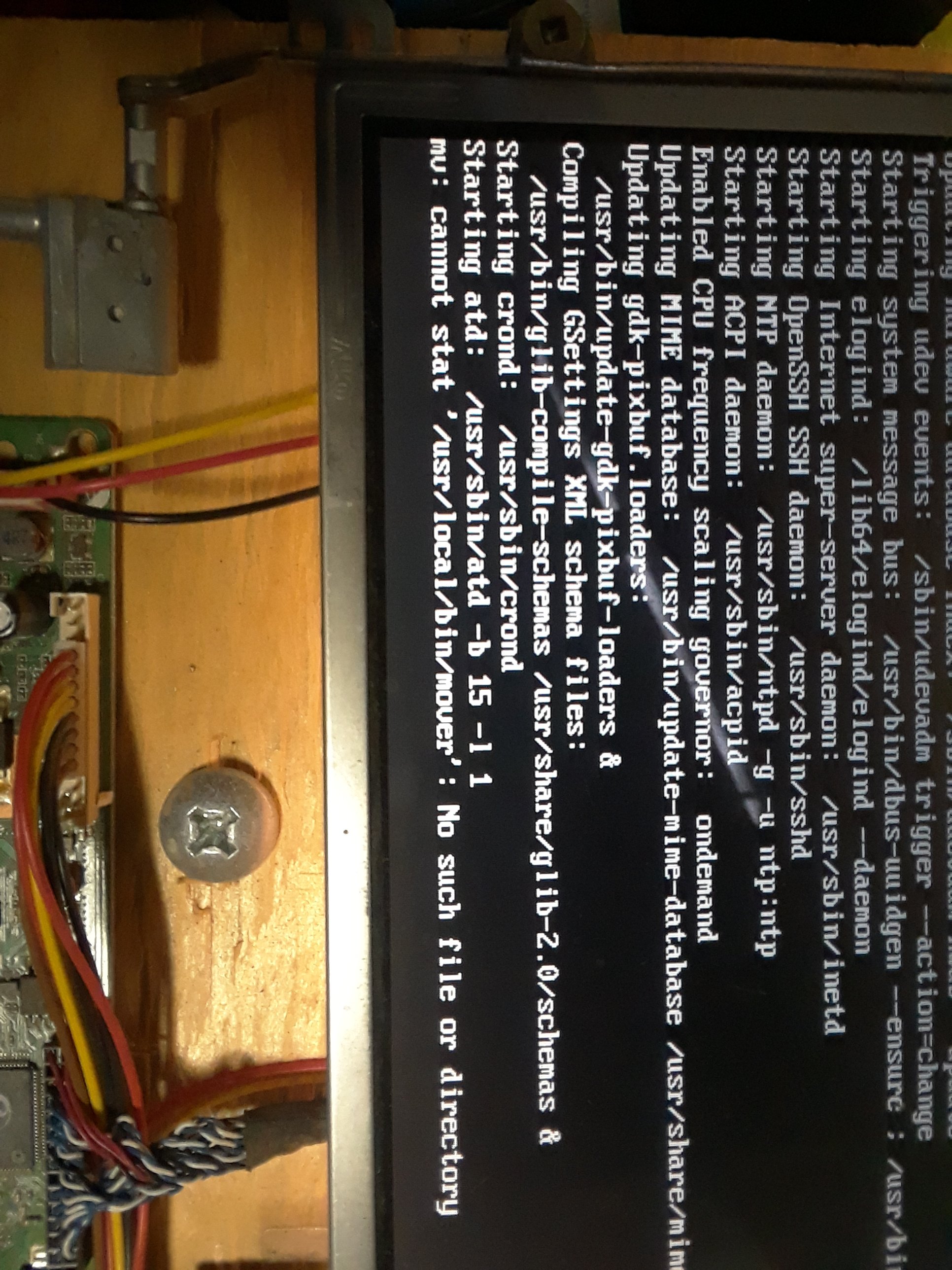

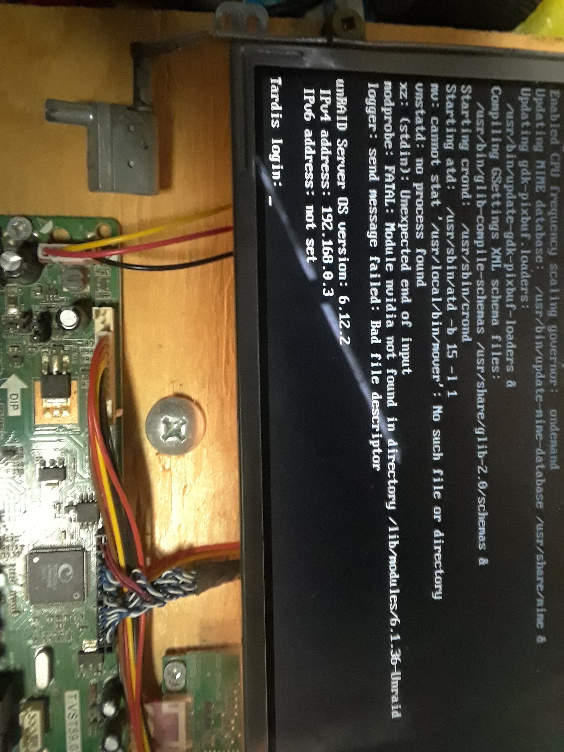

So i not sure after a clean bootup.. i still get this hanging  of the udev..  and the mover error  this time  mover didnt hang as long...  but i do have alot more errors.. whats creating them all how do i fix them etc... and fix this udev hang  it takes a few min or so
and i do not know why the images are side ways as i take them the same way..

maybe no one knows the answers?
and why do i keep getting these errors tooo... and the array is super slow now too

There are multiple erros in your diagnostic, it should not happen during the boot up. It seems something is broken in your system.
Also 6.12.x is a newly releaesd software which might not be stable enough.
I have checked my plugin with my hardware which both have r8125 and r8156 network card, everything is fine with the network. So the issue might not come from my plugin.
I would recommend to install a brandnew Unraid 6.11.5 system and see if it can remove those errors. It should be fine with a clean Unraid system configuration. You'd better reconstruct the system, and install previous plugins one by one.
Edited by jinlife

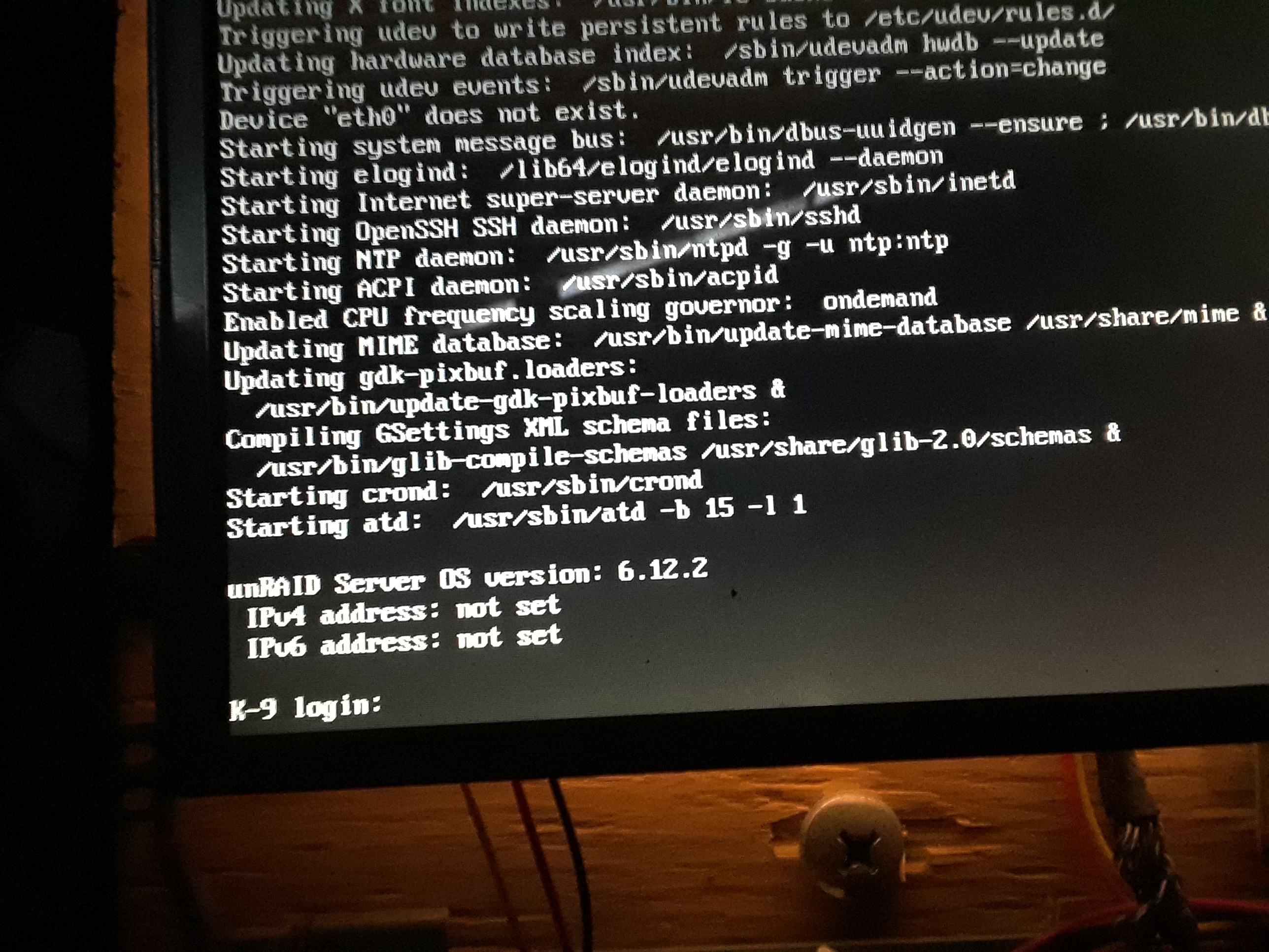

so i did this test..  as i cant do anything yet with Tardis main server
so i did the k-9 Server..
i erased my usb
i installed. 6.12.2  i copied over the key file
i booted up. and created a password to login
so i was able to get into the system
i installed  Community Apps
searched the r8125 and installed

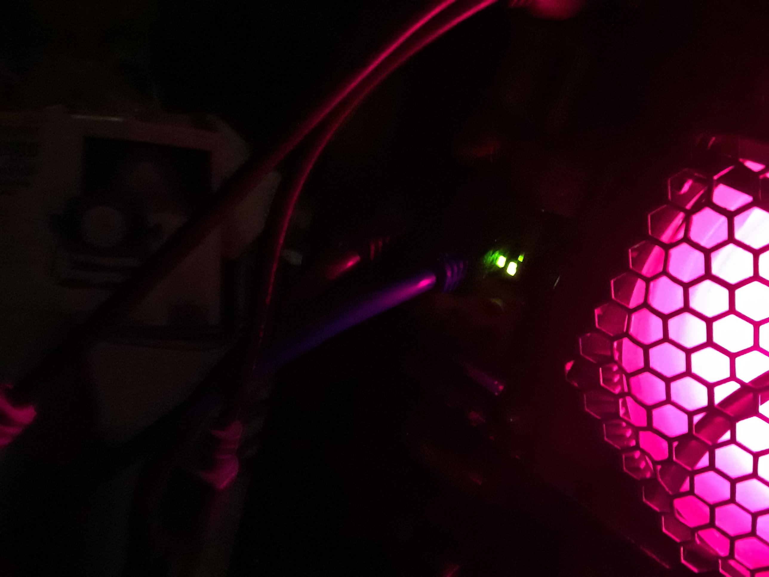

i rebooted.. and the network card no longer works
the activity light on the nic  isnt flashing  just the green one...
testing on
Asus TUF Gaming X570 Motherboard
Edited by comet424

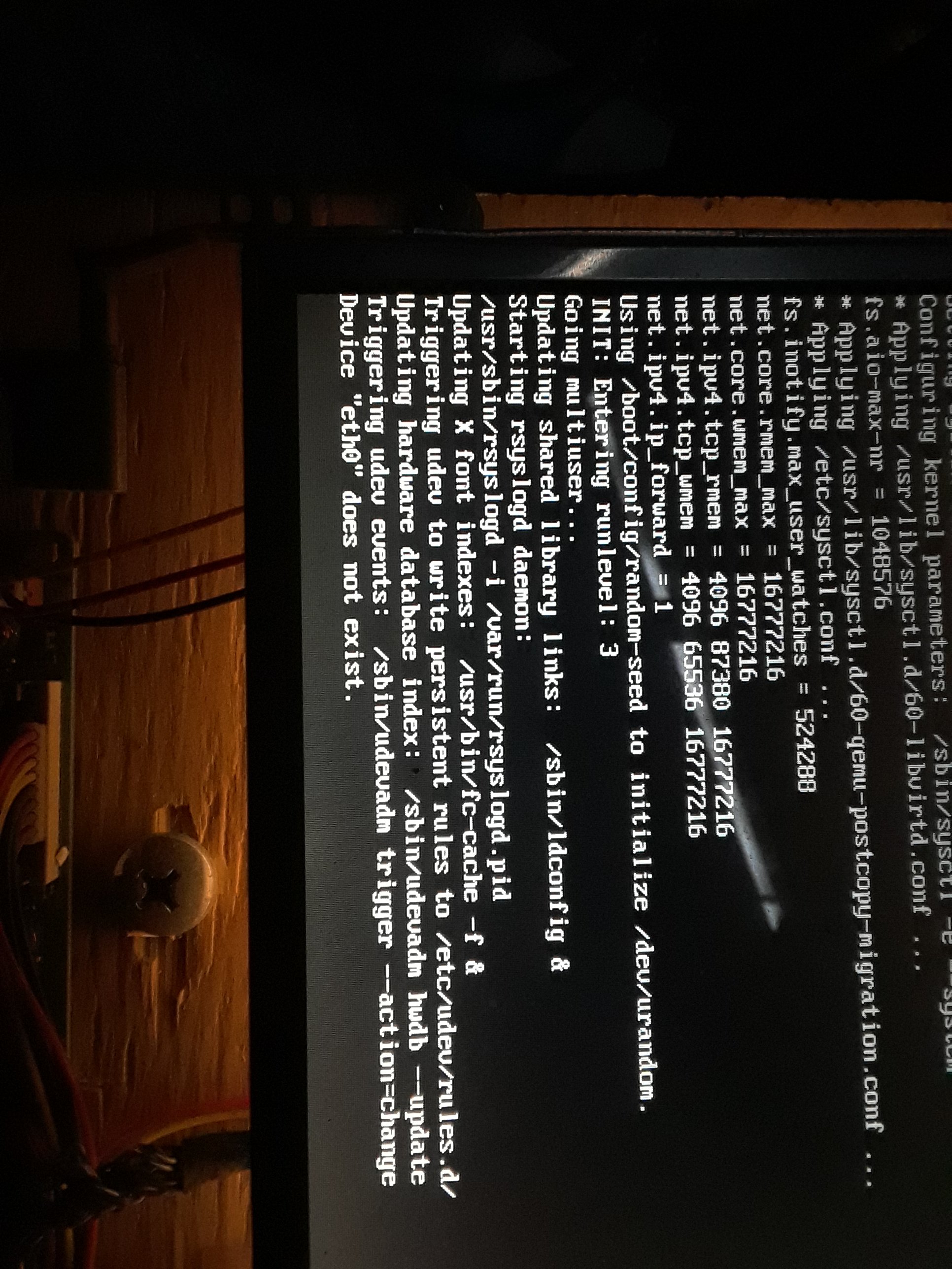

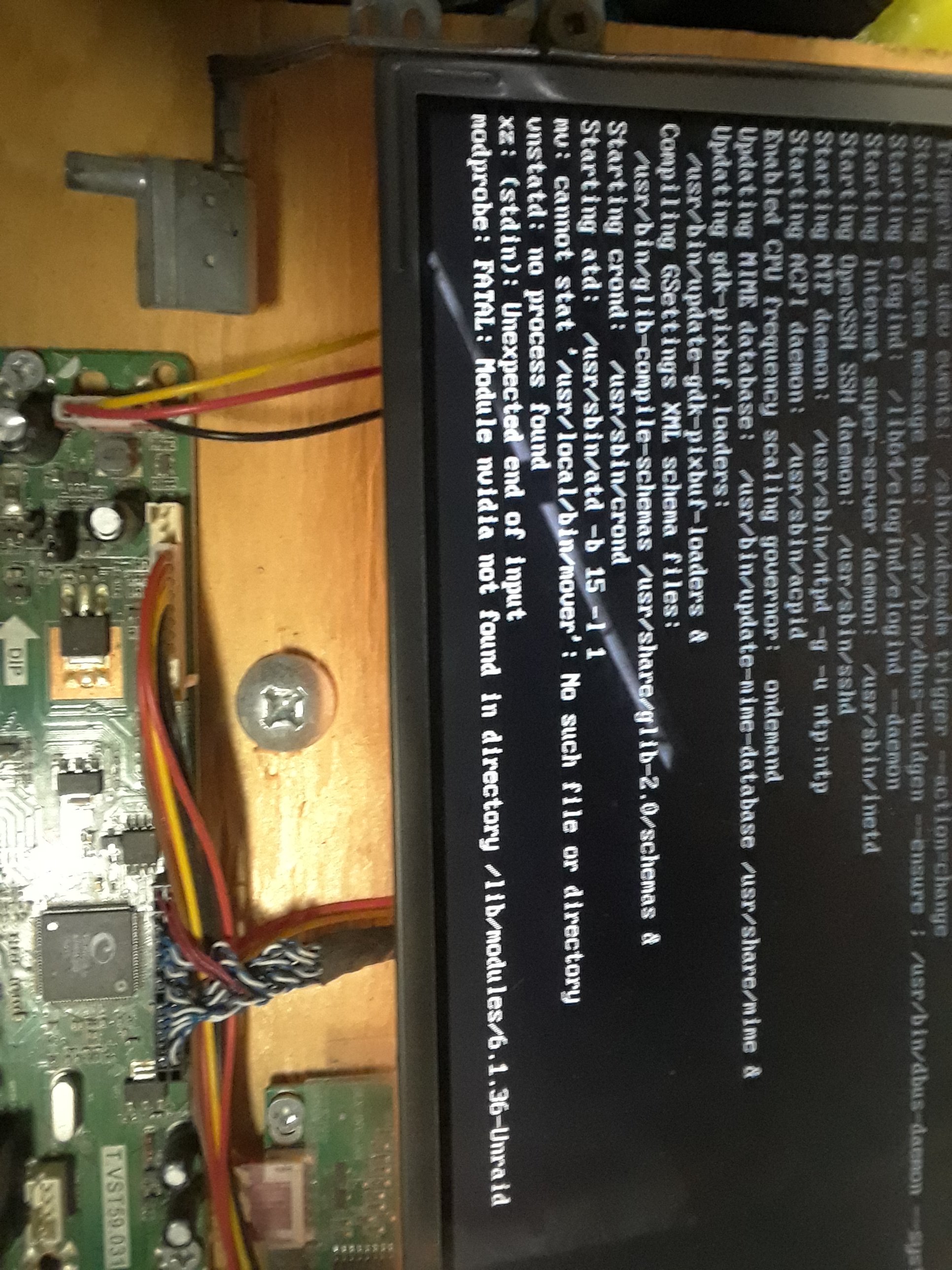

i cant seem to fix the issue
where it hangs at
triggering udev events...
what is that.. and why does it hang    i have disabled my nics  i have uninstalled the plugins except CA and user scripts and it still hangs alot there... what is that really?
udev is what detects your hardware. For whatever reason this system is slow to respond about what hardware is connected.
It might(?) help to go in your bios and disable things you aren't using, like bluetooth, wifi, serial ports. You could try messing with USB settings, like enable/disable legacy mode. Just some ideas, no guarantees : )

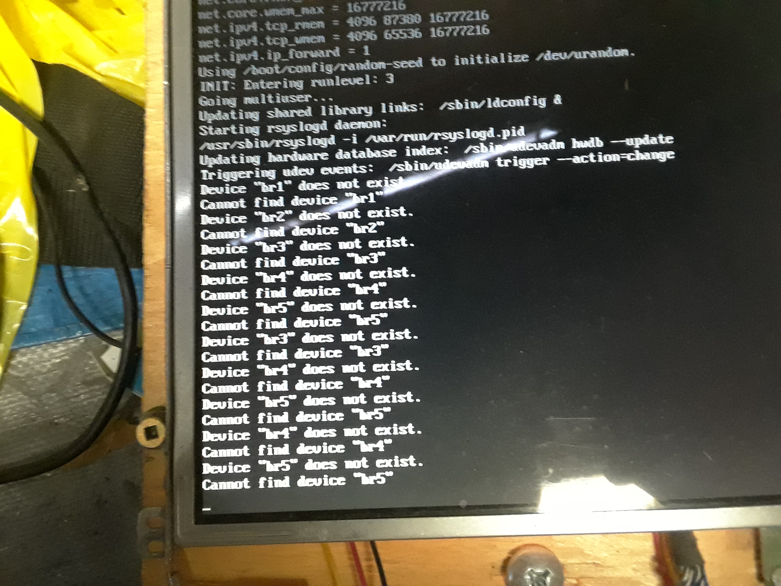

i do get some other errors maybe you know
right now im getting this warning
Jul 7 18:12:28 Tardis kernel: tsc: Fast TSC calibration failed
and if i enable Bridge Mode on my network card  so   i enable  br0 br1 br2 br3 br4 br5
well  you can see in the above pic it shows it doesnt exisit.. yet it does exist as its linked to each of my ports.. i use for home assistant
since my very old switch cant run multi vlans through 1 port so i gotta make them through multiple lan connections
would you happen to know why its saying that? thats another point it hangs at

@ljm42  im on right now 6.11.5   no the delated bootup was a problem for a year  i think it just imported the slowness from the other versions maybe a glitch
as i had a mover error  as it wasnt working  and it showed it in the bootup  like in my previous messages  youd see the errors.... then when i upgraded to 12.0  1. 2.  it got worse i had wind something error and nbm error or something its in my above.... so  the other guy  wwas helping me...  and then suggested basiclly go back to 11.5   that 12.x  just isnt stable enough
like at this moment its faster then it was.. its now hanging at the br2 br3 br5 doesnt exisit  it does it three times before it gets to the login
but if i turn off Bridging mode on the lan ports then those errors dont come up and then its a bit faster now

and so things running better so far...  but if i enable  my Bridge mode on my network cards
it hangs in boot up  saying device not found...
why does that happen...  does your driver fix that  as  i dont get an error on BR0  which is the bridge of the Onboard Network card.. i just get the errors on the Bridge mode of the PCIe 4 Port Network card...
