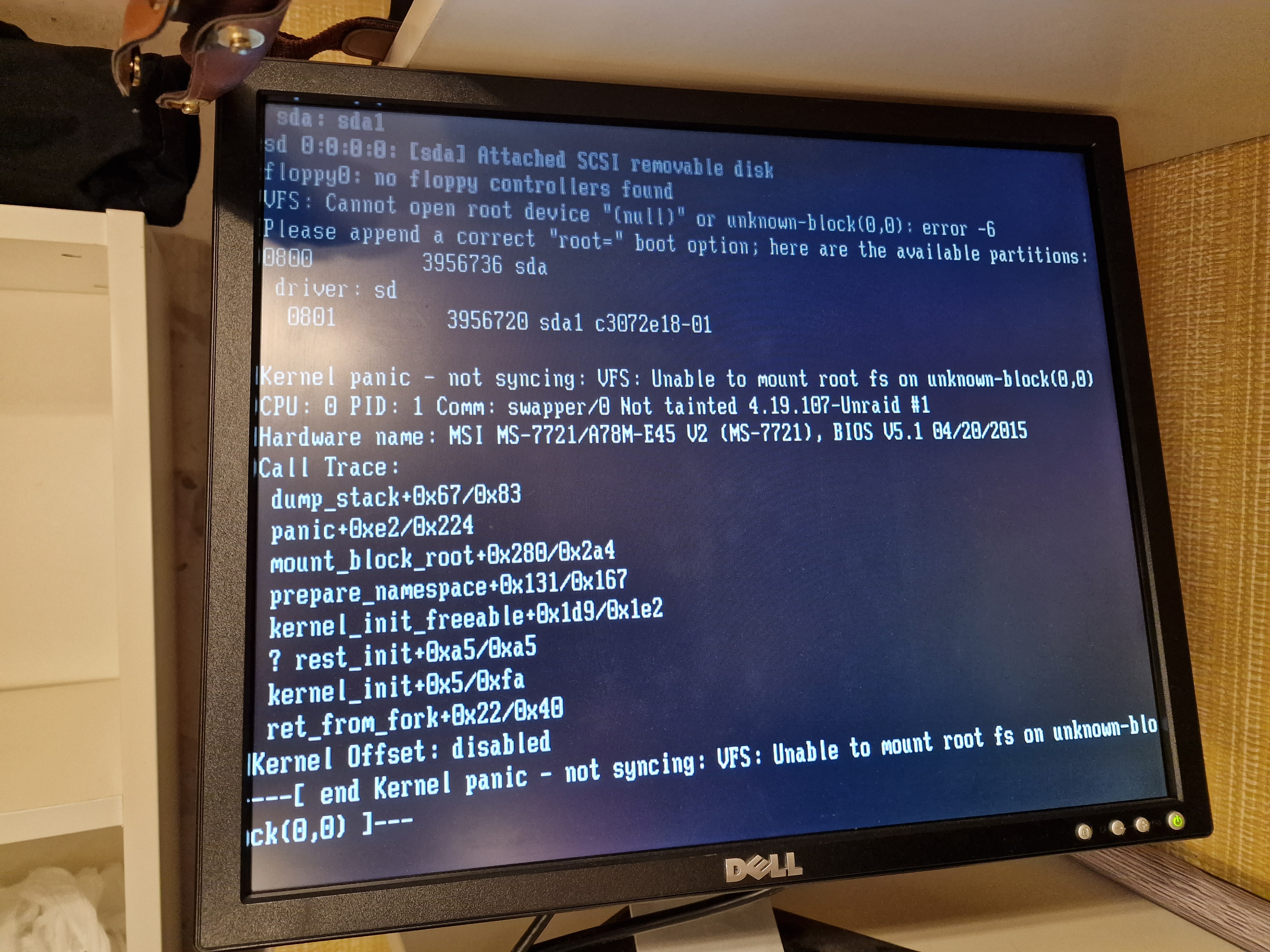

June 28, 20233 yr Hello, So after a shut down after the server my Unraid NAS won't boot anymore. It get's stuck at "Kernel Panic - not syncing: VFS: Unable to mount root fs on unknown -block (0,0)". It may have been an unclean shutdown due to the power being shut down by electricians that worked recently in the house but not entirely sure. It hasn't been powered on for the last 2-3 months. I've been running this system since 2015 with the same Flash Drive (Generic brand) and upgraded essentially the server with the new Motherboard, CPU and RAM like 3 years after that because the previously motherboard died. However both configs has run flawlessly until now. I have no backup of the USB Flash Drive but I can access it using my laptop so I copied every file from it to my desktop. I'm also unsure what exact version of Unraid I was running because I haven't updated for a couple of months. What I've tried: - Tried to write a new Unraid bootable system on two different Kingston Datatraveler 4/8GB and copied the config folder from old Flash Drive, ends up in bzfirmware error - Tried to copy the whole old Flash Drive contents to two different Kingston Datatraveler 4/8GB but resulted in the same error as the beginning. - Tried to write a new Unraid bootable system on two different Kingston Datatraveler 4/8GB without copying the config folder and tried to boot using them. Ends up in endless bootloop after verifying all the bz. files. and the proceeds to boot the system again and then after verifying the bz. files automatically reboots. - Tried older versions in the Unraid USB Creator Tool, also no success. - Tried different USB ports, both 2.0 and 3.0. Please help me out. I'm out of ideas. I really need to access my files again and hopefully using my old config folder. Thanks in advance! Edited June 28, 20233 yr by Husramash
June 28, 20233 yr Community Expert Your original symptoms are what you typically get if there is trouble reading one of the bz* type files off the flash drive. Are you trying to boot in UEFI or legacy mode? If UEFI mode check that the EFI folder on the flash drive does NOT have a trailing ~ character. Make sure you first try this with a clean install in case there are problems with your config settings.

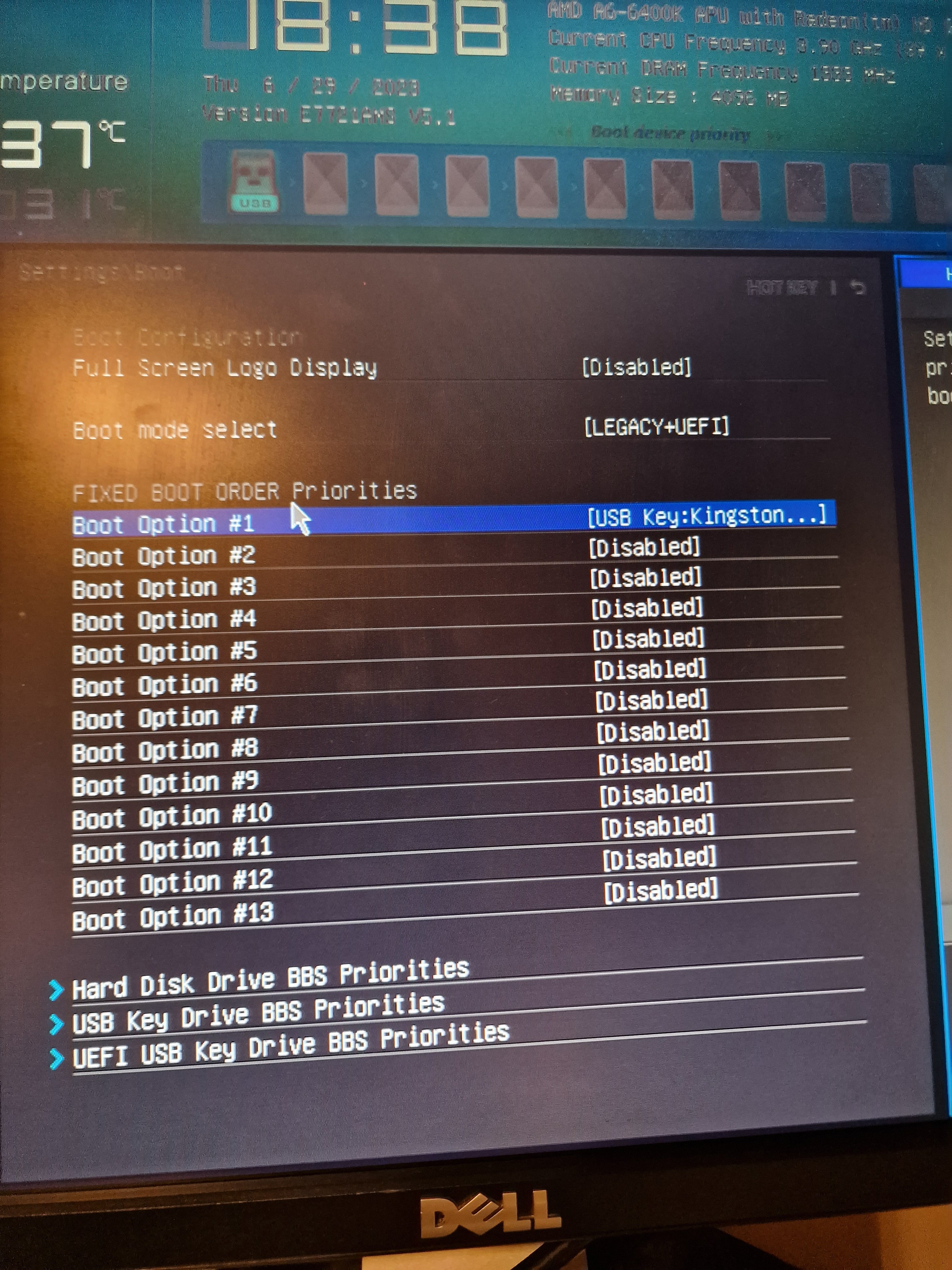

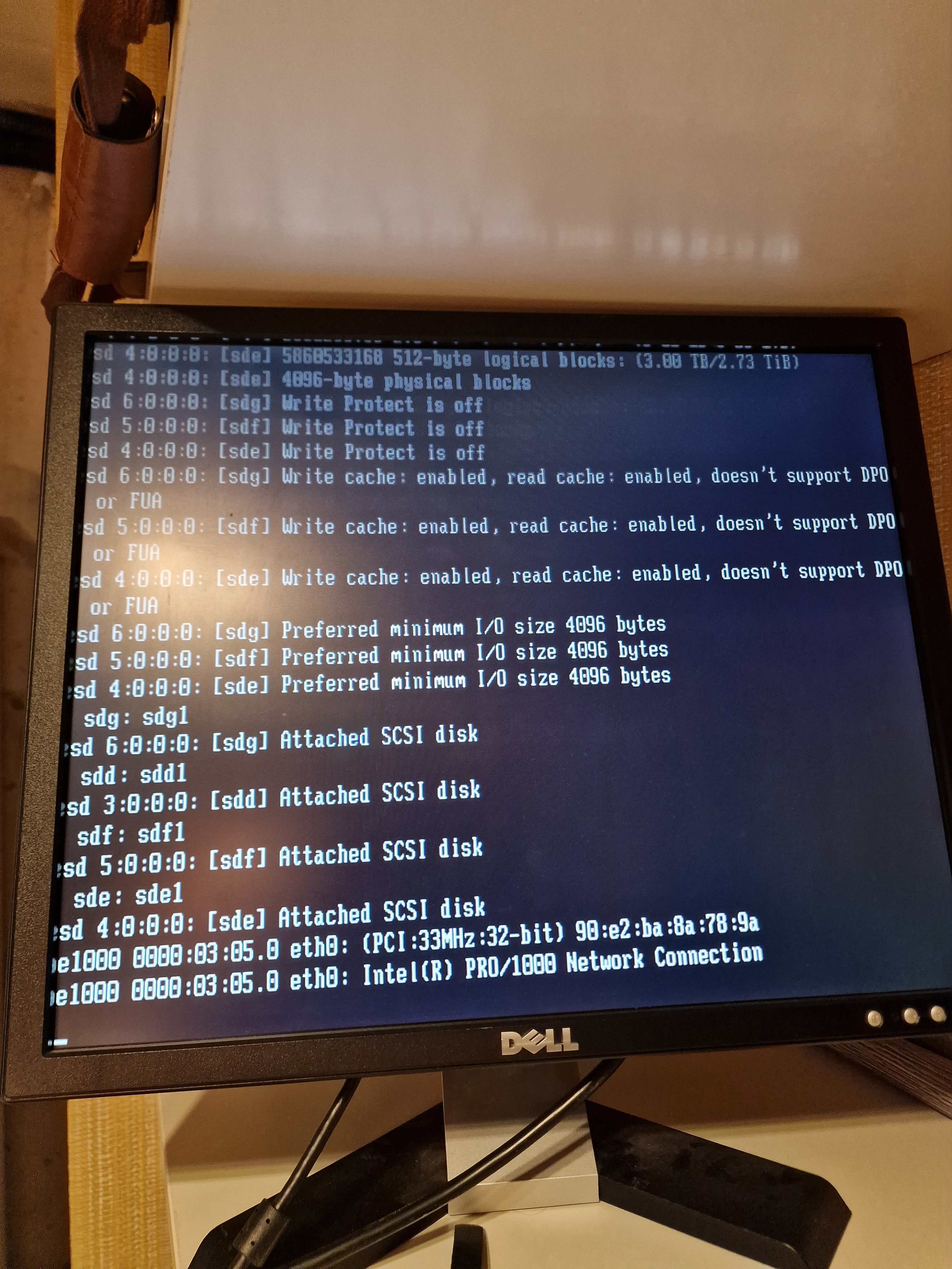

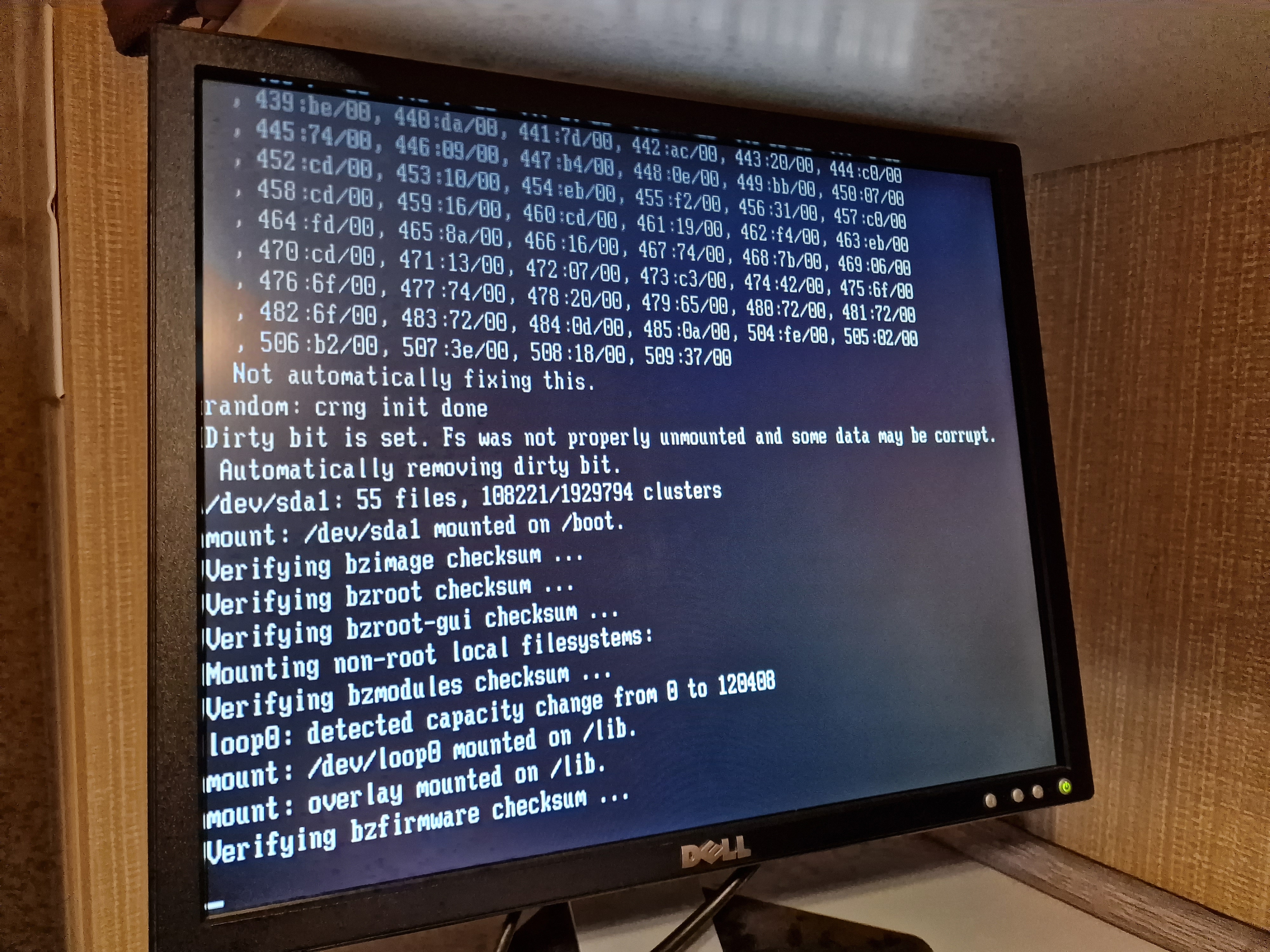

June 29, 20233 yr Author I still end up in a bootloop with a different model of Flash Drive, and a fresh clean install using the USB creator tool. Verifying bzfirmware checksum and gets stuck for a while (attaching picture) the after like 30s proceeds to scroll to bunch of stuff (attaching picture) and then reboots. Double checked the boot order in the UEFI Bios menu and it's set to boot priority USB Flash Drive. It's also set to Legacy+UEFI. (Attaching picture). There seems to be a error if you check the first picture with something being corrupt. Any ideas? Strange that a system that ran Unraid flawlessly that I've not touched or change anything is now having trouble booting up Unraid. Edited June 29, 20233 yr by Husramash
June 29, 20233 yr Community Expert That's a different error, but if you have another PC available try to boot there to validate the flash drive is OK.
June 29, 20233 yr Author I can confirm that the flash drive works when trying to boot from it on another PC. The same screenshots that I provided in the last post happens and then it continues to start the server. I can then access the server from Web GUI as usual. Please advice? Why is this happening? Everything is identical in the boot up process but in my server after the verifying the bzfirmware, then it scrolls fast the lines I could take photo of and then reboots.
