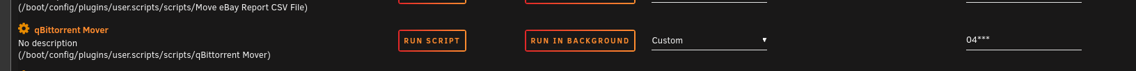

the next thing to try and tidy is what is causing the invalid entry in the syslog of the form:
Jul 18 17:16:11 Bearcave crond[1173]: failed parsing crontab for user root: 04*** /usr/local/emhttp/plugins/user.scripts/startCustom.php /boot/config/plugins/user.scripts/scripts/qBittorrent Mover/script > /dev/null 2>&1
To resolve this I would suggest you go into the console level and then post the output of running:
cat /etc/cron.d/root
and hopefully identify what has inserted the problem entries.
i know this is not solving your current problem, but by getting these little things out of the way hopefully we have a cleaner syslog to help with diagnosing the main problem.
2 minutes ago, OsoPolar said:
Ok - that shows the invalid entry seems to be a User Script called 'qBittorrent Mover'.   The fields at the start of the entry are meant to be space separated but the spaces seem to be absent.   Not sure if this is a custom schedule you created or not?
To get back to you original problem I do not see any obvious reason for you having issues at the moment, but having tidied up these 2 issues it might be worth rebooting to give you a cleaner starting position.

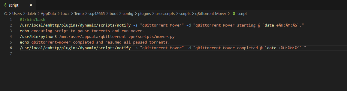

HI confused what you mean this is the file
I used Trash guide from here
Edited by OsoPolar
It is not the script that is the problem - it is the information about when it should be run.
Hi
Please can you help me understand i followed the guide what do need to change ?
There needs to be spaces between the characters of the schedule.
OK
