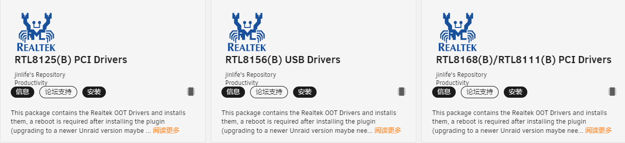

[Plugin] Realtek R8125 R8126 R8168 and R8152\6\7 drivers
Here is the support thread for the Realtek R8125, R8126, R8168\R8111 and R8152\6\7 drivers plugins.
If you have any questions, please ask in this thread.
Thanks to @ich777, we can bring this plugin to the community. It is fully open source and free.
The repo is: https://github.com/jinlife/unraid-r8125-r8152-driver

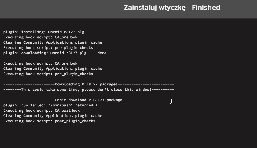

    I've put together a new build for the r8127 driver using GitHub Actions! You can install it manually through the Plugins tab. Installation URL: https://raw.githubusercontent.com/ERSTT/unraid-r8127-

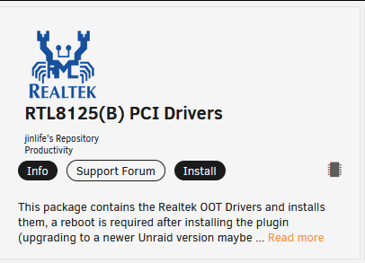

These are now available within the Apps tab.
However, if you installed them manually before they were available, I would suggest to uninstall and then reinstall via Apps.  An issue with the plugins if installed prior would prevent them from finding out and installing if an update was available...

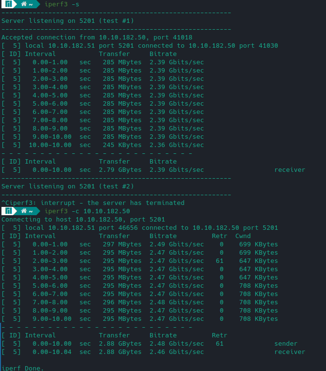

Please do a single stream iperf test in both directions, with this driver and the stock one.
Here are the results of the iperf tests with the driver installed.
I neglected to test before reinstalling the driver.
Driver is installed now, I get line speed in both directions with mine, with both this and the stock driver, so other things may be involved.
