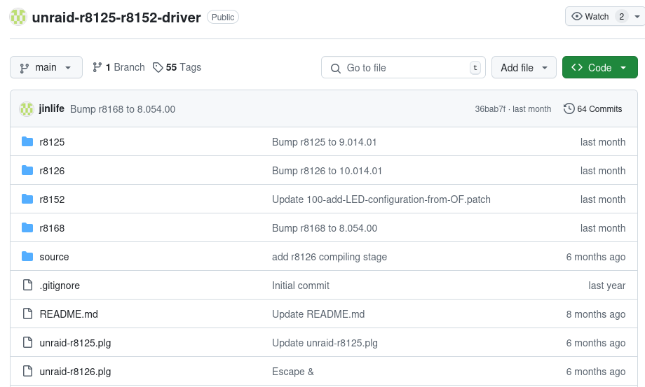

I use your driver-plugin (that's what i mean with package) with my latest 6.12.14 unraid and a Realtek 8125 interface.
Your plugin version 2024.04.04 based on driver version 9.013.02.
On the linked website there is mentioned a new driver version  9.014.01 (2024/11/06). That's the reason i asked for an update of the plugin.
Edited by bluebean
The plugin version is not bound to the driver version, even if the plugin version is behind years the packages will be up to date.

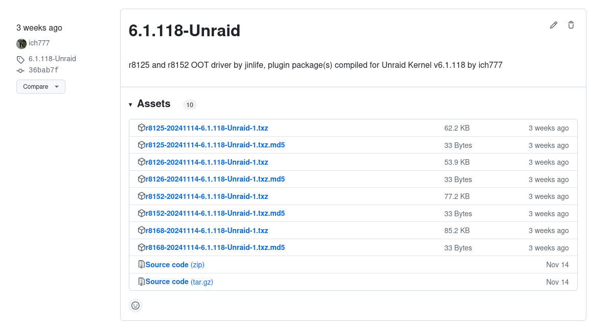

However what I can see is that I compiled the packages for 6.12.14 about 3 weeks ago:
...and @jinlife updated the repo about 4 weeks ago, so the packages should be up to date as you can see in the date from the assets, so to speak 2024-11-14, therefore all packages/drivers are up to date and in sync with @jinlife's repo:

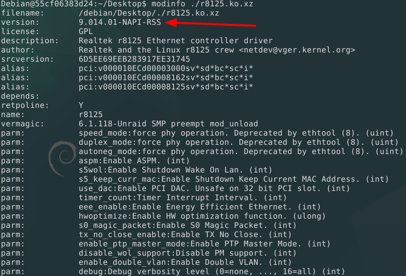

EDIT: If I download the package and run a modinfo on that module (I have to do this because I don't have the plugin installed) then I get of course version 9.014.01:

8 minutes ago, bluebean said:
I wonder why in my unraid the version 2024.04.04 is shown as "latest".
As said above the plugin version is not the driver package version.
The plugin version is indeed 2024.04.04 however the plugin just pulls the driver packages from the releases section from GitHub and installs the drivers on boot for your current running Unraid version.
If you upgrade your Unraid version the plugin (or the Plugin Update Helper) will pull the new driver package from GitHub, the plugin version stays untouched.
You can browser all releases from the driver packages here:
https://github.com/jinlife/unraid-r8125-r8152-driver/releases
6.12.14 is based on Kernel 6.1.118 so to speak this exact release:
https://github.com/jinlife/unraid-r8125-r8152-driver/releases/tag/6.1.118-Unraid
You can also do this from a Unraid terminal and you will see the driver version:
modinfo r8125
Ah, cool - thank you again. In my case there is shown 9.014.01, indeed :)
