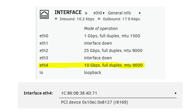

I just got RTL8127 , SFP+ version which is 8127AF chip or something like that. Settings, Network, Interface Rules lists it as "R8169" (confirmed by matching MAC address), but Tools, System Devices, lists "RTL8127 10Gbe Controller (rev08)." What did you do to get yours recognized properly?
7.3.0 rc1. Also going to Tools, System Drivers, if I search for "8127" - no results found. Note - I don't have any custom drivers installed, as I was told 8127 should be supported in kernel on 7.3 (it seems that way).
Nothing, it works out of the box, but mine is 8127A, not sure if the AF version is also supported, you can post the diags to take a look, but it's better to do it in a new general support thread, since it's unrelated to the plugin.
I will do that, but does your driver page show package for 8127? Mine doesn't:
I'm using the upstream Realtek driver; it's stock with Unraid 7.3
I apologize, I don't know what this is referring to. The screenshot I shared above is from brand new 7.3 rc1 installed this morning on a clean USB drive. Did not install anything custom on this instance. Are you suggesting that the driver your system uses will not show up in the System Drivers list?
Edited by OrdinaryButt
I misread the screenshot, thought it was from the plugin. The stock driver that NIC uses is r8169, not rtl8169
so r8169 (which is what my adapter shows up as I said in my first comment today) is what is being used for 8127 10g adapters?
Correct:

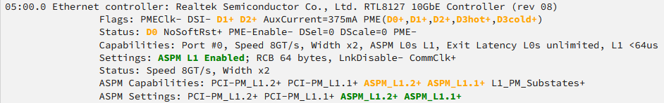

On 8/29/2025 at 5:50 PM, JayDee73 said:
Another question: Did you try any iperf performance tests with this setup? I had the issue that as soon as I added the mentioned conf file, performance dramatically went down from 2.5G to about 250Mbit. At least in one direction and with 7.1 version. After weighing performance and power consumption, I decided to stick with the performance (so no conf file), but with activated powertop which at least brought me to C3 states.
But maybe things have improved with 7.2, which would be great news.
I have the exact same issue, but with an Intel i226-v.
Have to add the following to the /boot/config/go file (also where my other powertop tweaks are):
# disable ASPM for I226-V, when this is enabled the network speed drops often to <300 MB/s (instead of full performance of 2500 MB/s)
# with this workaround the system can reach c-state c3 (~15,8 Watt) and have full ethernet performance
echo 0 > /sys/bus/pci/devices/0000:01:00.0/link/l1_aspm
to get it stable at 2,5 GBE, sure not reaching lower c states than C3. Where ASPM is enabled for the card my system reaches C6, but with the exact same performance drop to about 250-300 Mbit/s (tested with iperf3).
First few tests it reaches 2,5 GBE, but after a short idle time it has that drop issue
Also tested a few years back an i226-T1 geniue Intel card and an rtl8125b which has exactly the issue. Sure my Mobo bios (Gigabyte H610i) is up to date
So I will not test an rtl8125b card again, because than I have to also deal with drivers on every unRAID upgrade.
Also updated my NVM flash of my Intel card (there is an open sense forum thread for that) without success.
I am on newest unRAID 7.3.0-rc1 now, because of internal boot, which is on 6.18.23 now. Maybe test aspm again, but my hopes are low after all this year's without an working 2,5 GBE nic + proper ASPM support.
Hope this will ever be fixed.

Just a quick update:
i enabled aspm for the i226-v (commenting out the code from my previous post in /boot/config/go) on newest unRAID 7.3.0-rc1 (which is on kernel 6.18.23).
Confirming aspm enabled/disabled state with lspci (before and after) -> it was disabled before and is now enabled for the card.
After spinning down all hdds and let it idling i am reaching C6 now and the network speed has not dropped on 10x iperf tests.
Will test further and hoping the aspm issue is gone.
If not will test also the suggestion of disabling just L1.1 L_1.2: https://forums.unraid.net/topic/141349-plugin-realtek-r8125-r8126-r8168-and-r815267-drivers/page/17/#findComment-1605492
Edited by pOpYRaid
Finally!!!!!!!!!!!!!!!!!!!!!!!!!!!!
The i226-v driver bug i am reffering to in my last posts (performance loss when ASPM is on) is fixed in unraid 7.3.0-rc1 (kernel 6.18.23).
Here is the commit which fixed the issue: https://git.kernel.org/pub/scm/linux/kernel/git/torvalds/linux.git/commit/?id=0325143b59c6c6d79987afc57d2456e7a20d13b7
Basically disabling aspm L1.2, preventing the performance issue with minimal higher power consumption.
So with this commit i can recommend the Intel i226-v for low power unraid builds and have ASPM with no performance loss working.
The c-states rabbit hole has become smaller for me 😁

The unraid-r8127.plg installed fine for me and the card works, though I haven't done any further tests yet.
To activate ASPM, add this as Modprobe config to the driver under Tools -> System Drivers:
options r8127 aspm=1
Result in AutoTweak:
