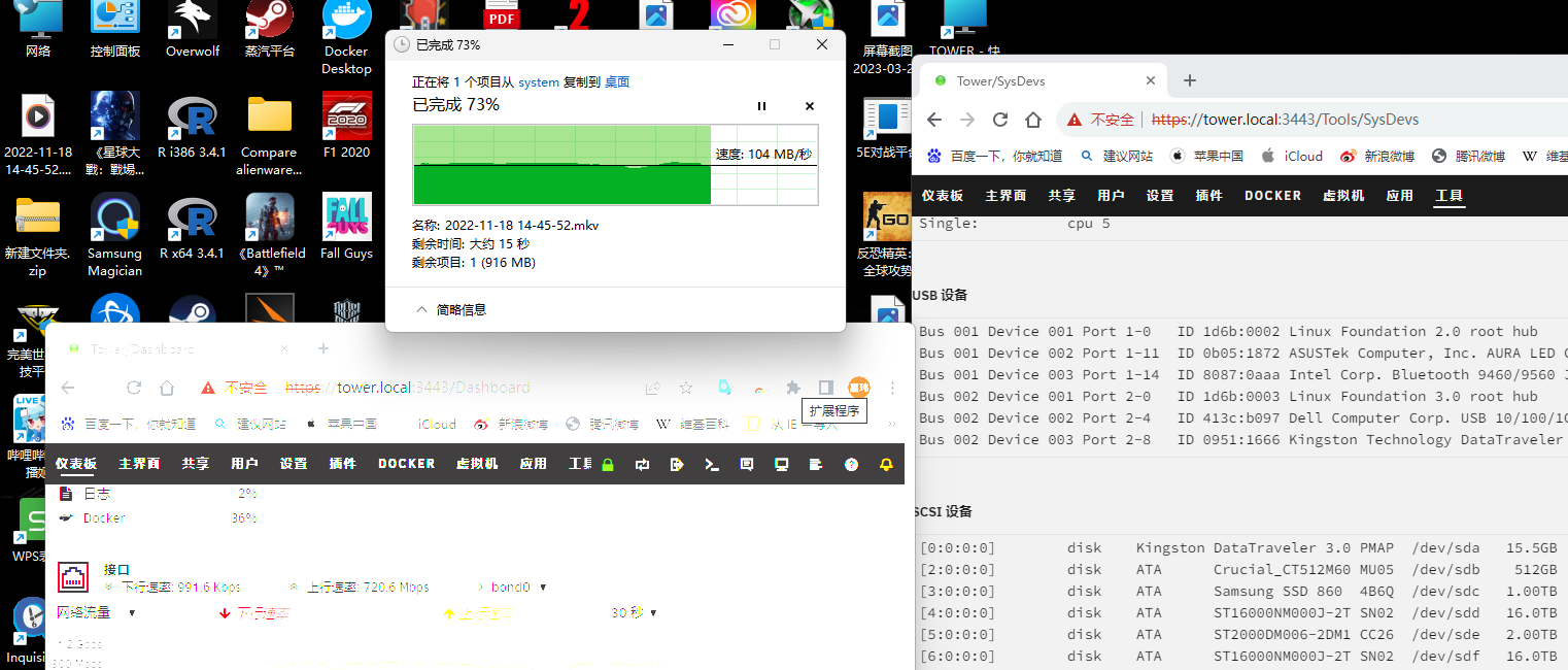

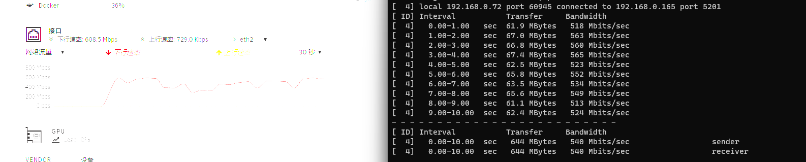

Kind do not know how to do it but, I got you few screenshots, since I was using wifi so there is a little bit slow. But is works fine.
171001884_2023-09-11214533.thumb.png.25b31811bc8e64bd25298e642dbbd47b.png1642778824_2023-09-11214814.png.820a6fc02d81c4b50f08ef82e7926526.pngimage.png.509418beaf3b5862eda659405659251c.png1207083984_2023-09-11212925.thumb.png.8758bbd0819843bb4b36b6eb678debfb.png
Thanks for the update. It looks stable for file transfer. We will add it to the plugin.

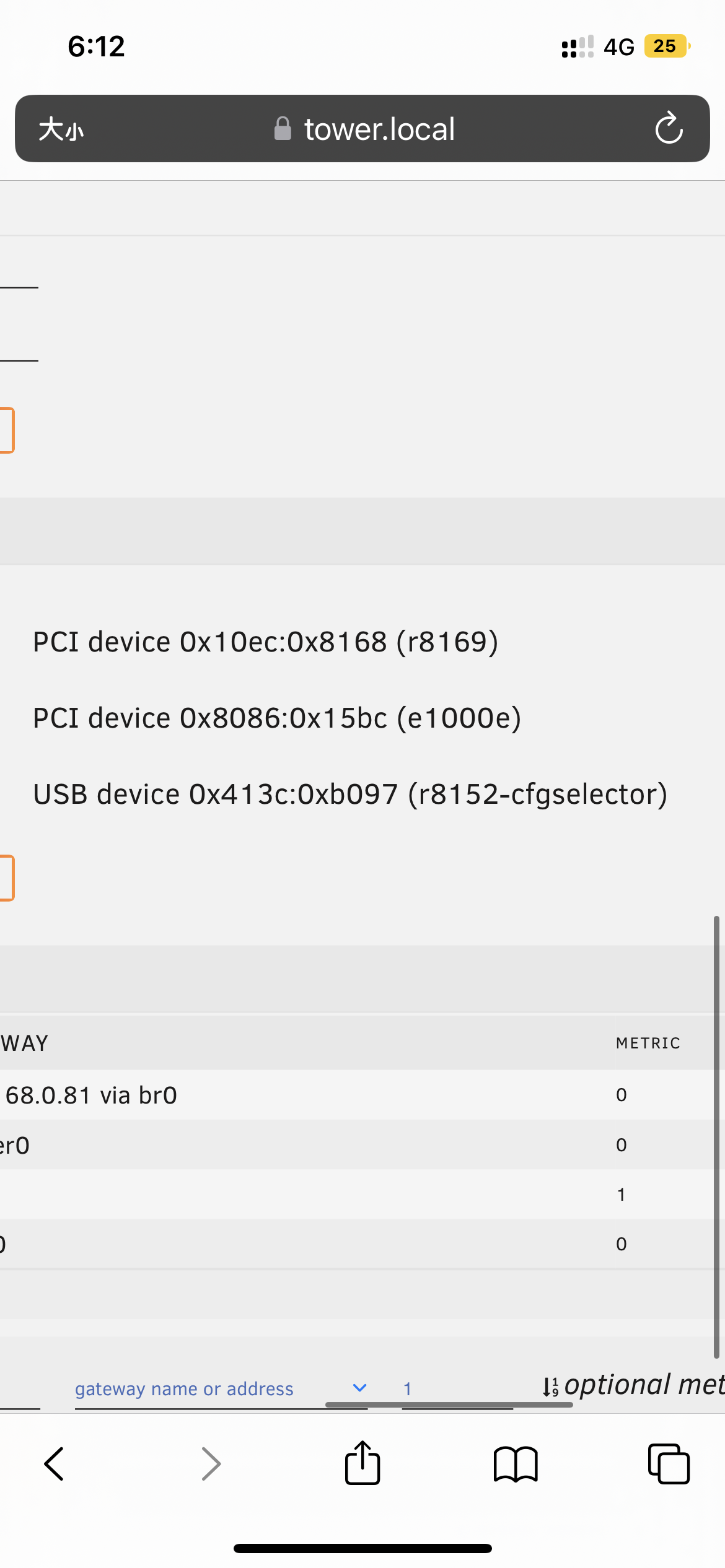

just wanted to say thanks for this.  picked up an [asus 2.5gbe USB](https://www.microcenter.com/product/636588/asus-usb-c2500-25g-ethernet-usb-adapter-supports-wired-network-connection-mac-os,-linux,-windows,-backward-compatible-on-1g-100mbps,-ideal-for-gaming). It has the 8152 chip.
Works after I installed the 8156 app... don't know if you want to label your app 8152/8156, or update the readme... i had to dig your github to see it was package to install.
thanks again!
  • jinlife changed the title to [Plugin] Realtek R8125 R8168 and R8152\6 drivers
thanks again!
Hi, the R8152 and R8156 were same driver, I think you can install the r8156 plugin to support both. r8152 is actually older network card while R8156 is 2.5G.
Edited by jinlife

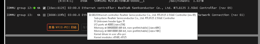

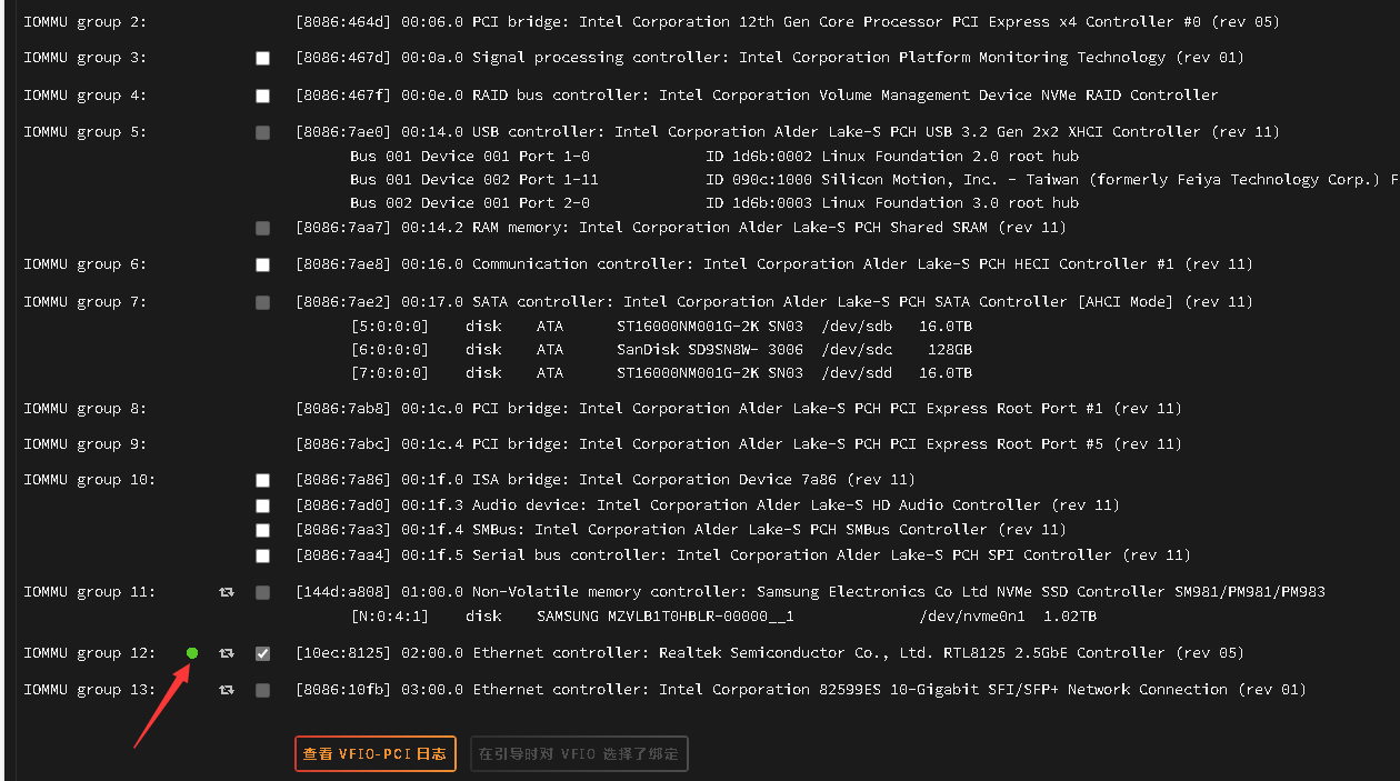

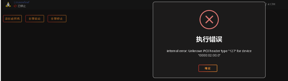

版本6.11.5报告错误,请您看看原因
22 hours ago, qq123456 said:
版本6.11.5报告错误,请您看看原因
看起来还在用 r8169,似乎没有用到我这的plugin啊。我在另外一个帖子里面回了,这不是驱动的问题,是虚拟机和直通配置的问题。
