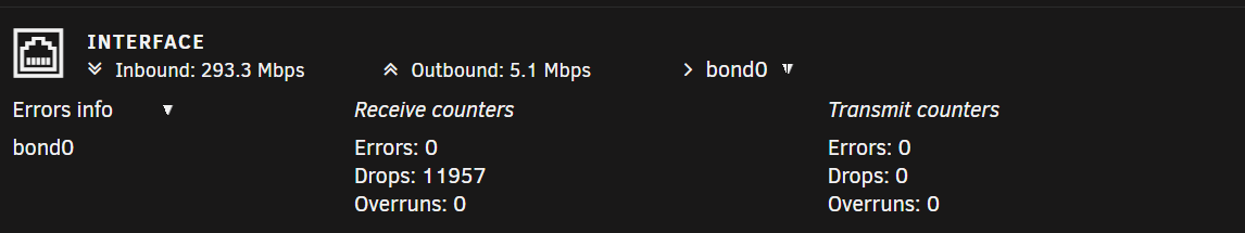

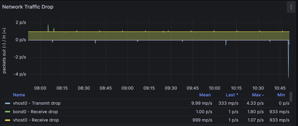

i have found "Realtek R8186 NIC found" in Fix Common Problems.
i have 2 nics and had no issues , only macvlan but as it fixed in latest version in Unraid , no problem anymore .
So goes back to bond0 and found every second packet drops on bond0 and vhost0.
tryed only eth0 from bond0 but still have drops...
should i install "RTL8168(B)/RTL8111(B) PCI Drivers" plugin to fix it ?

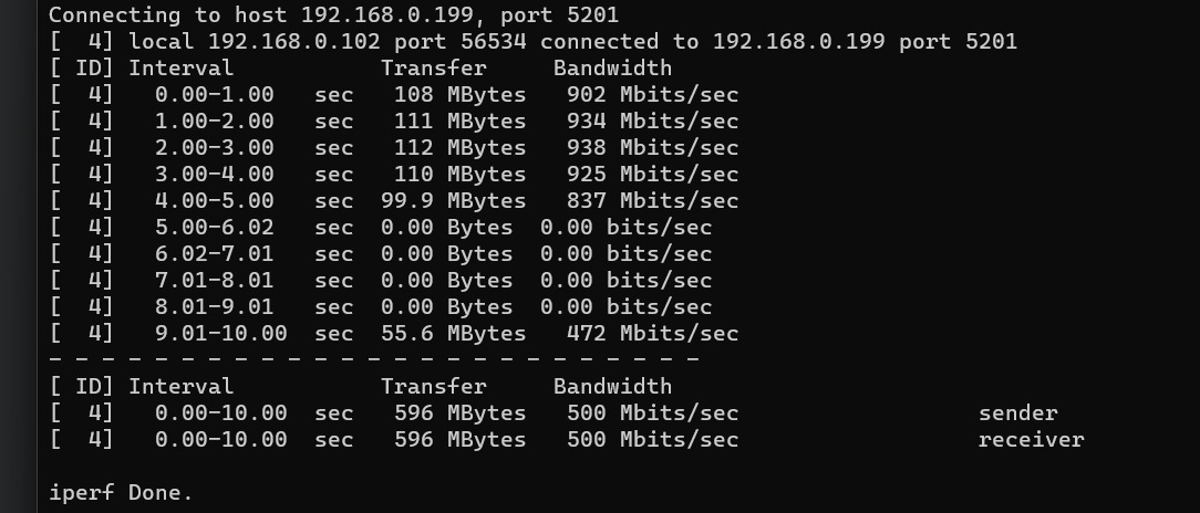

Also iperf speed issue :
I have the exact same question for the exact same reason.
I'm also seeing this on a RTL8111 running 6.12.6
@jcmorris @invik
I installed the driver but nothing changed, so uninstalled it.
Also I think it's kind of issue of vhost0 maybe on latest version of Unraid, becose it wasn't befor some versions back.
Can you check, maybe change cables
 and maybe without bond0, I tryed but
This not helped.
Unraid 6.12.6
Edited by Masterwishx

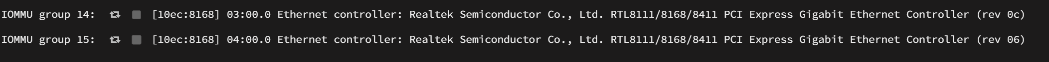

I have a Realtek R8186 NIC and the Fix Common Problems app listed this as a warning for me. I assume it doesn't apply, correct?
  • Tools -> System shows my onboard motherboard NIC driver as "Realtek Semiconductor Co., Ltd. RTL8111/8168/8411 PCI Express Gigabit Ethernet Controller"
  • Fix Common Problems says "Realtek R8168 NIC found".
But nothing I'm reading says anything about 8411. So... do I install the 8111/8168 drivers, or not?
Thanks!
Edited by jeradc
Thanks!
The info for the RTL8168(B)/RTL8111(B) PCI Drivers plugin on the App store calls out 8411 too
