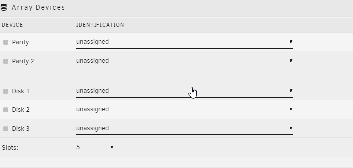

Hello I've been having issues with this harddrive for ages since I've tried adding it to my system. It would be replacing an old drive and nothing I do seems to work. If I try formatting it through normal methods it crashes with the following system logs.
While this is not my system the exact same problem happens whenever I try to add the drive.
lFK8WwzcOS.gif.2370a8bbabb96068b9d3e049705dcbca.gif.b9c676440d9f5c420271dd0415c769d4.gif

I've replaced the power supply, so now no more than 4 discs are attached to any individual psu cable. I'm still getting the same issue shown in the gif to start with where if I select it to replace a drive it disappears.
