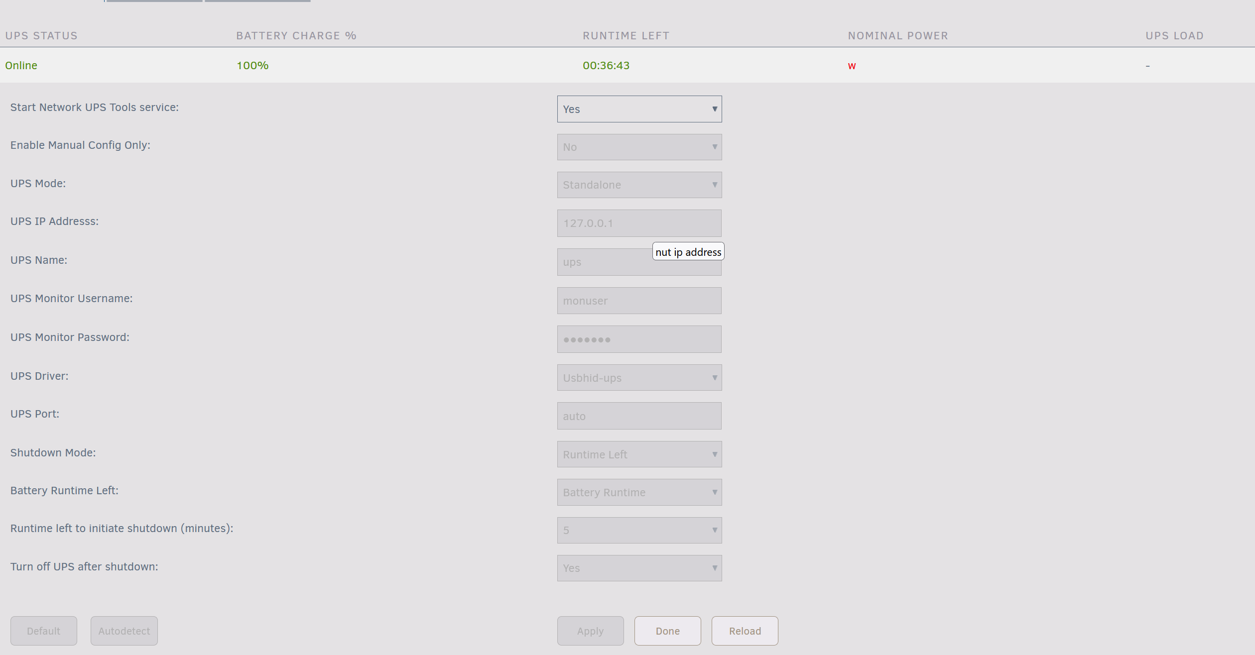

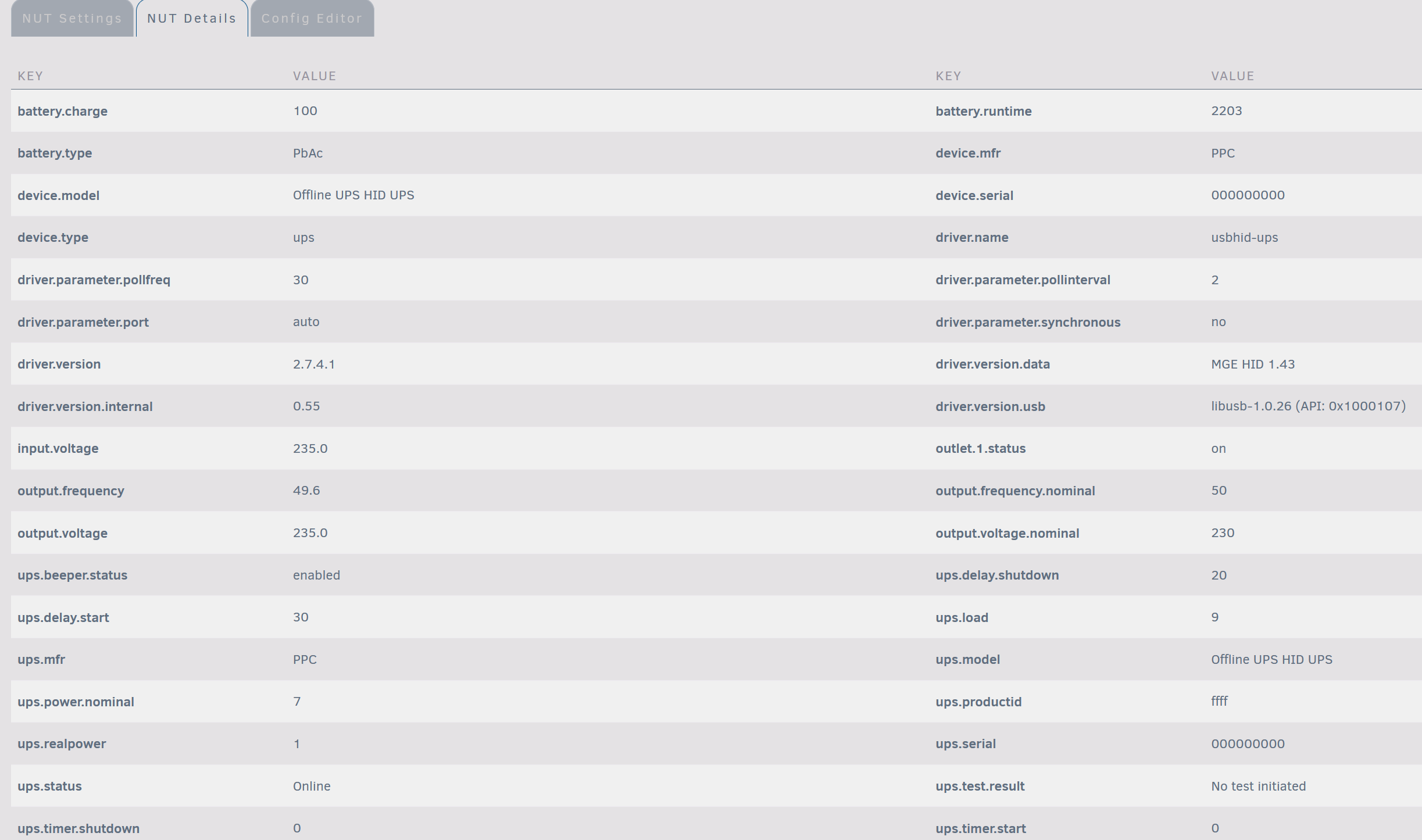

I have also Amazon Basics UPS, NUT works. Don't use autodetect, try these settings:
Should result into:
Thanks thats detected now moved the usb to another port too so will monitor it
Been a week and not seeing the issue again
