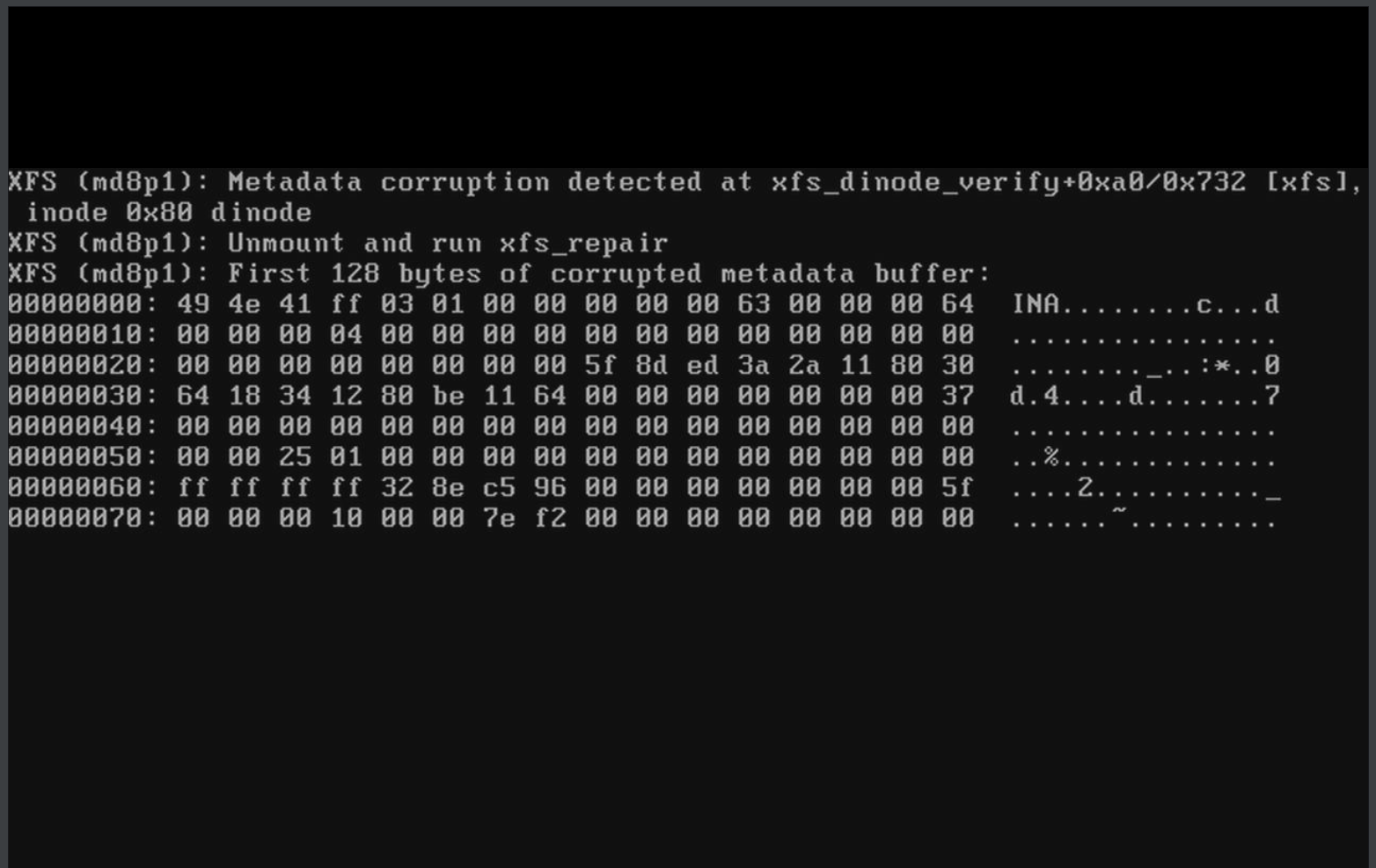

Cannot boot into unraid.
I cannot boot into unraid and all I can see is this screen.
The OS does not fully load so I cannot access the array from the gui.
What can I do to fix this?
Solved by JorgeB
That shows that you need to check filesystem on disk8, but by itself should not a reason for the GUI not coming up.

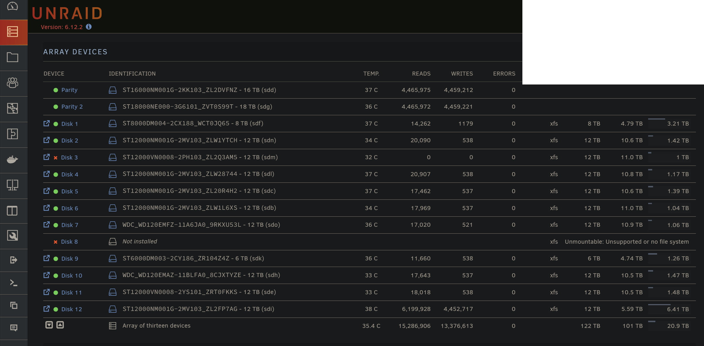

I am back in but it looks like a few disks have issues now.image.thumb.png.61d867e771b5f88822a82028ce3d8db2.png
tower-smart-20230705-1527.zip
Check filesystem for emulated disk8 and replace cables for the disk below, I assume it was disk8?

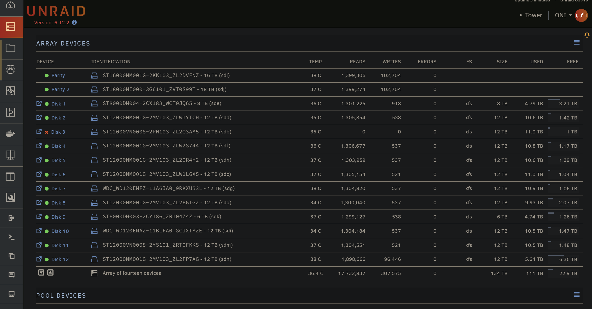

I did a fresh reboot and ran the diagnostics.
tower-diagnostics-20230707-1922.zip
Filesystem is not yet fixed and there are still issues with the disk, did you replace the cables?

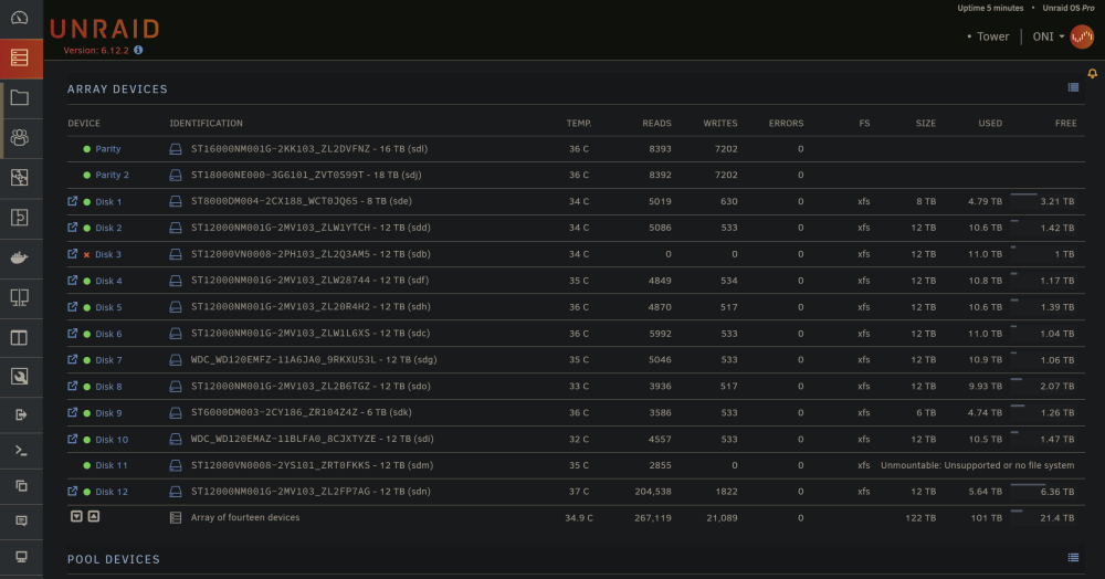

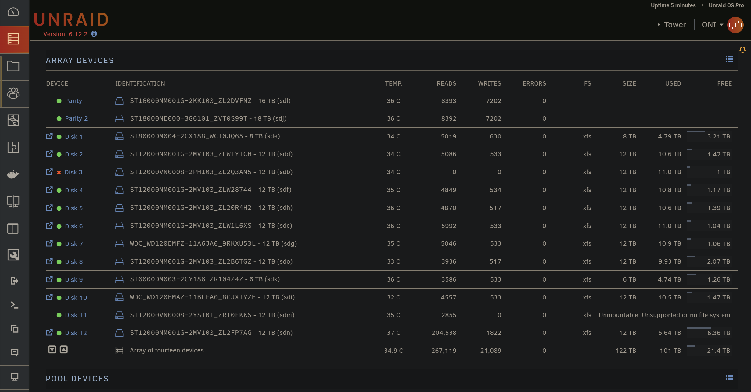

So I replaced the drive and had it rebuilt. It then showed as it had no file system so I did a repair on it. That resulted as the drive showing up and with a filesystem.
I ended up doing a repair on all drives and but my current issue is that drive 3 is still not showing up.
I have attached a fresh diag from the system and the affected drive.
tower-smart-20230713-1031.zip tower-diagnostics-20230713-1234.zip
