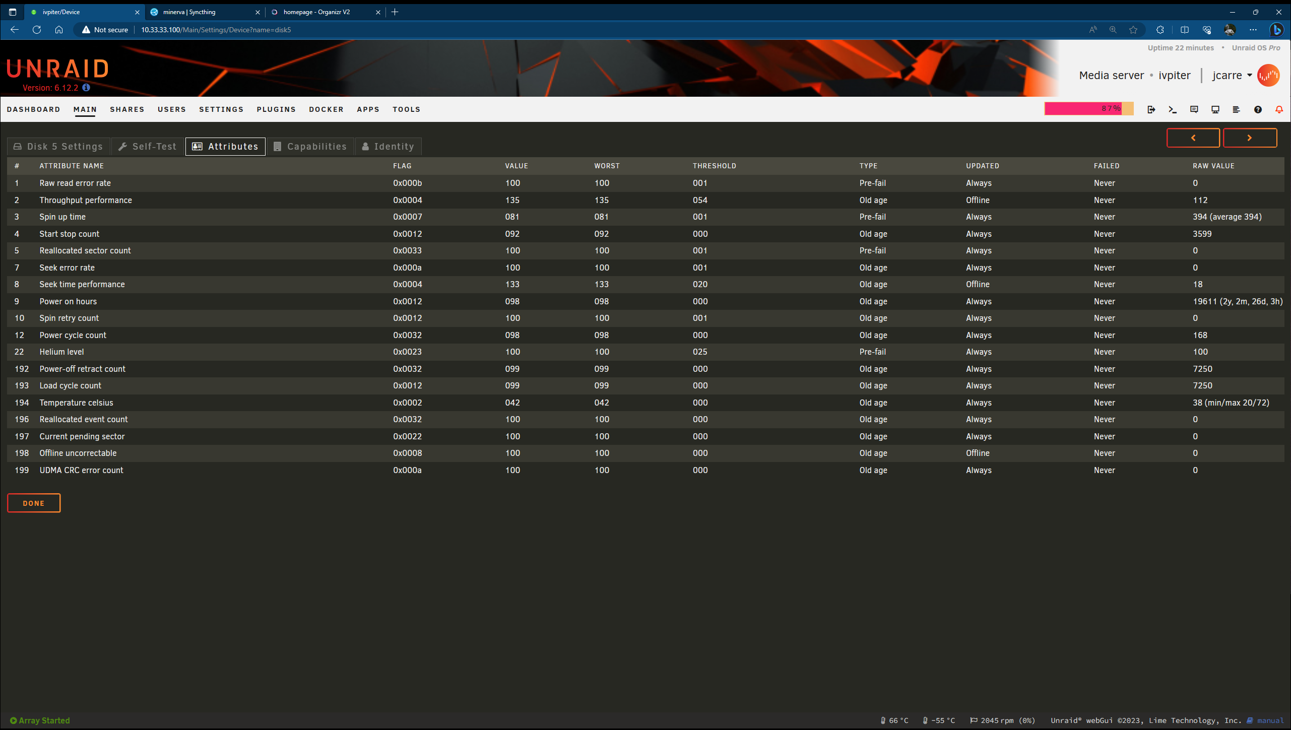

I did a short smart test and the disk turned out to be fine. Thinking that it might have been an error with the HBA (it's really hot right now), I cranked the fans up and started the a rebuild process with the same disk. The rebuild turned out fine and everything appeared to be ok.

Is my disk dead? Is it just writing fine but unable to read? What shall I do?

It's not logged as a disk problem and SMART looks fine, replace cables and try again.
