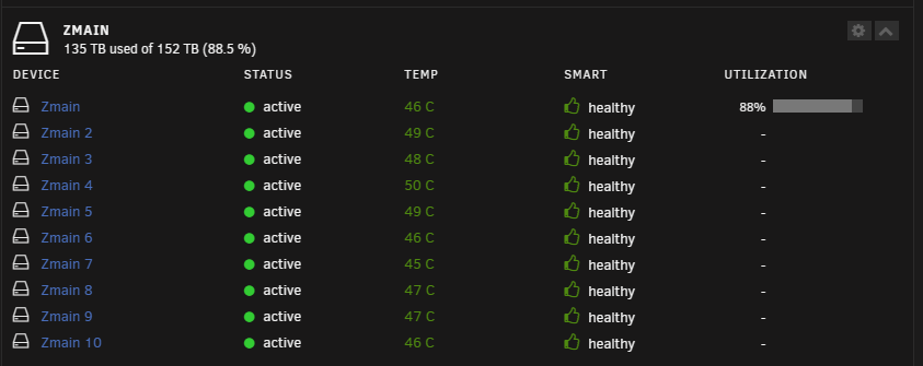

When my ZFS pool got to around 90% capacity, I started receiving the "[Errno 28] No space left on device" error when writing to my ZFS pool. I tried moving files off the pool, reducing the storage capacity to 88.5 %, yet this error persists. I later noticed the Minimum free space setting was set to 10%, which could explain the original error. However, I have since tried updating that setting to values less than 5%, but the No space left error persists. I'm not sure what could be the cause at this point.

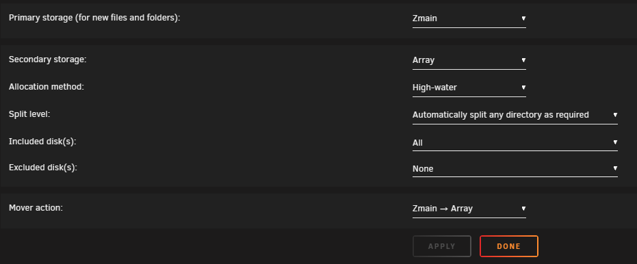

This pool is configured to my Array so that mover moves files from the ZFS pool into the Array. Here is a screenshot providing more info on my share configuration.

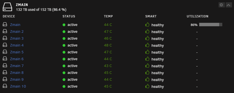

Keep in mind the ZFS pool is now at 86.4% capacity:

According to diags you are hitting the share floor, not the pool floor, to which share are you writing to?
The share is configured to use the zpool as the primary storage and the Unraid Array as the secondary storage. I did actually notice that even though the Zpool was configured to have a minimum free space of 5%, the share itself was somehow configured to have a minimum free space of 50%. I don't know if that setting was recently changed since my server has been well over 50% capacity for a while now. Reducing the value on the share setting did address this issue.

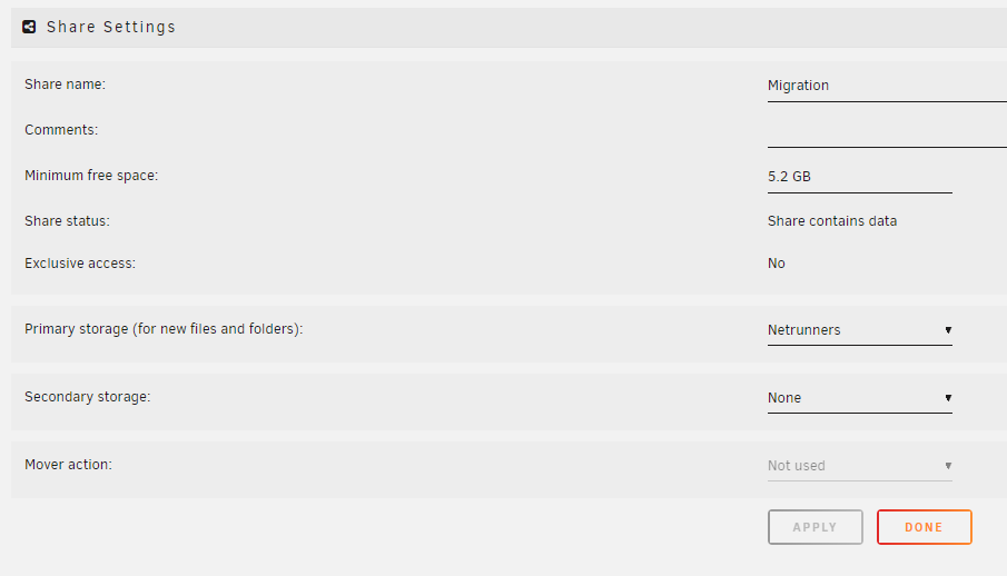

Having same issue, not enough space unless I transfer smaller batch and not the whole folder.
Also, the transfer (using Krusader) is re-creating the share's folders on the origin pool.
Origin: Rockerboys
Destination: Netrunners
Share Config:
Share Computed:
Edited by darkslyde
Updates
I, too can't replicate the problem now after a reboot.
