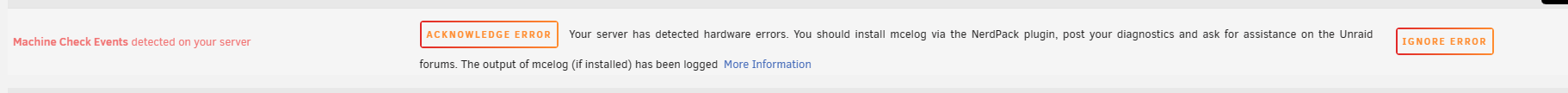

Your server has detected hardware errors
Hello, I just setup a new server and when i login to web interface, i saw this error.
the error said that my machine has hardware error. May i know which hardware is having error?
Attached is report of my diagnosis.

Is your ram overclocked? I had a similar issue awhile back and it was a problem with the OC ram.
I have changed my ram to low voltage ram and error is gone. I think the initial problem is more of motherboard and ram compatibility issue.

I've had some problems like that in the past where I got entirely different ram than what I had ordered or had to do some type of tinkering to get it to work with the current system. Glad you got it figured out and I'll try to keep my eye here if anything else comes back up.
