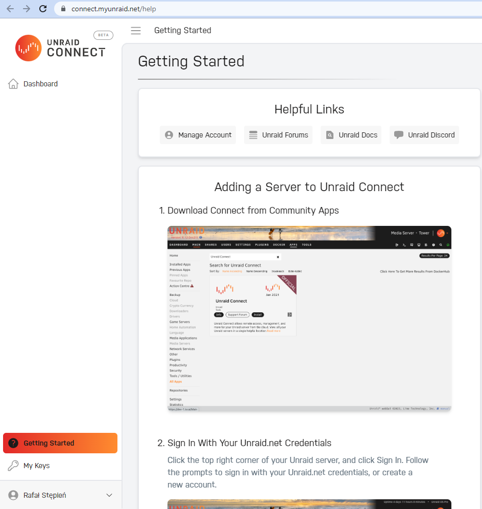

When I login I see this screen.
Did sign in using the Connect plugin on the server?
But my Unraid system can't boot. As I said I'm not migrated from "My Servers" to "Unraid connect" (there where no messages/errors saying that I shuold do it), then I tried to update Unraid and after reboot system won't start because of the errors above.
You should be able to recreate the flash drive, with a stock Unraid install, boot Unraid, sign into Connect and see if the backup is there.
Thank You, it actually worked!
