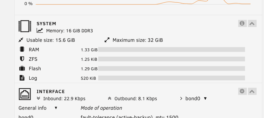

  • Bars showing usage in WebUI go grey and stop working

Would do, but like I say it hangs. As does doing an ls on /mnt
Doing a 1 level deep du against the log directory shows it isn’t full though, so I know that
See if you can check if /run is full
Sure. Seems unlikely looking at this though
