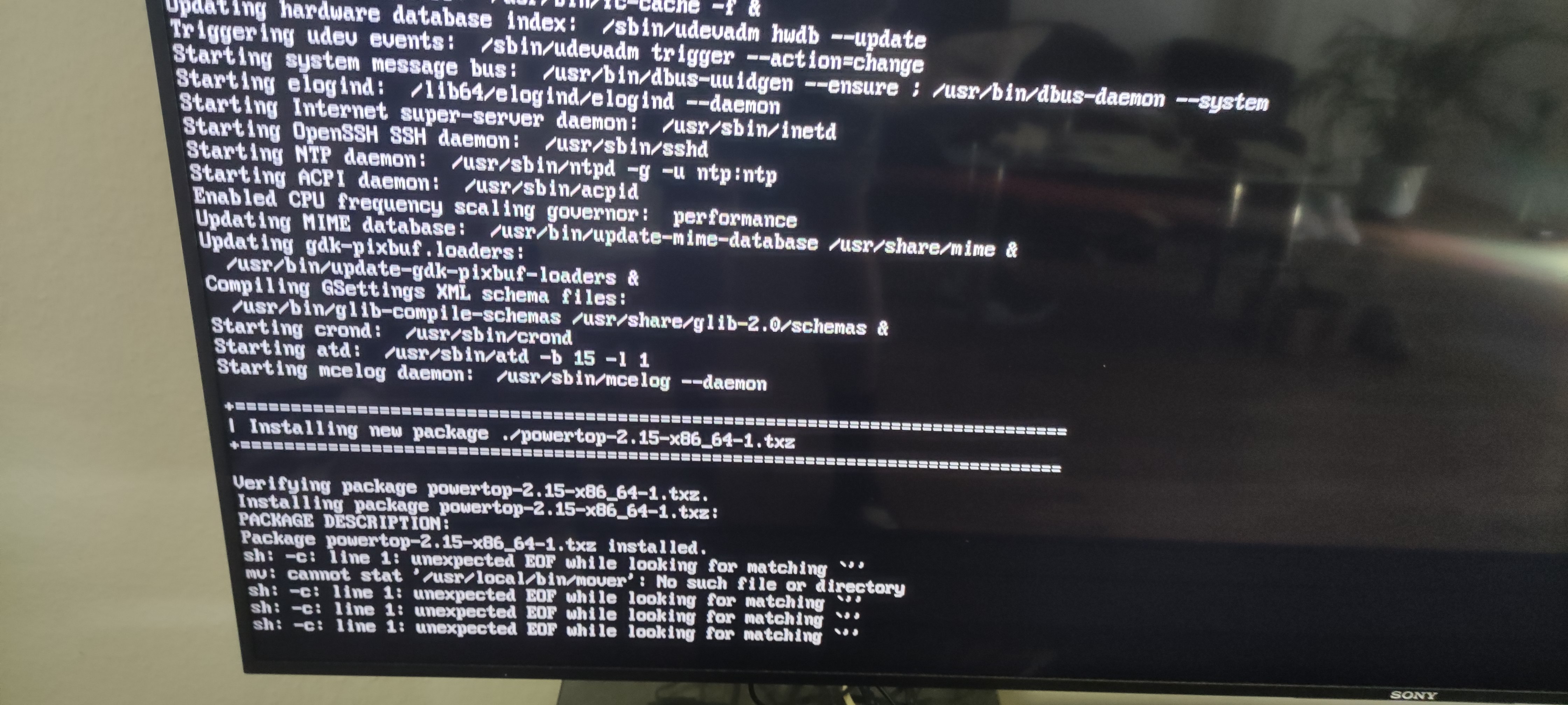

July 6, 20233 yr Today I wanted to update my plugins and right after that I got the message that my USB drive is corrupt and the GUI was broken. I shut down the server and tried to reboot. Now it hangs with failure messages. What can I do? Thank you.
July 6, 20233 yr Community Expert Start by removing any packages on the /extras folder if any exists.

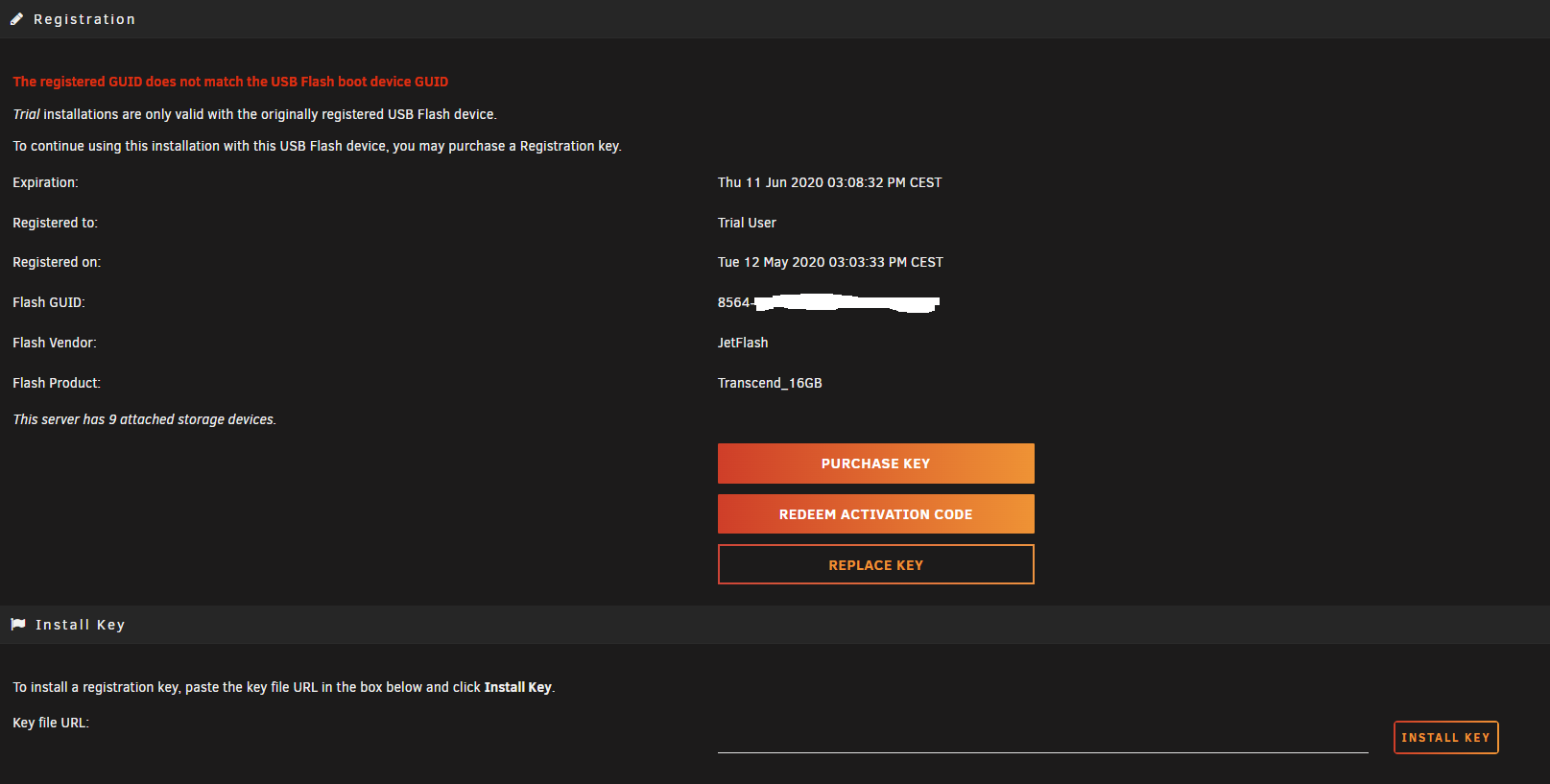

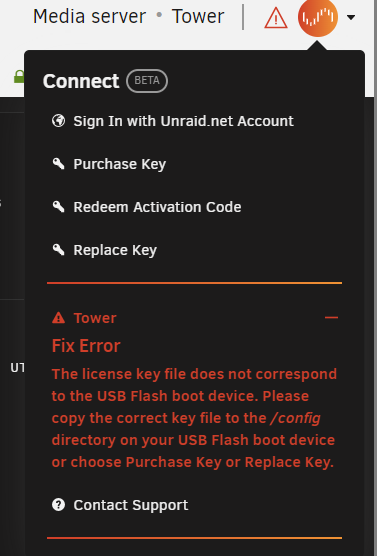

July 6, 20233 yr Author Finally the server booted after a long time. Now I got the message that the licence file does not match the USB drive. Something is really strange there.. Edited July 6, 20233 yr by Civic1201
July 6, 20233 yr Community Expert Do you see the same error on Tools -> Registration? If yes please post the diags.
July 6, 20233 yr Author Yes same error in "Registration". Diag attached. edit: Just received this warning email from server: tower-diagnostics-20230706-1914.zip Edited July 6, 20233 yr by Civic1201
July 6, 20233 yr Community Expert Jul 6 17:42:40 Tower kernel: FAT-fs (sdb1): Directory bread(block 31226) failed You are having flash drive issues, try copying the complete /config folder, recreating the flash drive and restore it, if issues continue you will need to replace it.

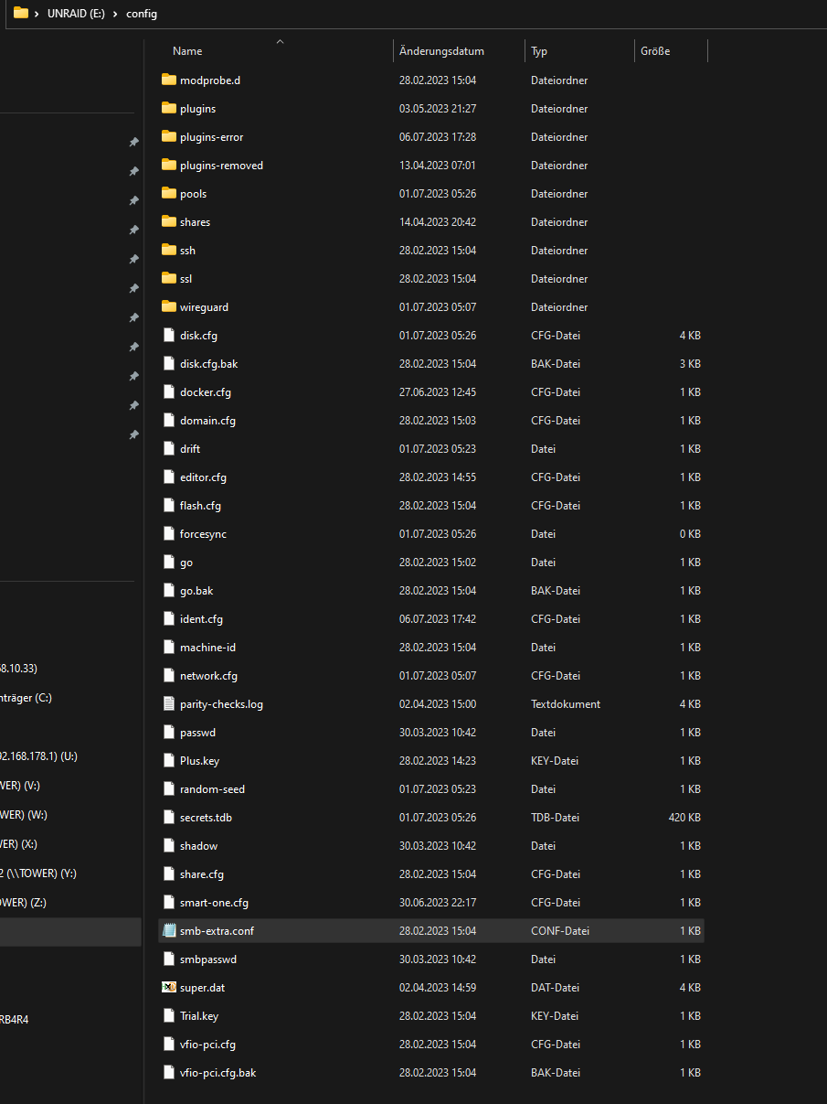

July 6, 20233 yr Community Expert Yes, as mentioned first try with the same flash drive, if issues continue after recreating replace it.
July 6, 20233 yr Author Ok USB drive is plugged into my PC and I can open the /config folder. But when I try to copy it nothing happens Edited July 6, 20233 yr by Civic1201
July 7, 20233 yr Author Solution Problem solved USB drive was not readable anymore so I used the backup from UnraidConnect and flashed it to the same drive -> server is running again! Another drive is on the way if the old one has problems again. So guys never forget you backups
