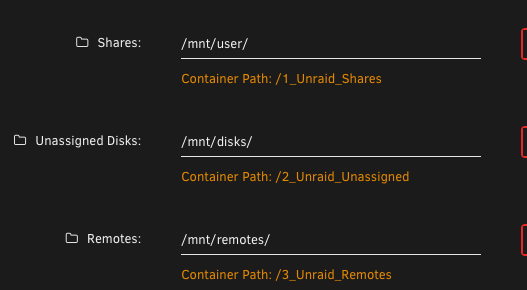

I did what @JorgeB said and it looks like I found the 2 (!) Containers which cause the problem.
- Krusader
- Synology DSM
If those containers are stopped, the array is able to stop, too.
Synology is not really necessary for me anymore but I´m using Krusader sometimes. I will try to reinstall Krusader and check if that will help.
It could be the container mappings.
Yes, that will absolutely be the problem - the mappings in krusader are:
I watched a video as I installed Krusader where these mappings were suggested.
Back again.
