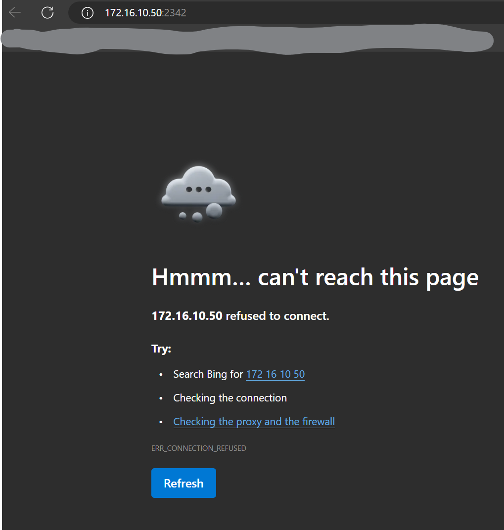

Here is what I see. It "refused" to connect, which tells me it is responding but won't serve any web traffic:

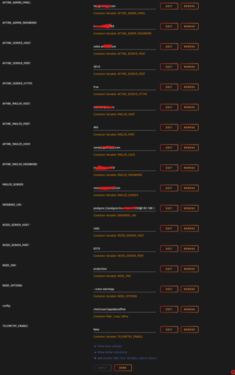

Hello I got the application running but when I try to log in with the email from the AFFINE_ADMIN_EMAIL variable and the password from AFFINE_ADMIN_PASSWORD I got only an error message:
Failed to send email. Please try again.
Howdy, I literally just heard about this app this weekend and got it running. I haven't figured out login in yet but I do remember seeing there are issues with connecting the self-hosted version to the desktop app and such. I will look into this but it may be a while until I can provide a definitive answer.
The Affine login doenst work. Tried everything, no deal. Anyway to fix it?
Edited by Delscipio

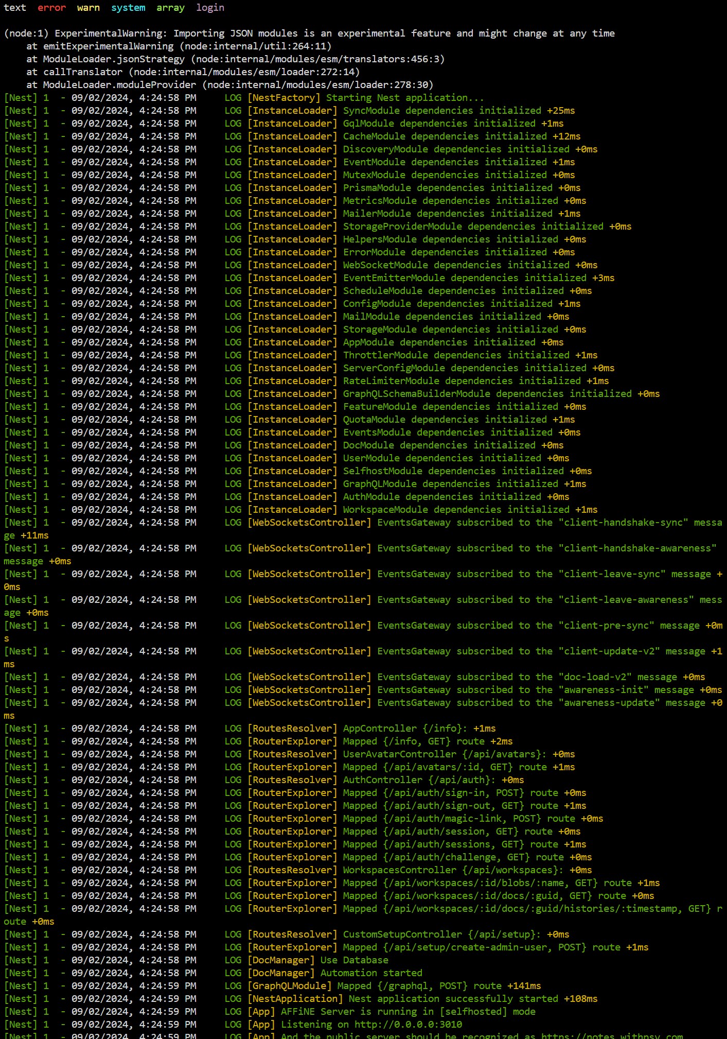

I've managed to get the program running with the mailer configured correctly and reached the login screen. When I enter the email address specified in AFFiNE_ADMIN_EMAIL, I receive an email with a link to create an account instead of logging in. Also, when I click the link, it opens a new browser tab with the URL http://localhost:3010/magic-link..., and I encounter the following error in the logs:
[Nest] 1  - 08/13/2024, 4:29:17 PM   ERROR [HTTP] Internal server error
PrismaClientKnownRequestError:
Invalid `prisma.user.create()` invocation:
An operation failed because it depends on one or more records that were required but not found. No 'Feature' record(s) (needed to inline the relation on 'UserFeature' record(s)) was found for a nested connect on one-to-many relation 'FeatureToUserFeature'.
    at _n.handleRequestError (/app/node_modules/@prisma/client/runtime/library.js:121:7749)
    at _n.handleAndLogRequestError (/app/node_modules/@prisma/client/runtime/library.js:121:7057)
    at _n.request (/app/node_modules/@prisma/client/runtime/library.js:121:6741)
    at async l (/app/node_modules/@prisma/client/runtime/library.js:130:9355)
    at async AuthController.magicLinkSignIn (file:///app/dist/core/auth/controller.js:102:22)

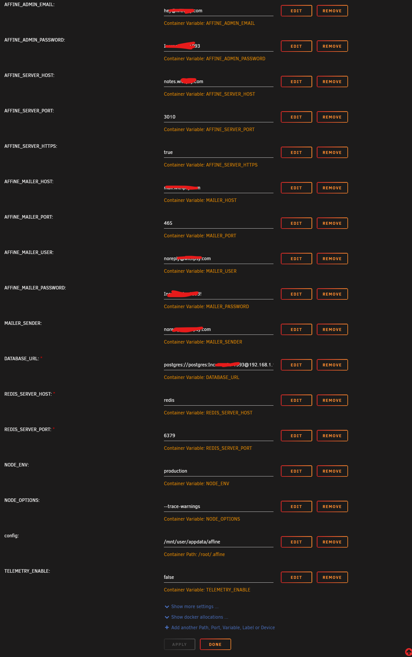

For those interested in how I got the mailer working, here’s what I did:
Edited the Docker container and added the following four variables:
Key: MAILER_HOST
Value: [Your Email SMTP Server]
Key: MAILER_PORT
Value: [Your SMTP Port]
Key: MAILER_USER
Value: [Your Email Address]
Key: MAILER_PASSWORD
Value: [Your Email Password]
This setup allows the mailer to function correctly, sending emails as expected.
You may need to setup an App Password if you're using outlook or Gmail.
Yes, that's as far as I've gotten. I'll keep looking into it and I'll add the environment variables in the template.

For me is not working!
image.thumb.png.1ca8148daa8deff1c5984aeb55f463c4.png image.thumb.png.8b71d663d044ceceacadda5546ae75f8.png

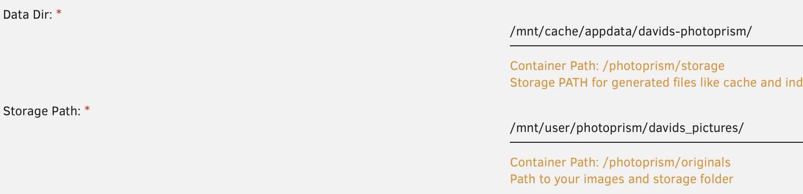

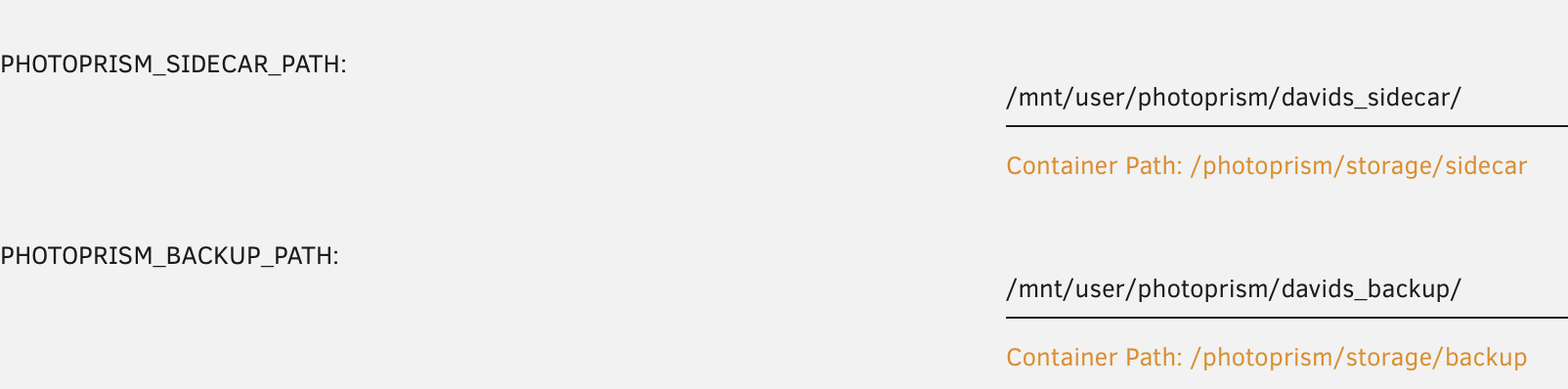

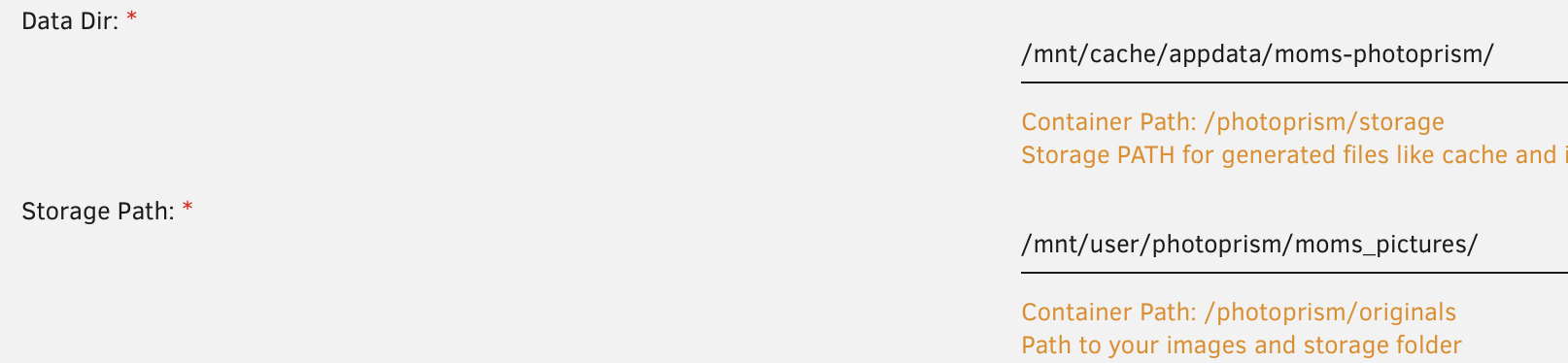

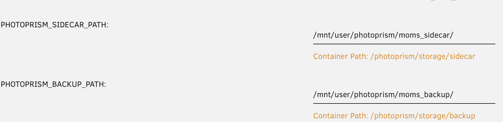

Hi, I have two instances of Photoprism running (one for me, one for my mom) and it was running fine for a long time but now that I started uploading more pictures, the previews or sidecar images (not sure at this point) are showing up as missing. All the previews start appearing with a broken image file - although the original image is still untouched. I ran a complete rescan on one library and it seemed like it fixed it but once I ran it on the other one, the first library started having the broken previews again. So far I think I have everything separated from each other from what I can tell but I may be wrong. Should I have had a separate path for PHOTOPRISM_ORIGINALS_PATH for the two instances?
I believe the variable PHOTOPRISM_ORIGINALS_PATH is set with the docker path: Storage Path /photoprism/originals.
I don't even have the sidecar variable set in my template, nor the backup path but that shouldn't make a difference. Are there any errors? Is your storage filling up or server hitting load limits? What database are you using for the containers?
As far as I can tell you have photoprism set correctly as separate docker instances in /mnt/cache/appdata and the photos etc should be separated. Unless i'm missing something i'd say it was bad timing that running a scan was fixing/breaking the other docker unless it was affecting the server. You can keep testing and try stopping one container to see how long the previews stay there and if it actually is the second container affecting it.

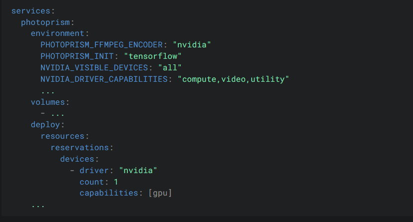

The PhotoPrism docs show this:
Regenerate Thumbnails
docker compose exec photoprism photoprism thumbs -f

Agreed, I updated and now I can't get to the WebUI. No errors, logs says it should be accessible but it just isn't. My docker compose works though. I may remove the template next week if I don't make any progress.

Any news regarding the Affine template? I see it is still available in the Apps tab, but was reading this thread and seeing there were issues later last year. I just discovered Affine and was wondering about self hosting it.
I would recommend running the affine docker compose stack. I really haven't had any time to dive into this. Last time I checked the stack was working.
Affine is working for me with a couple changes:
  • NODE_OPTIONS: --import=./scripts/register.js
  • Post Arguments: sh -c 'node ./scripts/self-host-predeploy && node ./dist/index.js'
Great timing! I just set up this up using the community templates and was having issues registering my admin user. The above two changes worked.
