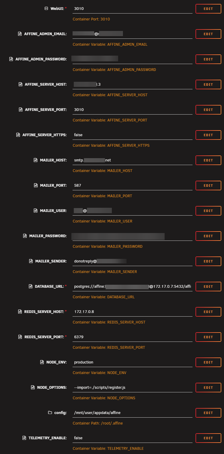

After you have testet it, can you adjust the Affine yaml file and remove these two values? )

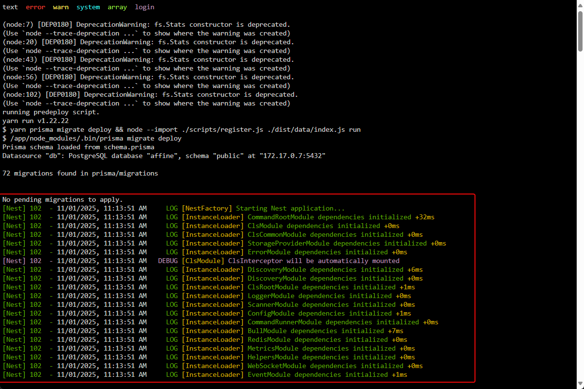

Troubleshooting Part 3:
When I remove the following variables from the config. The container spins up and i get the WebUI with the new version:
Green container:
Troubleshooting Part 2:
When you change the Affine container to an older one:
ghcr.io/toeverything/affine-graphql:stable-e043ecf
Then the container spins up with the settings on my below config.
The register.js is recognized and executed here.

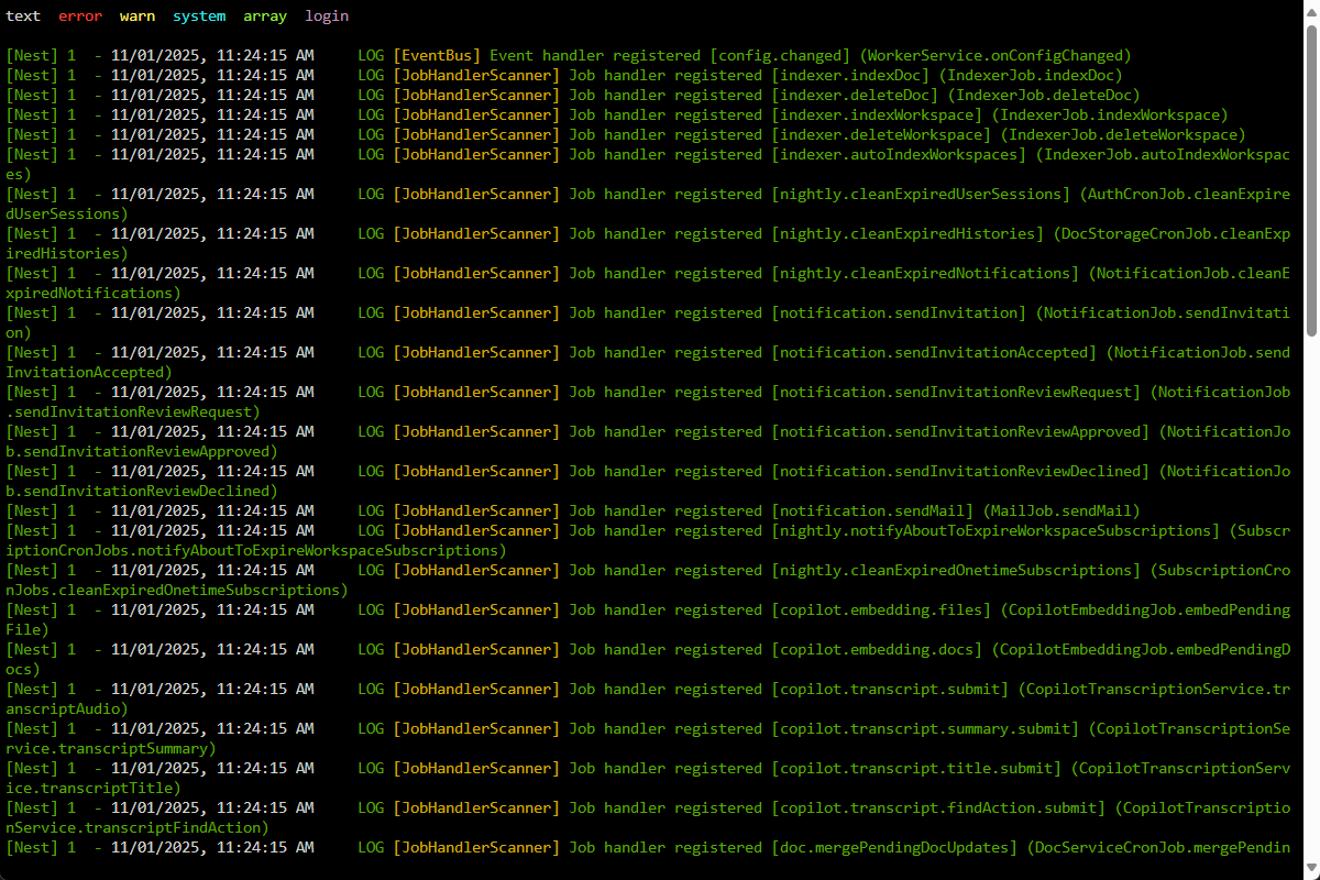

Hello, sorry to disturb you. I am testing the Affine template currently.
I get following issue with the Affine docker container:

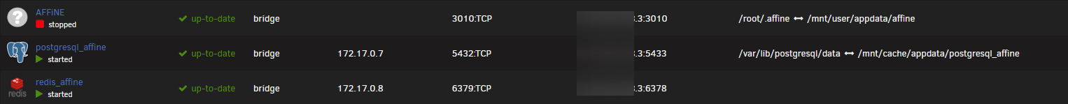

Standard Settings in the Affine Config:
I doesn´t matter currently which IPs I put into postgresql or redis. The above error comes always, when the container launches.
postgres://affine:[email protected]:5432/affine
Thank you for help )

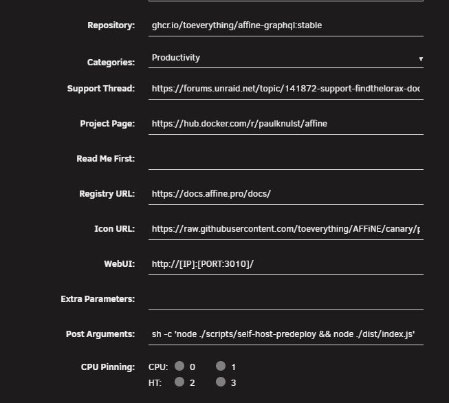

Please make the following changes to the template:
  • NODE_OPTIONS - not needed anymore, it fails to start the container if left on
  • Default Post Arguments should be sh -c 'node ./scripts/self-host-predeploy && node ./dist/main.js'
Container launches normally after these
Edited by Fallen94
