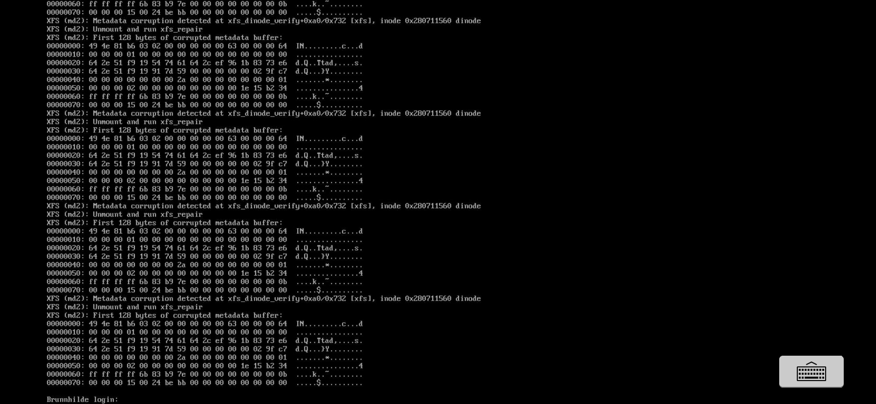

July 11, 20233 yr Saw this in console but not sure of the cause or how to fix it- brunnhilde-diagnostics-20230710-2303.zip
July 11, 20233 yr Author Here are the results of the check. I don’t see a recommendation for variables for the repair though. Phase 1 - find and verify superblock... - block cache size set to 1476704 entries Phase 2 - using internal log - zero log... zero_log: head block 3529282 tail block 3529282 - scan filesystem freespace and inode maps... - found root inode chunk Phase 3 - for each AG... - scan (but don't clear) agi unlinked lists... - process known inodes and perform inode discovery... - agno = 0 - agno = 1 - agno = 2 - agno = 3 - agno = 4 - agno = 5 bad CRC for inode 10744829280 bad CRC for inode 10744829280, would rewrite would have cleared inode 10744829280 - agno = 6 - agno = 7 - process newly discovered inodes... Phase 4 - check for duplicate blocks... - setting up duplicate extent list... - check for inodes claiming duplicate blocks... - agno = 1 - agno = 2 - agno = 5 - agno = 0 - agno = 6 - agno = 7 - agno = 4 - agno = 3 bad CRC for inode 10744829280, would rewrite would have cleared inode 10744829280 No modify flag set, skipping phase 5 Phase 6 - check inode connectivity... - traversing filesystem ... - agno = 0 - agno = 1 - agno = 2 - agno = 3 - agno = 4 - agno = 5 - agno = 6 - agno = 7 - traversal finished ... - moving disconnected inodes to lost+found ... Phase 7 - verify link counts... No modify flag set, skipping filesystem flush and exiting. XFS_REPAIR Summary Tue Jul 11 06:44:19 2023 Phase Start End Duration Phase 1: 07/11 06:42:44 07/11 06:42:44 Phase 2: 07/11 06:42:44 07/11 06:42:46 2 seconds Phase 3: 07/11 06:42:46 07/11 06:43:44 58 seconds Phase 4: 07/11 06:43:44 07/11 06:43:44 Phase 5: Skipped Phase 6: 07/11 06:43:44 07/11 06:44:19 35 seconds Phase 7: 07/11 06:44:19 07/11 06:44:19 Total run time: 1 minute, 35 seconds Edited July 11, 20233 yr by wgstarks
