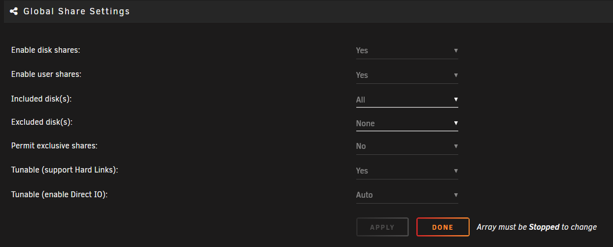

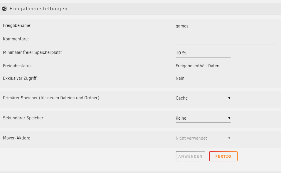

July 12, 20233 yr Hi, I can't enable the option exclusive share: I checked every drive for a folder called games but there aren't so this can't be the problem. What I am missing? Thanks! Edited July 12, 20233 yr by enJOyIT
July 12, 20233 yr Community Expert Solution 10 minutes ago, enJOyIT said: Hi, I can't enable the option exclusive share: I checked every drive for a folder called games but there aren't so this can't be the problem. What I am missing? Thanks! Have you enabled at a global level? Also if you are using NFS exclusive is disabled for that share.
July 12, 20233 yr Author 8 minutes ago, SimonF said: Have you enabled at a global level? Also if you are using NFS exclusive is disabled for that share. Well, you are right! Maybe it is an idea to put this information into the "question mark" text.
