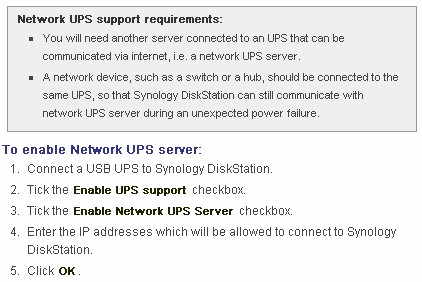

I have 2 synology diskstations that I would like to have communicate to the unRAID APC.
I'm running apcupsd on the unRAID with the clean powerdown package.
Synology utilizes NUT to communicate to an ups, while unRAID is using the apcupsd
http://www.networkupstools.org/
I have 2 options, but wonder if I am making this more complicated than need be.
1.  Setup Syno as the master, unRAID as the slave.
http://lime-technology.com/forum/index.php?topic=13791.msg130563#msg130563
Would I have to install NUT on the unRAID? or should I just...
2.  Setup unRAID as the master, and install apcupsd on the Syno?
http://forum.synology.com/enu/viewtopic.php?f=27&t=19378
Or...can I just leave as is (doubtful)- setup the syno as master, modify the unRAID .conf file (SynoIP:3493) - and have unRAID monitor UPS status <See below>
:)Making progress....installed bootstrap, and the apcupsd ipkg on the synology, and configuring apcupsd.conf for slave service..  I'll post steps how to accomplish if I get it to successfully shutdown on command from the unRAID server.  Any suggestions or help is appreciated
btw:  only command line experience has been mounting drives via nfs, running screen for the pre-clear - I have never done any of this. (if you don't count machine language coding back when I was in 8th grade for simple games!)  Trying to be careful though.

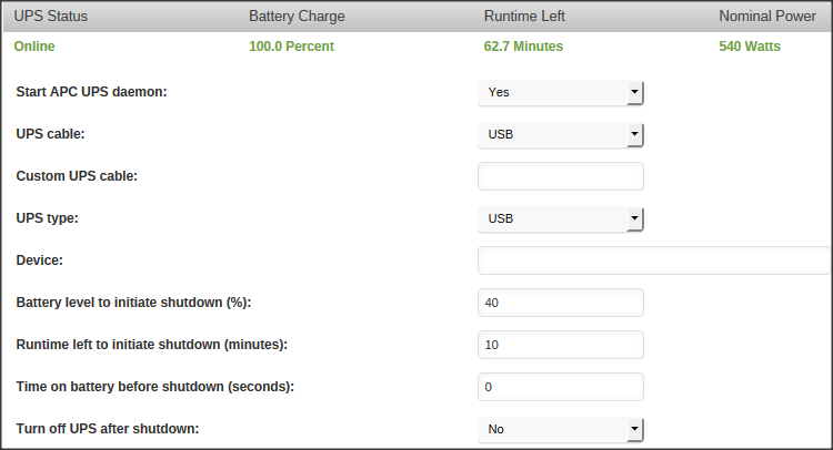

I may have misunderstood, so I would like to clarify things. Your unraid machine is running the apc daemon as configured by the "apc settings" on the unraid ui, correct?  The .conf file you sent me is from the one running on the "slave" machine, correct?
I am doing the modifications to your .conf file (change the ip of the unraid box), but apctest show "getlink not up".  Am I supposed to activate the master mode from the unraid menu somehow or am I still doing something wrong in the .conf file of the synology?
Correct, there is nothing more on unRaid the do the settings in the GUI, unRAID is master as default (no conf file or anything else to change).
