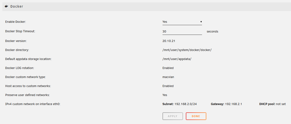

My dockers worked fine, with the following settings (I use directories instead of an image): dockersettings.png

6. settings -> docker: enable docker to Yes, not touching any other settings.
7. All dockers dissapeared.

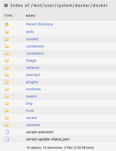

If I browse the docker directory, i see my containers still listed properly.

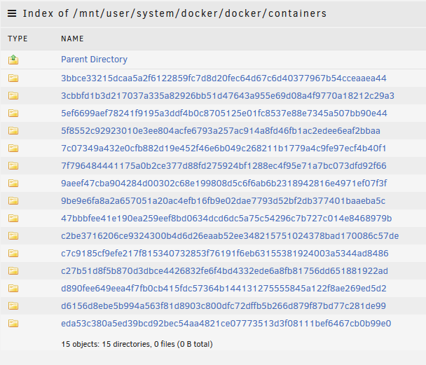

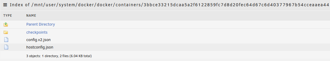

I am aware that I could just re-add the dockers from templates, but I would like to find out why this happened, in order to prevent this in the future. And possibly restore the dockers which are right there in the share: systemshare.png, the containers are there: containers.png, and they have their config: containerconfig.png.
I don't understand what changed: the location of the files is still the same, and the docker settings are pointing to the right path (it also hasn't changed, but I verified anyways) and all data seems to be there.
