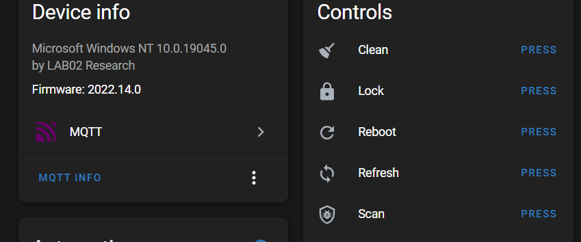

First off, massive thanks to you Bokker for keeping Unraid-API alive and continue improving the functionality. The last fix that fixed HA reboot issues was really nice.
Regarding buttons/switches:
I think reboot/shutdown/parity check was seen as button before some updates, i could be wrong thou. And also everything works fine anyway with the switch as it is now. It does what is supposed to and the switch goes to on for a bit then back to off(as it is not a static on or off activity)
So it just estetics i my mind, like below from a another mqtt service i use. Here reboot is considered as button and gets press the "Press" in ui. So nothing big on the user end, and its really up to you.

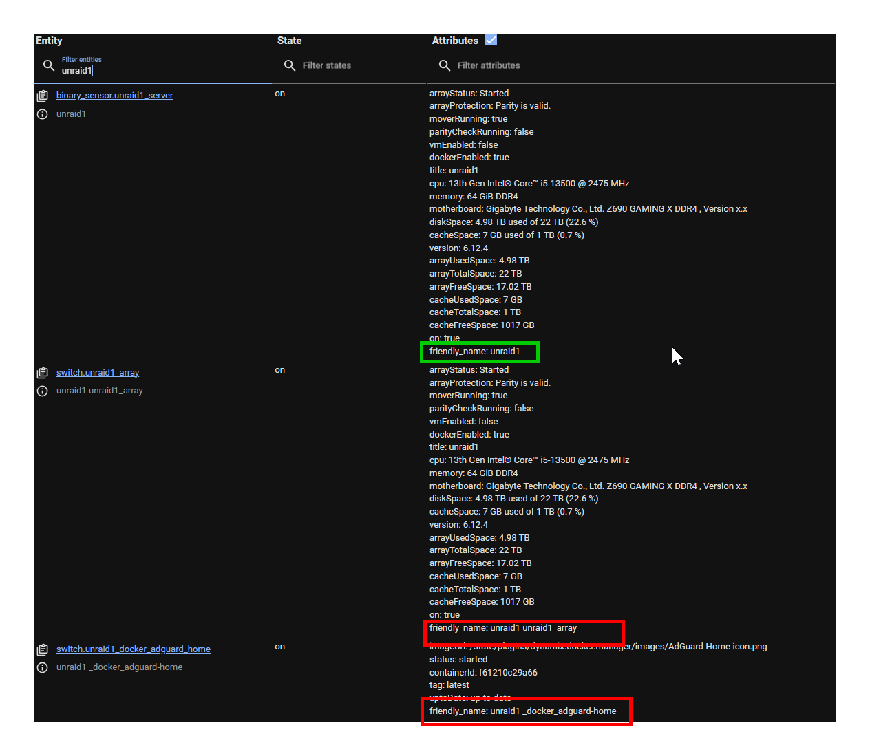

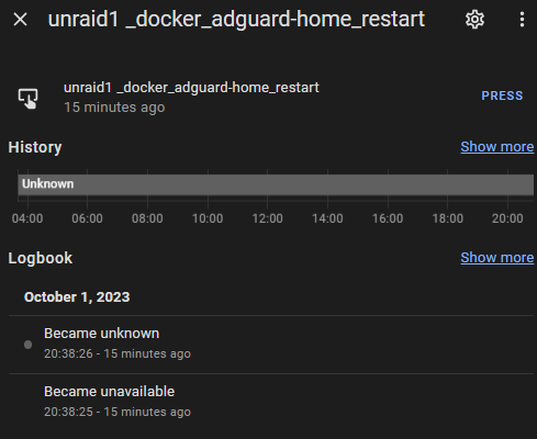

I've setup HomeAssistant to get the data, and I just discovered a minor flaw in naming which I think is inconsistent:
My server-name is (originally enough!) unRaid1
- so the friendy_name of the server-entity is "unraid1"   - so far so god
- then the friendly_name of the array-switch is getting to be "unraid1 unraid1_array"  - so a duplication of server-name and a blank space
   - could friendly name be changed to "unraid1_array" ?
- then the dockers come with friendly_names with spaces and underline: "unraid1 _docker_adguard-home"
   - could friendly name be changed to "unraid1_docker_adguard-home" ?   (without the space)
I'm not a programmer,, so not sure where the friendly-names get created,, but somehow I guess you can fix this  ;)

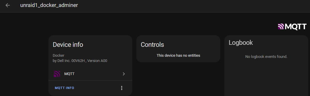

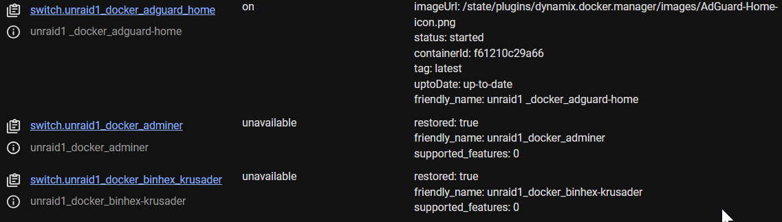

just noticed that also deleted dockers get to HA :)
the Adminer and Krusader is deleted from docker-tab,, but not sure I've restarted server after removing,, so that might be why they show up,,
But the naming of theese do not include additional space between servername and underscore_docker_name
thought I'd share so might be easier to troubleshoot?

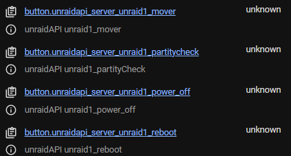

did'nt seem to have an impact on naming - but got new button which worked :)

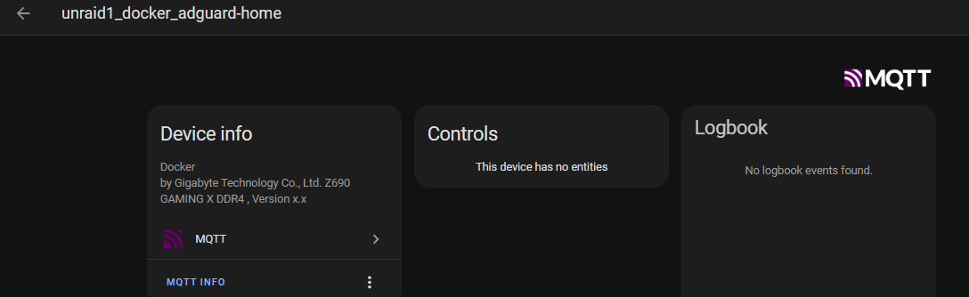

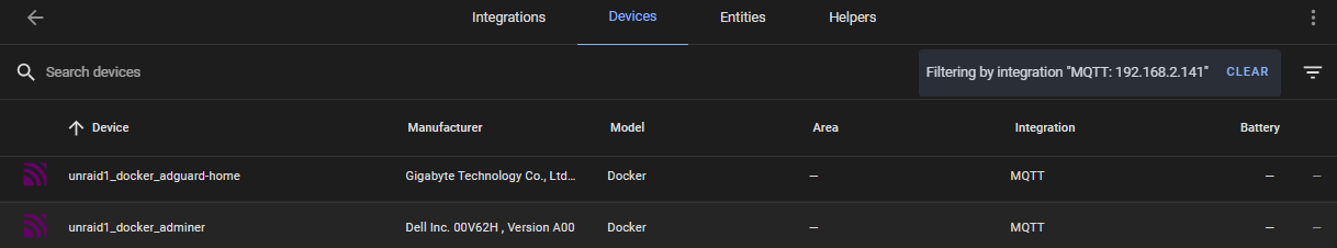

I believe it might have to do with my naming,, and possible "old history" where devices have been added for each entity?
i have a bunch of theese devices,, with no entities in them:
and it "must" be old news,, because the adminer-docker was setup a long time ago,,, and is stuck with my old server-info (upgraded earlier this summer to Gigabyte mobo)
i believe it comes down to renaming device which is not effecting the renaming devices?
Tried to rename the correct device to "unraidAPI",, and came up with this new naming :(
Will try and delete the old devices,, then rename again and see if it makes any difference,,,

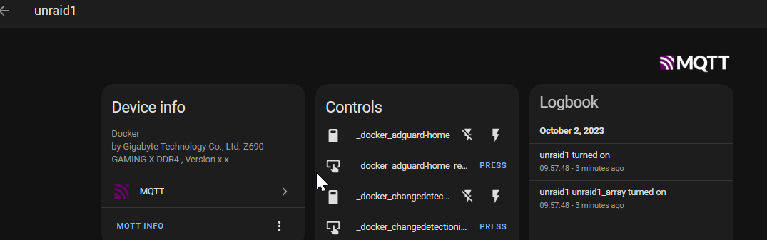

Deleted all the old devices and renamed the one with updated/active entities to "unraidAPI2",, and the naming of entities are still adding a space between the device-name and the entity-part of the friendly name
Can you re-create my issue if you change device-name??

Sorry, I reverted that change

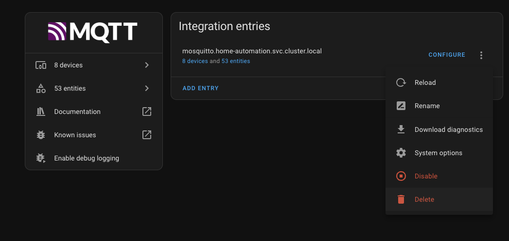

@ArveVM Could you try to remove the mqtt addon, and add it back again. This will just remove the old entities, and once you add it back the existing ones will show again
Edited by BoKKeR
10 hours ago, BoKKeR said:
@ArveVM Could you try to remove the mqtt addon, and add it back again. This will just remove the old entities, and once you add it back the existing ones will show again.
I guess what you meant was delete the integration and re-add the integration? (since the Add-on is the mosquito-engine, and the integration is the "getting data from mosquitto into HA"

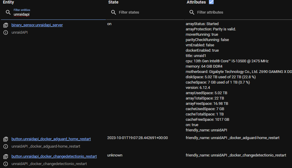

so I've tried that,, and no success (name is back to unraid1 which is servername in unraid) and there are still spaces in friendly-name and for array the server-name is presented twice (with space between them)
Tried once again,, now deleting integration - restart HA (to ensure removal of entities) - add integration,, and it keep getting in with theese "strange" naming conventions,,,
servername space servername underscore array - should be servername underscore array?
docker switch come with same
button same as switch
"master sensor" with just server-name (Which seems right)

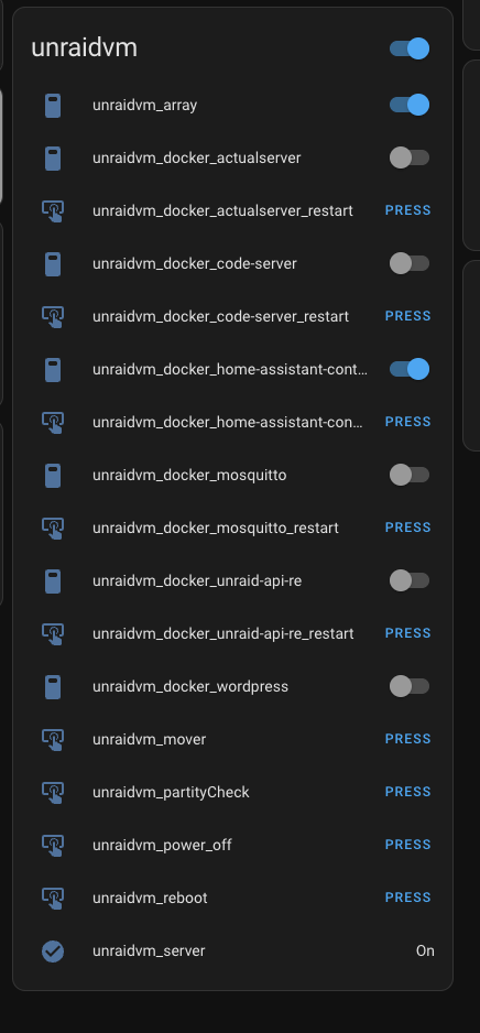

Then I try to rename the device to unraidAPI  (Since I want my sensors to reflect the name of the integration/source the data comes from),, and then get theese namings:
so now that I've cleaned out (my old crap) and installed integration again:
- the device name and entity_id are renaming just fine,,
- but the friendly name of docker-entities/mover/paritycheck(poweroff/reboot have an additional "unwanted" space between servername and 'entity'
Hope you understand this is not a critical bug,, so if you want to park it that is just fine - I'll just instruct my OCD to live with it  :)

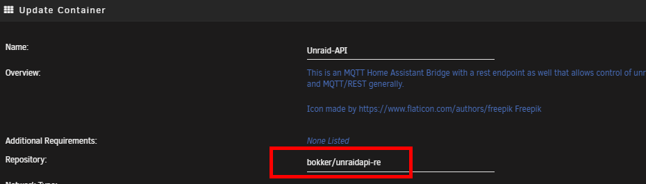

@ArveVM I cant really reproduce it, but I will try further on the weekend. Could you confirm that there is no space in the name of the server? Also are you using any custom theme?
15 hours ago, ArveVM said:
Are you sure you have changed to the new docker?
I believe it was like your screenshot until i updated to the new repository,,,
Thanks for the reply.
My repo was booker/unraidapi-re:6.12
Have changed it to booker/unraidapi-re but still the same issue.
The logs from the docker seem odd with the ip being 0.0.0.0:80
My unraid server is on port 8443
Found a solution for anyone else
Repo bokker/unraidapi-re:6.12 etc
On the WebUI:
Server IP - the long one from server GUI, DELETE the HTTPS at the start of it
Tick the HTTPS option block
Login with root and password.
Now have my server details appearing.
On to HA now.
So have rebooted HA a few times and left it for a while but still nothing being added to MQTT integration. Have searched entities also but nothing new added.
Should the UnraidAPI just appear in the MQTT integration or do we still need to install that API addon like in the original version?

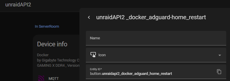

Same as above that has strange naming on the 5 ”new” button/switch, doubled unraidserver name.
button.unraidservername_unraidservername_mover
button.unraidservername_unraidservername__partitycheck
button.unraidservername_unraidservername__power_off
button.unraidservername_unraidservername__reboot
switch.unraidservername_unraidservername__array

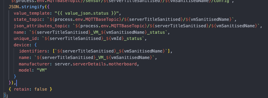

Good news everyone! I located the naming issues cause https://community.home-assistant.io/t/psa-mqtt-name-changes-in-2023-8/598099
I couldnt reproduce it since I was running the older version of HA.
Here is an example error you might have noticed in HA:
2023-10-03 10:48:52.147 WARNING (MainThread) [homeassistant.components.mqtt.mixins] MQTT entity name starts with the device name in your config {'payload_available': 'True', 'payload_not_available': 'False', 'json_attributes_topic': 'homeassistant/unraidvm/home-assistant-container', 'name': 'unraidvm_docker_home-assistant-container_restart', 'unique_id': 'unraidvm_home-assistant-container_restart', 'payload_press': 'restart', 'device': {'identifiers': ['unraidvm'], 'name': 'unraidvm', 'manufacturer': 'ASUS ASUSTeK COMPUTER INC. , Version Rev 2802', 'model': 'Docker', 'connections': []}, 'command_topic': 'homeassistant/unraidvm/home-assistant-container/dockerState', 'encoding': 'utf-8', 'availability_mode': 'latest', 'qos': 0, 'enabled_by_default': True, 'retain': False}, this is not expected. Please correct your configuration. The device name prefix will be stripped off the entity name and becomes '_docker_home-assistant-container_restart'
Meaning the friendly name cant start with the same string as the device name!

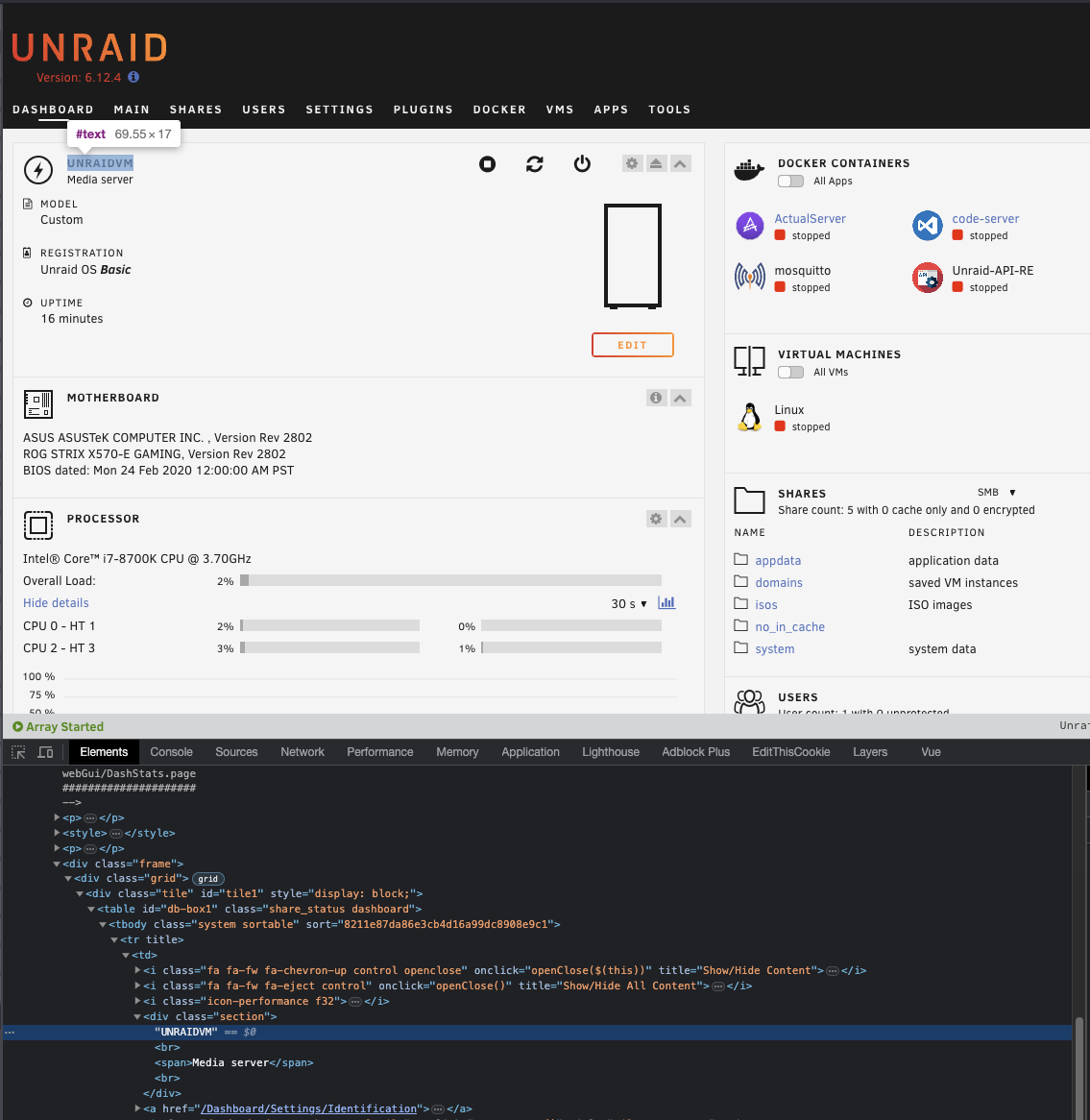

I will have to look into proper naming with the new HA release. I am open to suggestions!
Yeah theres more integrations with the same issue with naming. Ive never really understood the issue fully more than that entity cannot have the devicename in its name. And i rename everything to fit my naming scheme. With thats said keep it simple and set unraidapi or unraid, short and simple.
FYI: When you do update i noticed that parity-check button was misspelled, now we are on a really shallow level of problems :)
And regarding the HA restart issue that was back for me (where you need to restart UnraidAPI docker after HA restart), did anyone else notice this or is it something at my setup only?
Thanks I fixed that typo!
