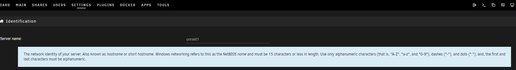

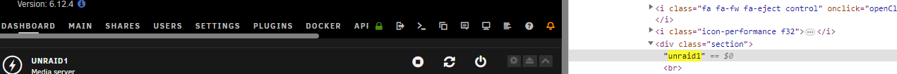

On 10/3/2023 at 9:06 AM, BoKKeR said:
Could you confirm that there is no space in the name of the server? Also are you using any custom theme?
I would normally not use any space in names,, and I believe it is not even allowed in unraid-server-name,,, but thanks for having me verify, - its not like I haven't done stupid rookie mistakes ;)
if you are refering to the Theme Engine plugin then NO, that is not installed.

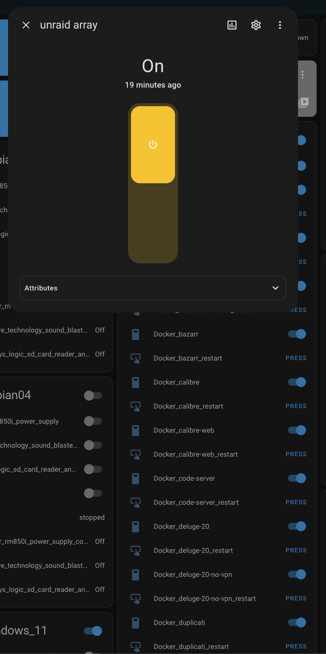

HA-naming:
Since I also integrate my unraid-server with MonitorDocker-integration,, I'd like naming of devices as the integration
So entities from monitordocker is called like sensor.monitordocker_adguard_home
and the unraid-api one could b
 DeviceName=unraidAPI
 Server-level sensors:
   binary_sensor.unraidapi_server
   button.unraidapi_server_mover
   button.unraidapi_server_partitycheck
   button.unraidapi_server_power_off
   button.unraidapi_server_reboot
   switch.unraidapi_server_array
 Docker;
   button.unraidapi_docker_adguard_home_restart
   switch.unraidapi_docker_adguard_home
(i have no VM's)
So for me the logical choice is to have UnraidAPI (integration) as device name
But then how about the advanced guys with mulitple servers??   perhaps a combination of integration-name and server-name just to get the full -full length entity-id's :)

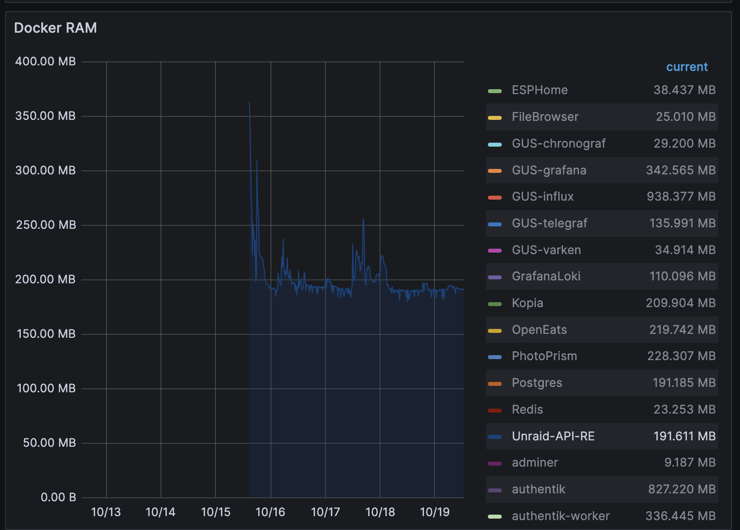

On 10/5/2023 at 2:42 AM, BoKKeR said:
Could you tell me more how you detected the memory leak? What was your setup?
Mine was easily detectable through log files, looking at unraid-api ballooning in ram and then crashing the docker service, i even observed the behavior first hand once as well. The script fixes it if anyone needs to know id be happy to post it, its very simple. But Electic brain uk theirself even detected it and basically did one of these:
¯\_(ツ)_/¯
Heres his post on it from his original support forum thread:
The script is just for restarting the container every four hours, it doesn't address the actual memory leak, just to be clear.
@Foehammer1982
I ran some script to detect potential node leaks and it triggered right away. I am not sure if its false positives, will have to investigate more. The whole polling is done with multiple setTimeout calls so if anything thats my suspect.
Also I am questioning the need for multiple server support, now with the MQTT change. Considering that users could just run multiple docker instances for multiple servers and it would possibly solve some of the problems around MQTT naming.

I have potentially fixed the naming problem. Do try out this branch bokker/unraidapi-re:6.12-naming
I have also grouped the VM usb devices under the VM

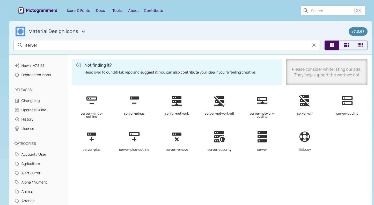

There is also an option to set icons in the MQTT messages for entities. I have not had time to choose any. https://pictogrammers.com/library/mdi/
Edited by BoKKeR

Updated and couldnt find any issues with the naming

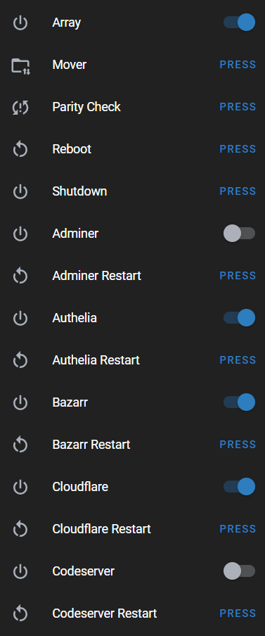

I keep it kinda simple and set my entities to:
docker on/off = mdi:power
docker restart = mdi:restart
mover: mdi:folder-arrow-up-down-outline
array on/off: mdi:power
parity check: mdi:sync-alert
reboot: mdi:restart
shutdown: mdi:power
status: mdi:checkbox-marked-outline
Edited by ABEIDO

20 hours ago, BoKKeR said:
Did you update to the naming fork?
Yes bokker/unraidapi-re:6.12-naming, but to be honest i cannot find where to look for any errors for sure. I remember it there was supposed to be errors in debug log regarding naming. Cannot find any there now. So it seems to be working fine.
Example from  core.entity_registry file looks ok:
        "original_name": "docker_bazarr_restart",
        "unique_id": "unraid_bazarr_restart",
That said i rename my entities always according to my own standard thats why i need to look in core.entity_registry file.
Example:
Edited by ABEIDO

About the memory leaking @Foehammer1982. I am not saying that its not happening but I cant seem to reproduce it on my server (last 7 days view) image.thumb.png.263e203a15592f9693f23a94c459707f.png
Hmm, perhaps it's something with unraid that changed with an update as i was on 6.9 back when that was an issue, great to see its no longer an issue though :)

The application itself runs and in the WebUI all Unraid entities and actions are displayed, but nothing is sent via mqtt. In Homeassistant also nothing arrives.
What is the reason for this and how can I test it? I have a MQTT explorer running in Hassio.
This is also happening with me.  Nothing showing up in HA or in the MQTT Explorer app in Windows.
Running frigate in docker, HA in VM and HASS.Agent on several computers.  I see all the posts from these, but nothing from Unraid-API-RE.
The Unraid-API-RE WebGui works fine and can control dockers/VMS from that without issues.
Are you able to wipe the /config folder and start again?
