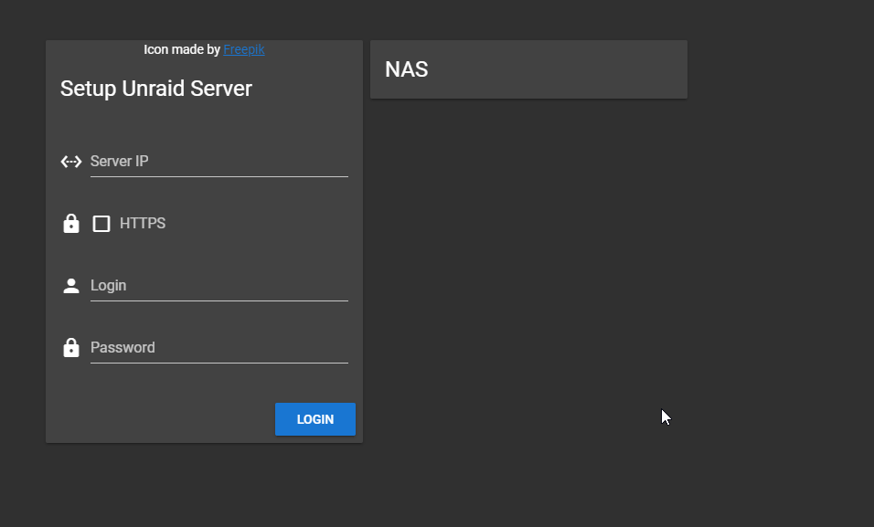

32 minutes ago, BoKKeR said:
Are you able to wipe the /config folder and start again?
Yes, have done several times, as well as re-installing it.
It re-creates the mqttKeys and servers.json files after I login on the WebGui page.  But still won't post anything to the mqtt broker.
I'm using the bokker/unraidapi-re:6.12-naming repository.

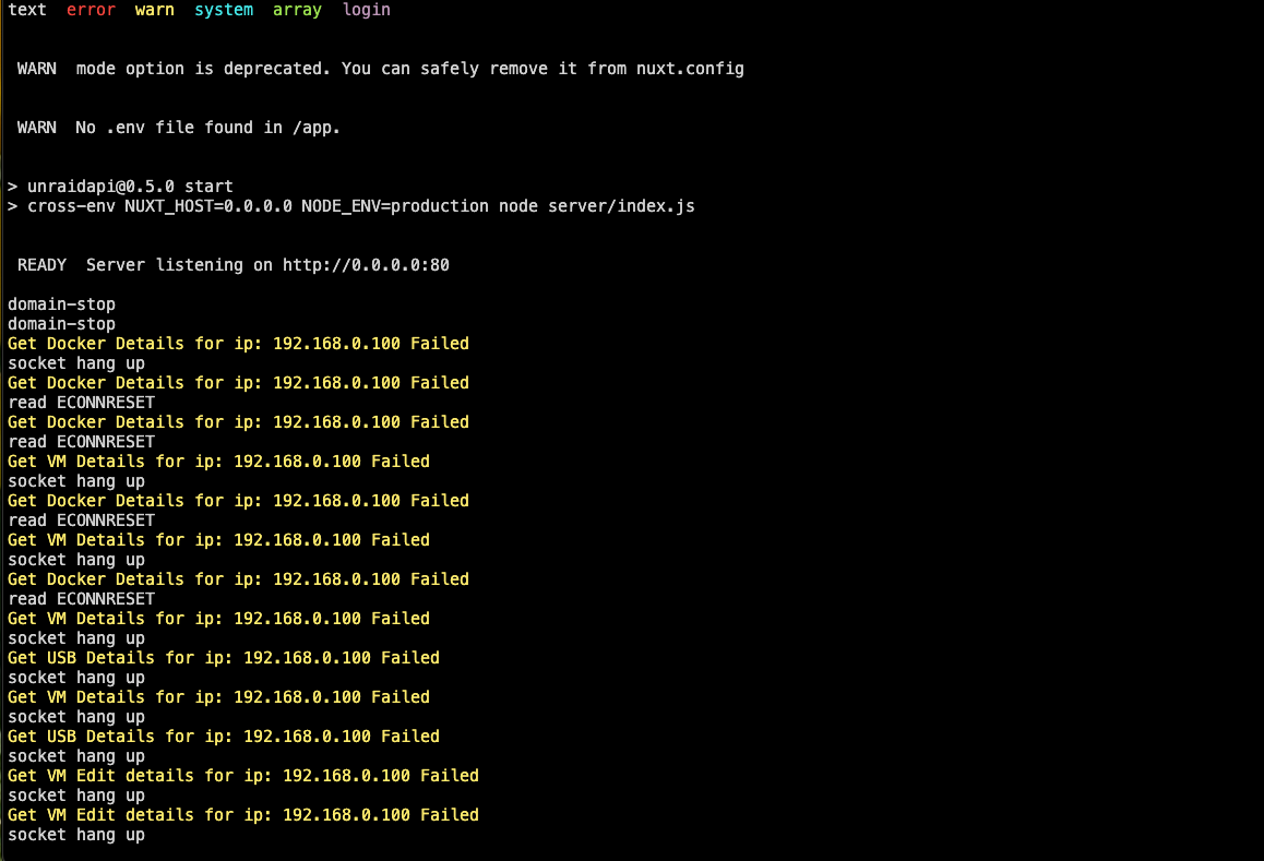

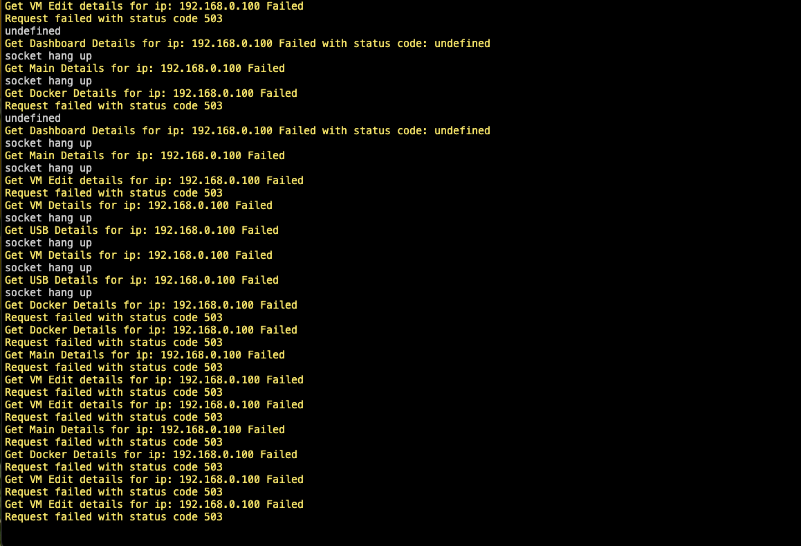

Good morning,
For my part still doesn't work!
The unraid web interface becomes slow and when I stop the container the following errors appear in the logs

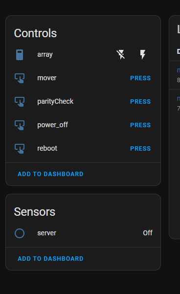

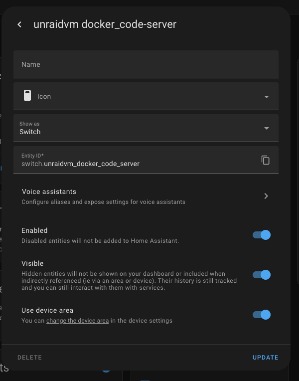

Is there a reason why all are buttons now instead of switches?
In home assistant , what do i do then?
Turn off the button using call service button.press?
On 11/23/2023 at 5:47 AM, mattw said:
I use HA Companion on android.  I can wake my main and backup servers from a widget, but because there is not a switch for shutdown, I am unable to power off my servers.  I assume that I am going to have to add an ssh command to HA as the power off?
Is there a better way?
I would also still like to get cpu temp in via the api... is that a roadmap item?  Otherwise works really well.
I just noticed that all are called buttons now instead of switches.
So you should use the service call: button.press i think
So then u can turn it off.
@syper @ByteHeaven could you try using the MQTTRefreshRate=60 env variable. Setting the refresh to every 60 seconds or even 120. Instead of the default 20 seconds. Also close the website since I noticed that the web browser has its own 3 second times, each tab would start a new 3s process. I will have to rewrite that...
I suspect that when the server/ui becomes slow the unraid-api does not back off and just queues up more tasks ending up slowing down the UI indefinitely.
I would like to rewrite that whole logic but my current fix would require an external redis service. Or implement some sort of logic for exponential backoff https://stackoverflow.com/a/52772266/2515404

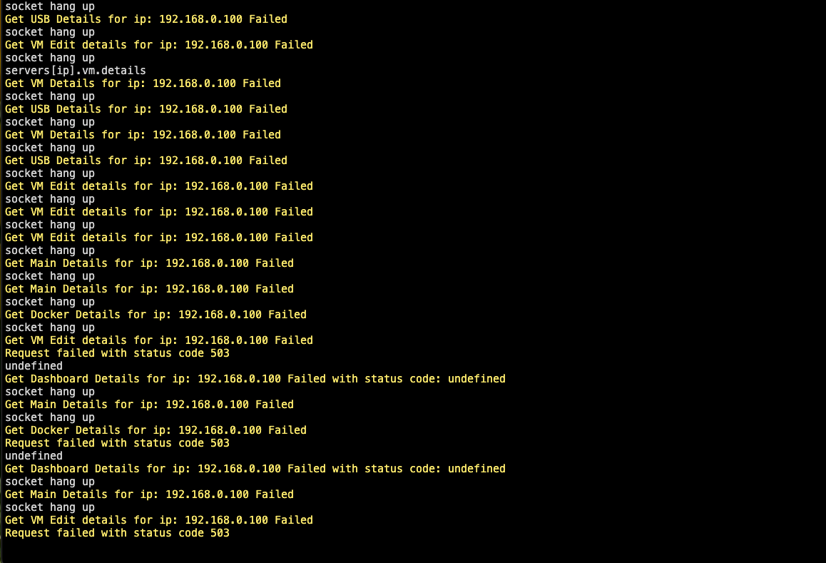

Hello,
thank you for the answer
my server becomes slow as soon as I start Unraid API even though I am not even opening the UI.
Same with MQTTRefreshRate=60 env variable
In log MQTT :
2023-12-05 13:55:33: New connection from 192.168.0.100:58258 on port 1883. 2023-12-05 13:55:33: New client connected from 192.168.0.100:58258 as mqttjs_a72ea9d9 (p2, c1, k60, u'jimmy'). 2023-12-05 13:55:33: Client mqttjs_a72ea9d9 disconnected due to malformed packet. 2023-12-05 13:55:34: New connection from 192.168.0.100:58270 on port 1883. 2023-12-05 13:55:34: New client connected from 192.168.0.100:58270 as mqttjs_a72ea9d9 (p2, c1, k60, u'jimmy'). 2023-12-05 13:55:34: Client mqttjs_a72ea9d9 disconnected due to malformed packet. 2023-12-05 13:55:35: New connection from 192.168.0.100:58278 on port 1883. 2023-12-05 13:55:35: New client connected from 192.168.0.100:58278 as mqttjs_a72ea9d9 (p2, c1, k60, u'jimmy'). 2023-12-05 13:55:35: Client mqttjs_a72ea9d9 disconnected due to malformed packet. 2023-12-05 13:55:36: New connection from 192.168.0.100:58288 on port 1883. 2023-12-05 13:55:36: New client connected from 192.168.0.100:58288 as mqttjs_a72ea9d9 (p2, c1, k60, u'jimmy'). 2023-12-05 13:55:36: Client mqttjs_a72ea9d9 disconnected due to malformed packet. 2023-12-05 13:55:37: New connection from 192.168.0.100:58304 on port 1883. 2023-12-05 13:55:37: New client connected from 192.168.0.100:58304 as mqttjs_a72ea9d9 (p2, c1, k60, u'jimmy'). 2023-12-05 13:55:37: Client mqttjs_a72ea9d9 disconnected due to malformed packet. 2023-12-05 13:55:38: New connection from 192.168.0.100:36580 on port 1883. 2023-12-05 13:55:38: New client connected from 192.168.0.100:36580 as mqttjs_a72ea9d9 (p2, c1, k60, u'jimmy'). 2023-12-05 13:55:38: Client mqttjs_a72ea9d9 disconnected due to malformed packet. 2023-12-05 13:55:39: New connection from 192.168.0.100:36584 on port 1883. 2023-12-05 13:55:39: New client connected from 192.168.0.100:36584 as mqttjs_a72ea9d9 (p2, c1, k60, u'jimmy'). 2023-12-05 13:55:39: Client mqttjs_a72ea9d9 disconnected due to malformed packet.
So, the button service call works to shut down the server... and the WOL component turns it on just fine.
This has allowed me to create and android widget that will power up/down my backup server!
Here is my HA config that creates switch.backup
  - platform: wake_on_lan
    mac: "BC:5F:F4:xx:xx:xx"
    host: 192.168.1.101
    broadcast_address: 192.168.1.255
    turn_off:
        service: button.press
        data: {}
        target:
          entity_id: button.backup_server_backup_power_off
Edited by mattw

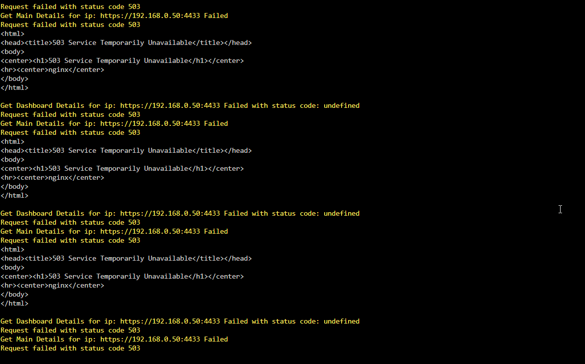

Trying this out for the first time. Im on 6.12.6. Only a few things are showing up but im also getting 503 errors. Could this be because of the version of Unraid, something changed?
Exactly the same here.

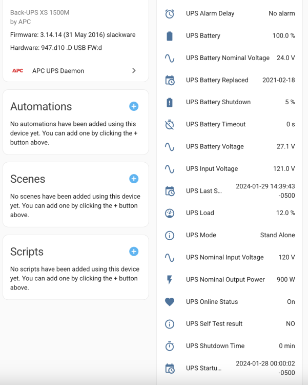

Something I would be very interested in the "Power" values on the dashboard, especially the "UPS Load" (which is the amount of power the server is currently pulling from the UPS).

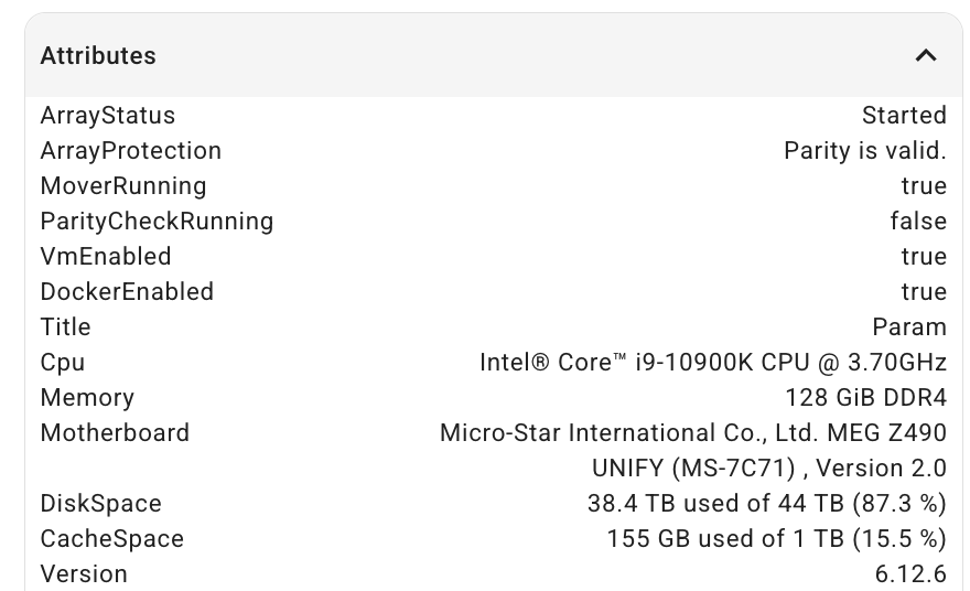

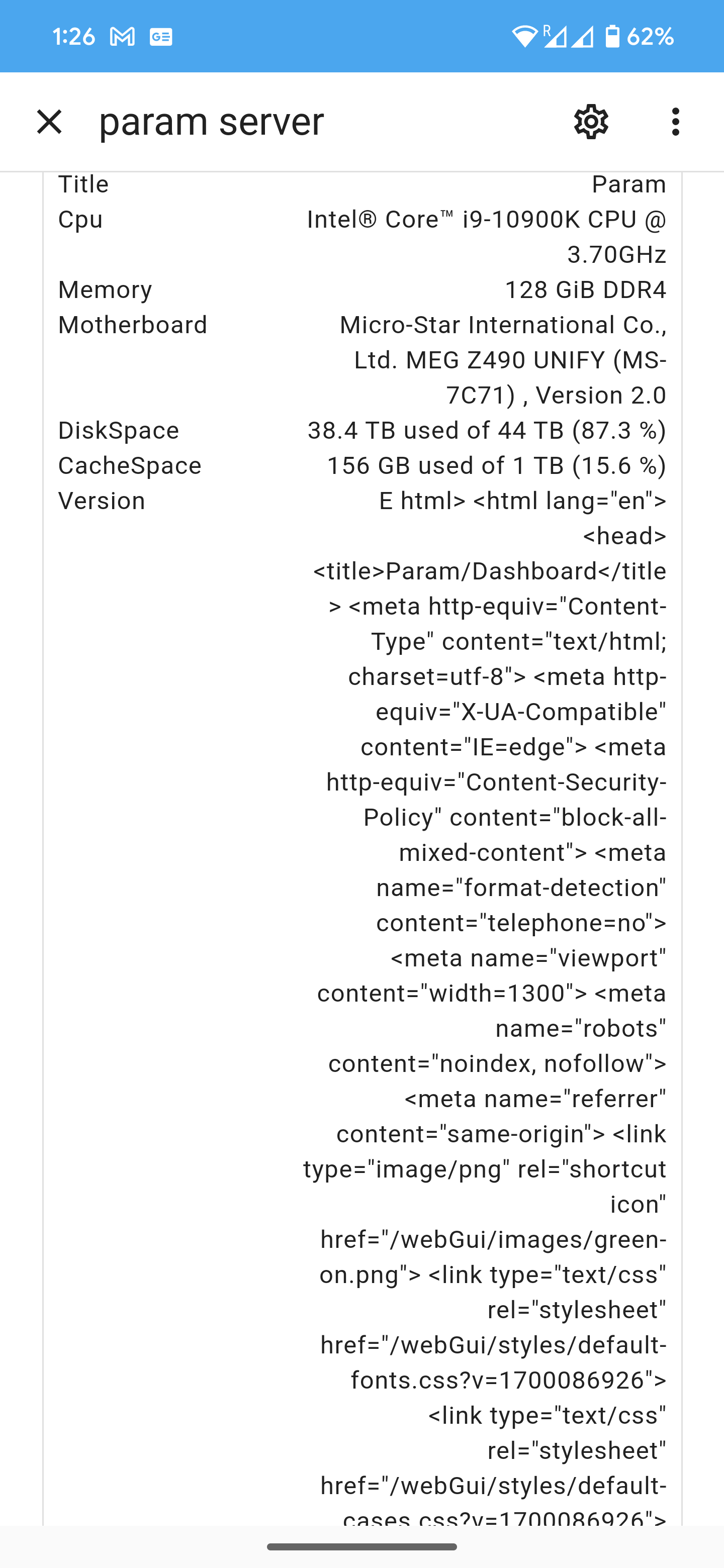

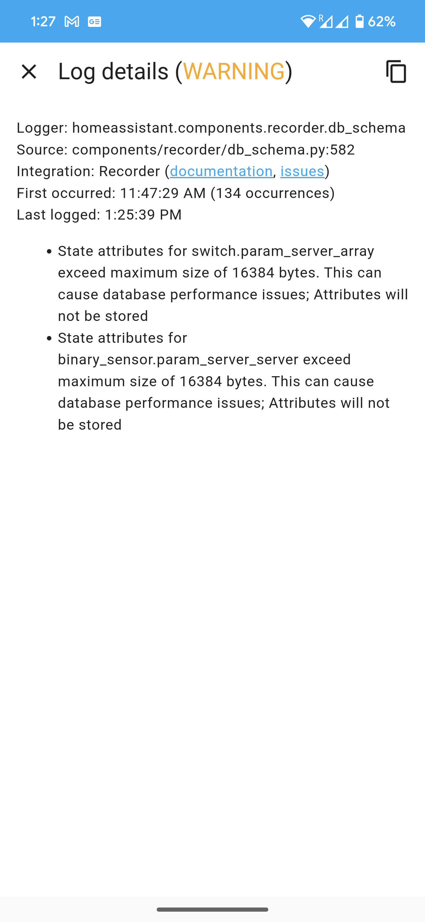

Hi. Thanks for reviving this great tool!
I have been getting mqtt warnings in HA, and I believe it's because the Version attribute isn't getting correctly parsed. Attaching screenshots for more clarity
Submitted a PR - it worked in my server running 6.12.6:

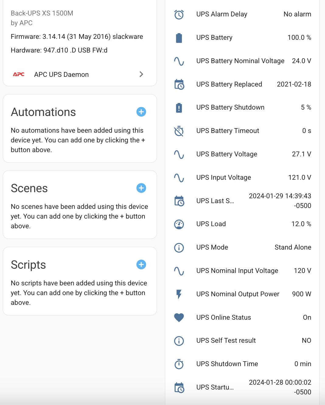

@BlaM - I use the APC UPS integration in HA to extract UPS information from my Unraid server:
After the files from @light2089 I have fixed so the version returns an empty string in the meanwhile if the version is not found. I will investigate further since it works on my test machines and I suspect its some kind of a custom setting which hides the version on the main page
