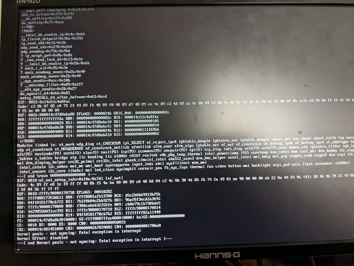

July 12, 20233 yr ASUSTeK COMPUTER INC. Z97-E/USB 3.1 , Version Rev X.0x American Megatrends Inc., Version 0503 BIOS dated: Wed 20 May 2015 12:00:00 AM MST Intel® Core™ i7-4790K CPU @ 4.00GHz Memory: 32 GiB DDR3 (4x8GB) WISE TIGER 2.5GBase-T PCIe Network Adapter 2x I/O CREST 2 Port SATA III PCI-e 2.0 x1 Controller Card Asmedia ASM1061 7x 14TB WD (array) 2x SANDISK 500GB SSD (cache pool) 1X 4TB WD Green (unassigned device for a VM) Crashing at random times over the last couple weeks. hard reboot and everything comes back and parity check starts. This moring was the first time the console had any data. I did some searching and I am trying software disabling c-states (from this post/solution: https://forums.unraid.net/bug-reports/stable-releases/692-kernel-panic-not-syncing-fatal-exception-in-interrupt-r1447/) . Was curious is someone else can gleam any useful info from the logs. Thanks! unraid-diagnostics-20230712-0724.zip

July 12, 20233 yr Community Expert Jul 8 23:27:30 UNRAID kernel: macvlan_broadcast+0x10a/0x150 [macvlan] Jul 8 23:27:30 UNRAID kernel: ? _raw_spin_unlock+0x14/0x29 Jul 8 23:27:30 UNRAID kernel: macvlan_process_broadcast+0xbc/0x12f [macvlan] Macvlan call traces are usually the result of having dockers with a custom IP address and will end up crashing the server, switching to ipvlan should fix it (Settings -> Docker Settings -> Docker custom network type -> ipvlan (advanced view must be enabled, top right)).
July 12, 20233 yr Author 15 minutes ago, JorgeB said: Jul 8 23:27:30 UNRAID kernel: macvlan_broadcast+0x10a/0x150 [macvlan] Jul 8 23:27:30 UNRAID kernel: ? _raw_spin_unlock+0x14/0x29 Jul 8 23:27:30 UNRAID kernel: macvlan_process_broadcast+0xbc/0x12f [macvlan] Macvlan call traces are usually the result of having dockers with a custom IP address and will end up crashing the server, switching to ipvlan should fix it (Settings -> Docker Settings -> Docker custom network type -> ipvlan (advanced view must be enabled, top right)). Thank you. That is a good catch and not something I would have known to look for. I've made the change, fingers crossed.
