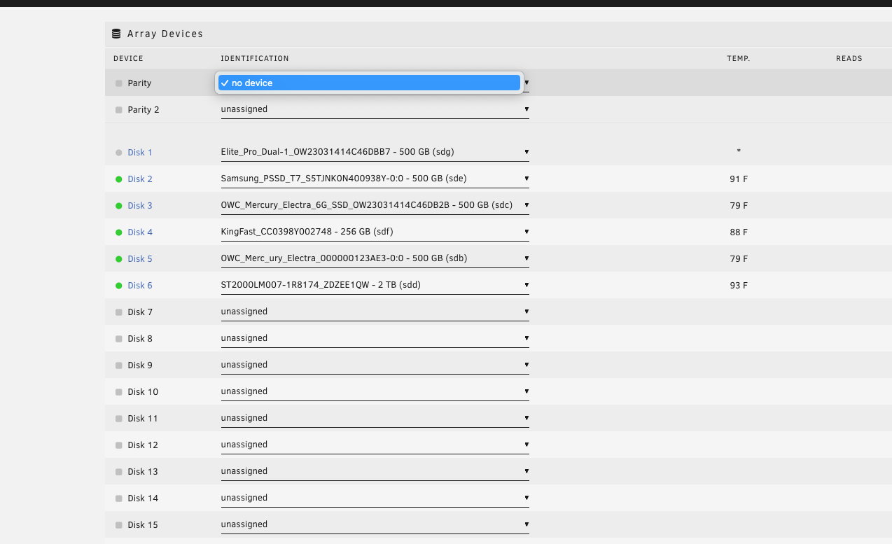

July 14, 20233 yr Author As a note, sometimes I can get 1 of the drives within the enclose to appear on the Array devices selection screen. It appears as "spun down", but the parity drive which is also in the enclosure does not appear. See attached screenshot. Parity selection list is empty, and Disk 1 shows but is spun down.
July 14, 20233 yr Author Solution I think I solved the problem. Tried mounting the parity drive onto another computer to run diagnostics...discovered that it makes clicking sounds while starting and will not mount. I think I just experienced my first failed drive (hurray?). New 8TB on order.
