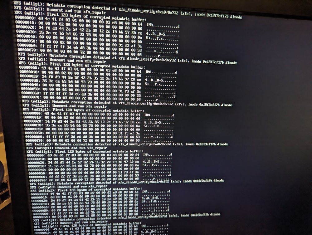

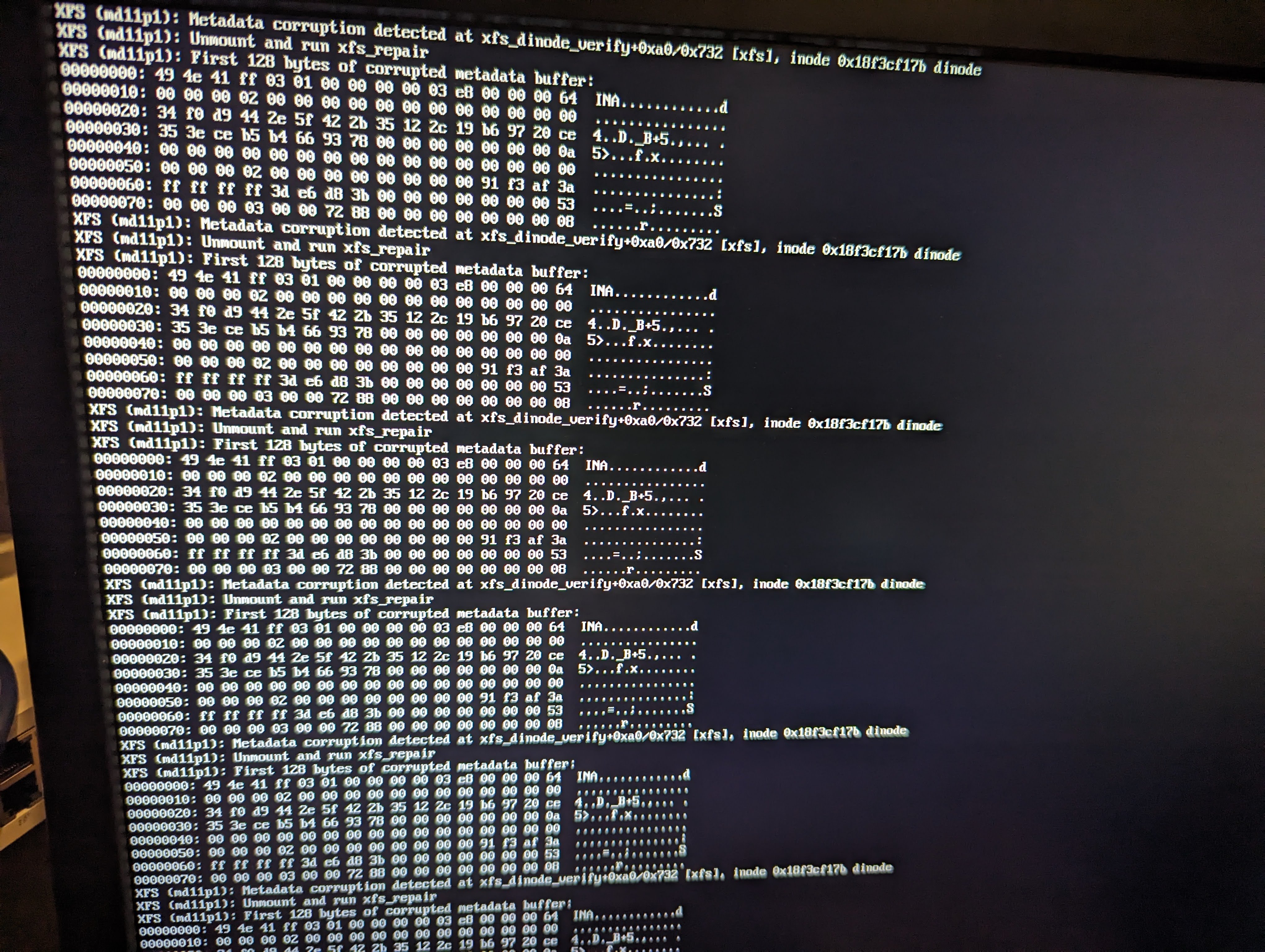

July 14, 20233 yr Hi guys. Last few months my Server has been freezing anywhere from once a day to once every week. Its running a i7 6700 32gb of ram, 2x LSI 8 Port IT Mode raid cards. I have swapped out the mother board, CPU, RAM, and the 2 raid cards and its still happening. 99% of the time the screen is just black and keyboard commands don't work so I have to force restart it. RAID check finished most of the time and has no errors I would like to thank everyone in advance for any advice as its very frustrating. XFS (md11p1): Metadata corruption detected at xfs_dinode_verify+0xa0/0x732 [xfs], inode 0x18f3cf17b dinode XFS (md11p1): Unmount and run xfs_repair XFS (md11p1): First 128 bytes of corrupted metadata buffer: monsta-nas-diagnostics-20230714-0813.zip
July 14, 20233 yr Community Expert Check filesystem on disk11 then enable the syslog server and post that after a crash.

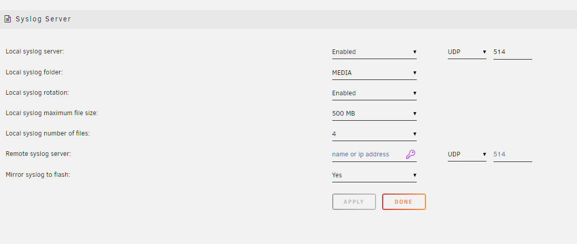

July 29, 20233 yr Author On 7/14/2023 at 6:15 PM, JorgeB said: Check filesystem on disk11 then enable the syslog server and post that after a crash. where does it save the log? there is nothing in the media folder that looks right
July 29, 20233 yr Community Expert 3 hours ago, DeNNii said: where does it save the log? there is nothing in the media folder that looks right With those settings it will be in the ‘logs’ folder on the flash drive.
