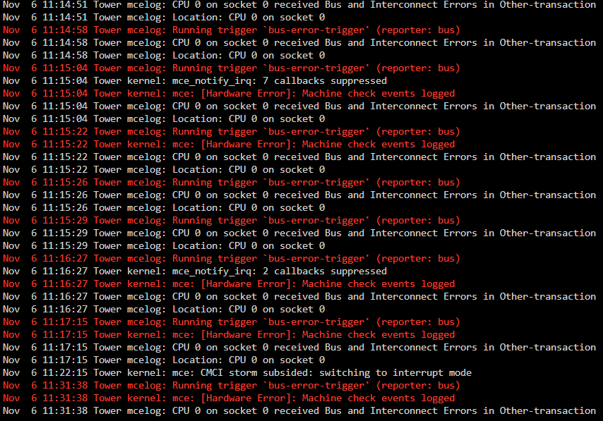

November 6, 20232 yr On 8/12/2023 at 9:48 PM, NeoDude said: Thanks for the reply, nothing extra in the Enhanced Log. I'm going to upgrade to a pair of E5-2697s in the next month so will see what happens then. Hey NeoDude, I get a very similar log on my server. I have a pair of E5-2670 v3 but may look to swap them out too if you have had success with your swap? How are the E5-2697 V2s (12 Core / 2.7GHz)? I am looking at a pair of E5-2687W v4. They a higher base clock (12 Core / 3GHz) which suits my use case better Edited November 6, 20232 yr by Raider_M
