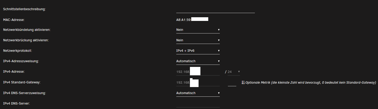

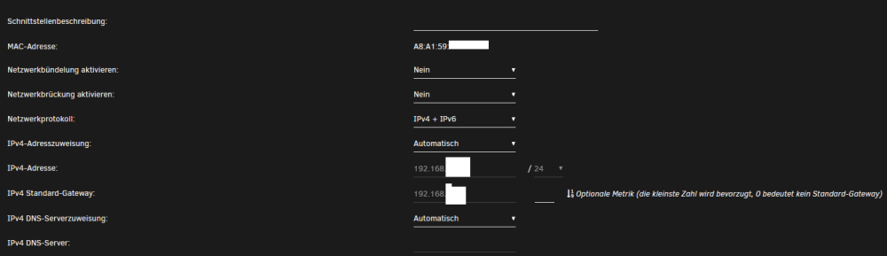

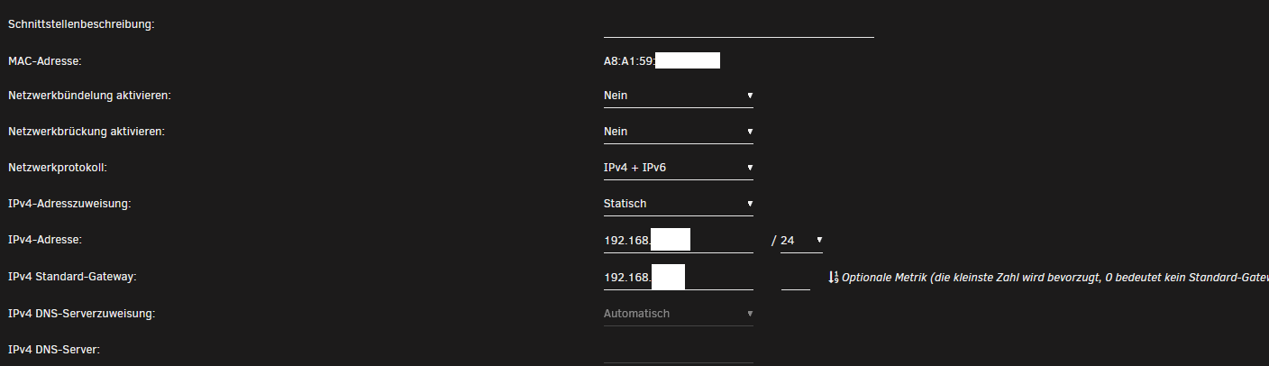

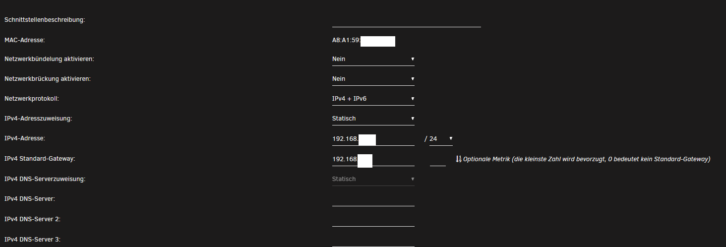

July 16, 20233 yr Author I only have eth0 on my unraid, but good to know - make sense Yep I know coz DHCP gives you DNS entrys anyway. But I fully agree your post but on my Server (Unraid 6.12.3) I cant change to static DNS on static IP (like I said in first post). Watch Screenshots: This is my current IPv4 config... (DNS server is fixed to automatic) When I change IPv4 Address config to automatic: I can change DNS Servers... But If I switch back IPv4 Address config to static: DNS Address config is fixed to static (like you said) - BUT If I setup my DNS Server here and save it... The Settings will fall back like in Screenshot 1 and "/etc/resolv.conf" is empty also... For now: I am using my current IPv4 Settings (Screenshot 1) with a startup script (using go file on flash device) - which replace complete resolv.conf with my correct DNS Servers and domains after complete startup. Edited July 16, 20233 yr by MisterT
