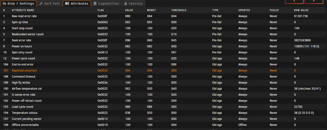

Finished the extended test and it was completed without error. Attached file for the updated SMART report. Still, it has error on dashboard. Will try to sync parity. Update you later.

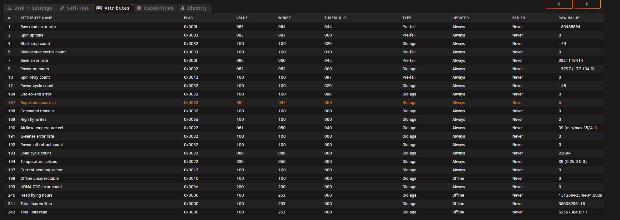

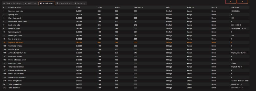

I didn't do parity check. I just stop start the array. I did acknowledge the error but when I click the disk and go to its attributes, the "highlights" is still there like in the image below.

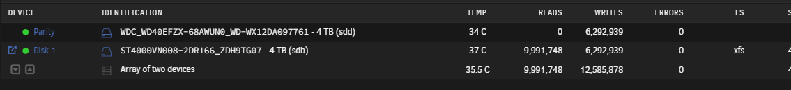

BTW, when I stop start the array, the "Reads" column in the parity is 0. Is that normal?array.thumb.PNG.271530f0574c769da9484c59175649c7.PNG
That'll stay for the rest of the drive's life. You'll be notified by a thumbs down again if it gets worse.
Yes.
