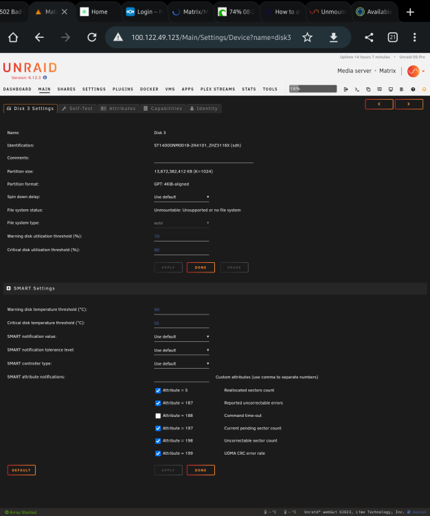

Hi everyone my array went down suddenly with Unmountable: Unsupported or no file system on one of my disks. the file system now shows auto instead of xfs like it should and now that disk has errors. how can i copy the data off that drive to the other drives and save it?
ive attached the diag file.

So one thing is the file system shows auto and I didn't see auto covered?

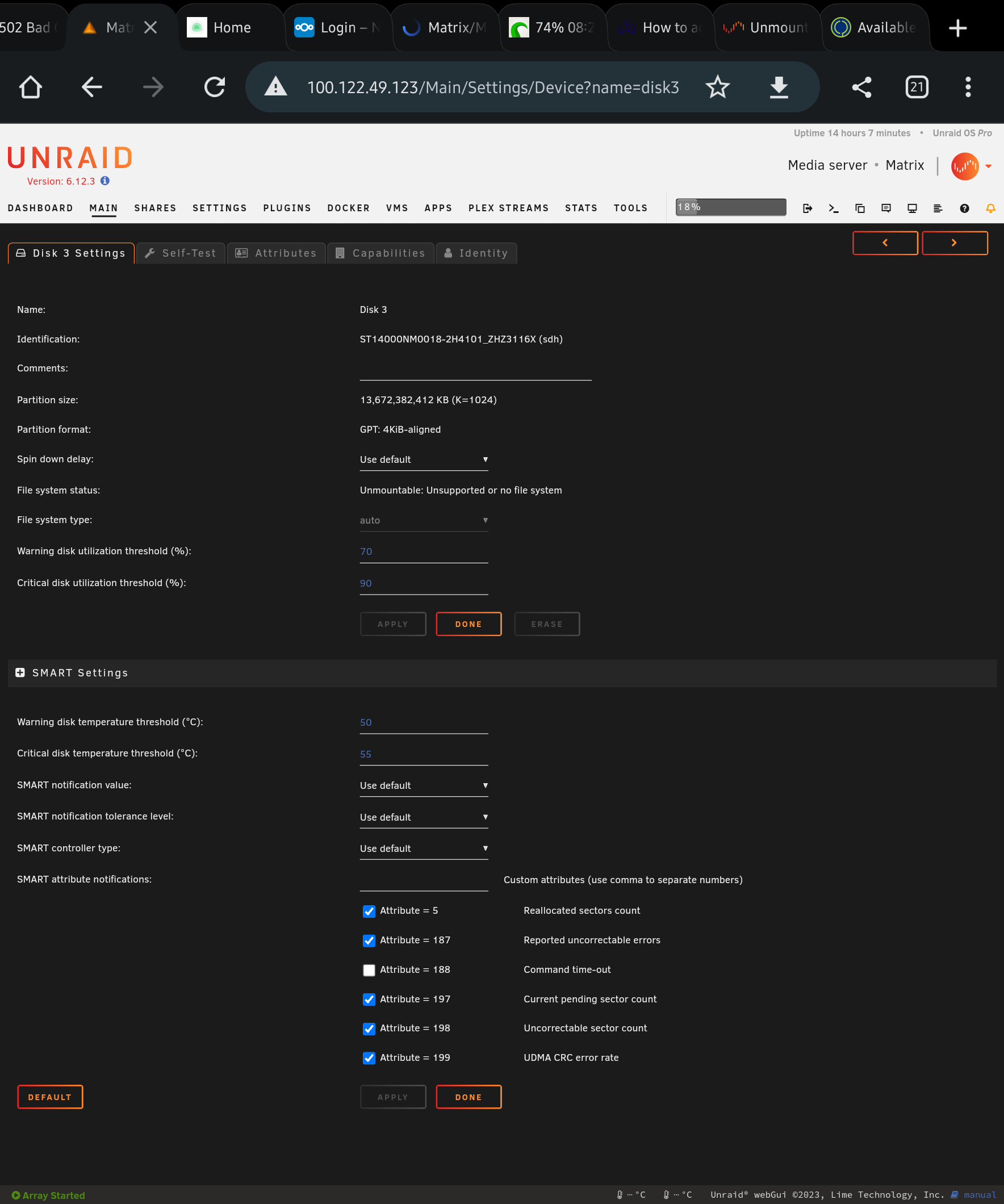

If you know what format was used (probably XFS in the array) then you can set it explicitly by clicking on the drive on the Main tab with the array stopped.   The auto option relies on Unraid being able to dynamically work out what format was used.   Once set explicitly the check/repair options appear that are appropriate to the format you set.
I am unable to select a fs for that drive since it won't mount.
did you stop the array first!    You need to select the file system at that point before any attempt is made to mount it.    You cannot change that setting once you have started the array.
Yes that was with array stopped.
Strange then.   At that point I have no problems changing the file system on my own systems,

i was able to change the FS back to xfs but the drive still shows unmountable

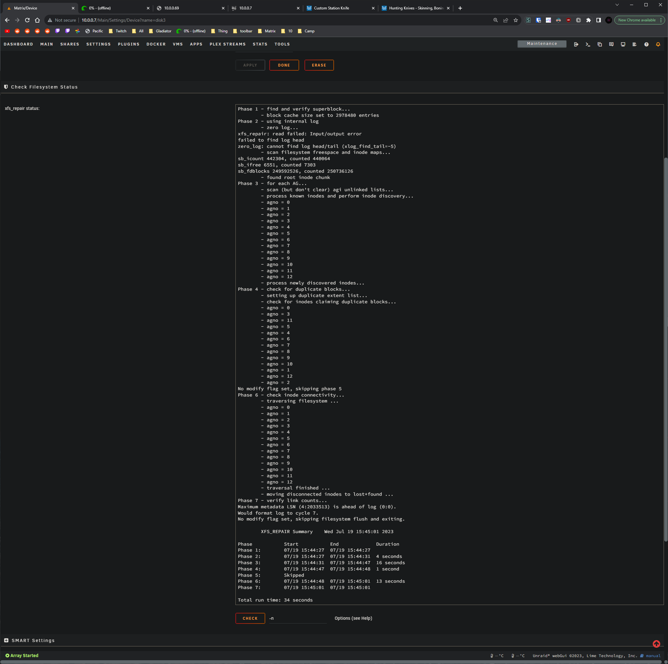

Yes, but does the check filesystem still fail?
sorry for the late reply work has been busy. The check filesystem came back with this
Edited by KLLSWITCH

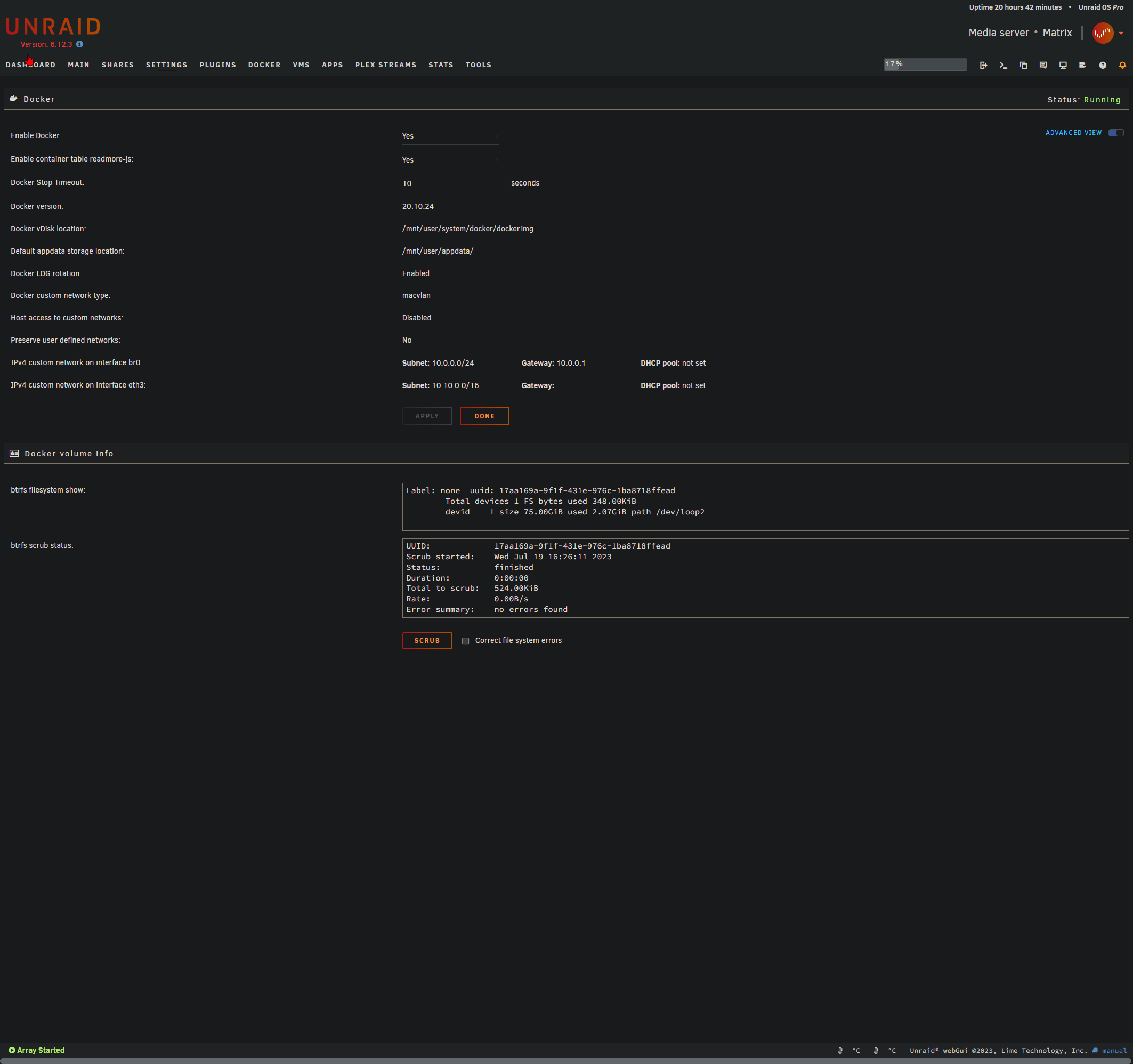

ok so i got the drive repaired for the time being but now all my docker containers are gone? i went to docker and it said no error were found but all the containers are gone?
15 hours ago, JorgeB said:
If you still have the appdata you an recreate the image.
i ended up just re downloading them all from the previous app tab in CA, Thanks for all your help!!
