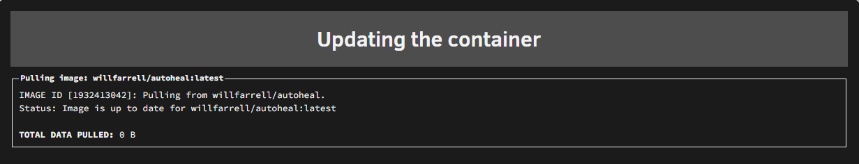

Containers show update available even when it is up-to-date
This is kinda re-opening the following thread:
I have this problem in 6.12.3 too. It happens with many containers and not just from LSIO.
I do have Watchtower installed, I don't know if it matters.
Edit: Diagnostics added.

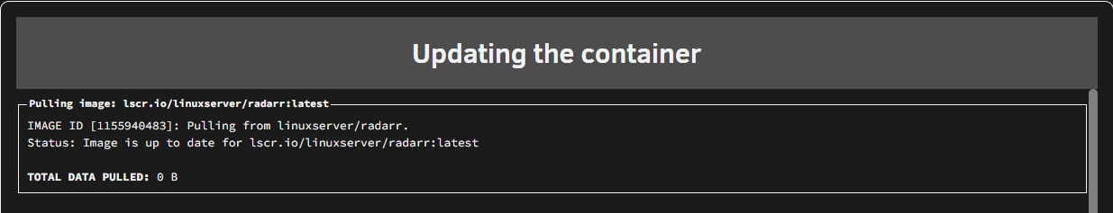

Also having the same issue with binhex/arch-readarr and the linuxserver swag and nextcloud containers. I was having the issue on 6.12.1 and updated to 6.12.3 with no change.
