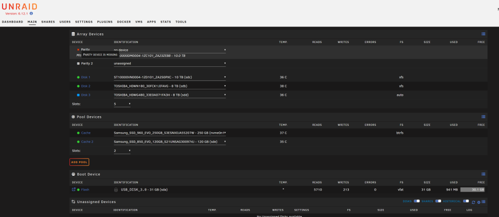

Added new hdd parity device missing
hello all i wanted was to add another hdd and i got this
is ALL MY DATA gone ????
why is my parity drive not showing up?
thanks in advance
Solved by JorgeB
Parity disk is not being detected, check/replace cables and see if it comes back.
it was a bad cable holy shit thanks

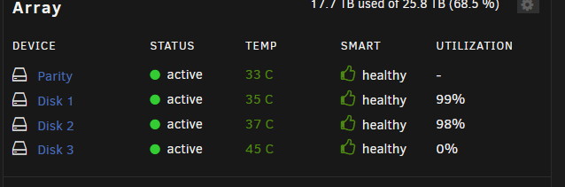

so now i have a even weirder problem i managed to add the hdd it did a clean up for 8 h had to format it it shows in unraid

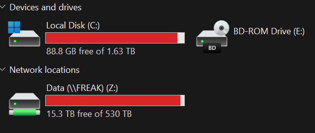

the problem is SMB or windows gone crazy
i had 16.3 before adding the new 8tb so i don't even know where is the 15.3 coming from and the 530 tb is a dream
any way to fix this ?
also is 45 c ok?

Updating to v6.12.3 should fix that.
45C is OK IMHO, but I wouldn't want it to go higher, and 40C would be better.
