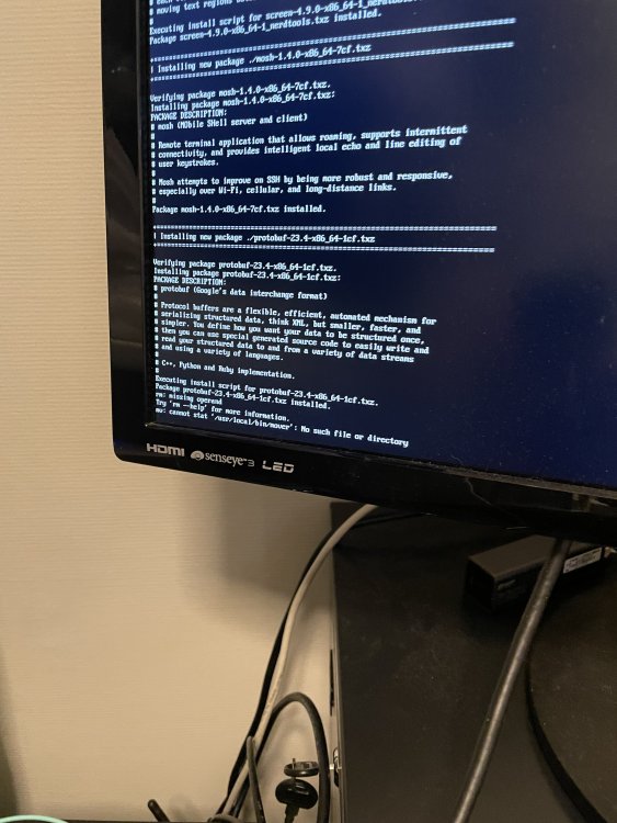

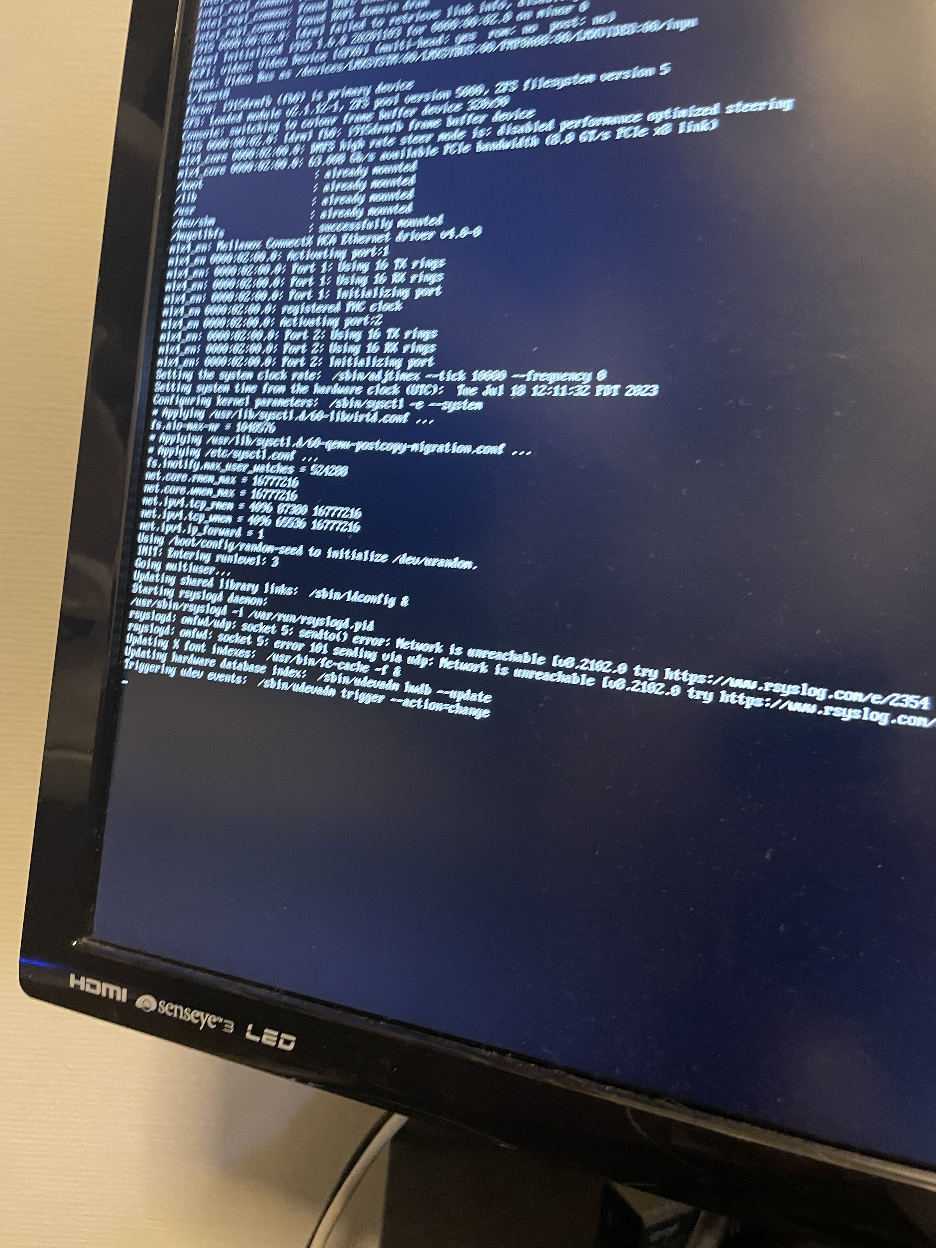

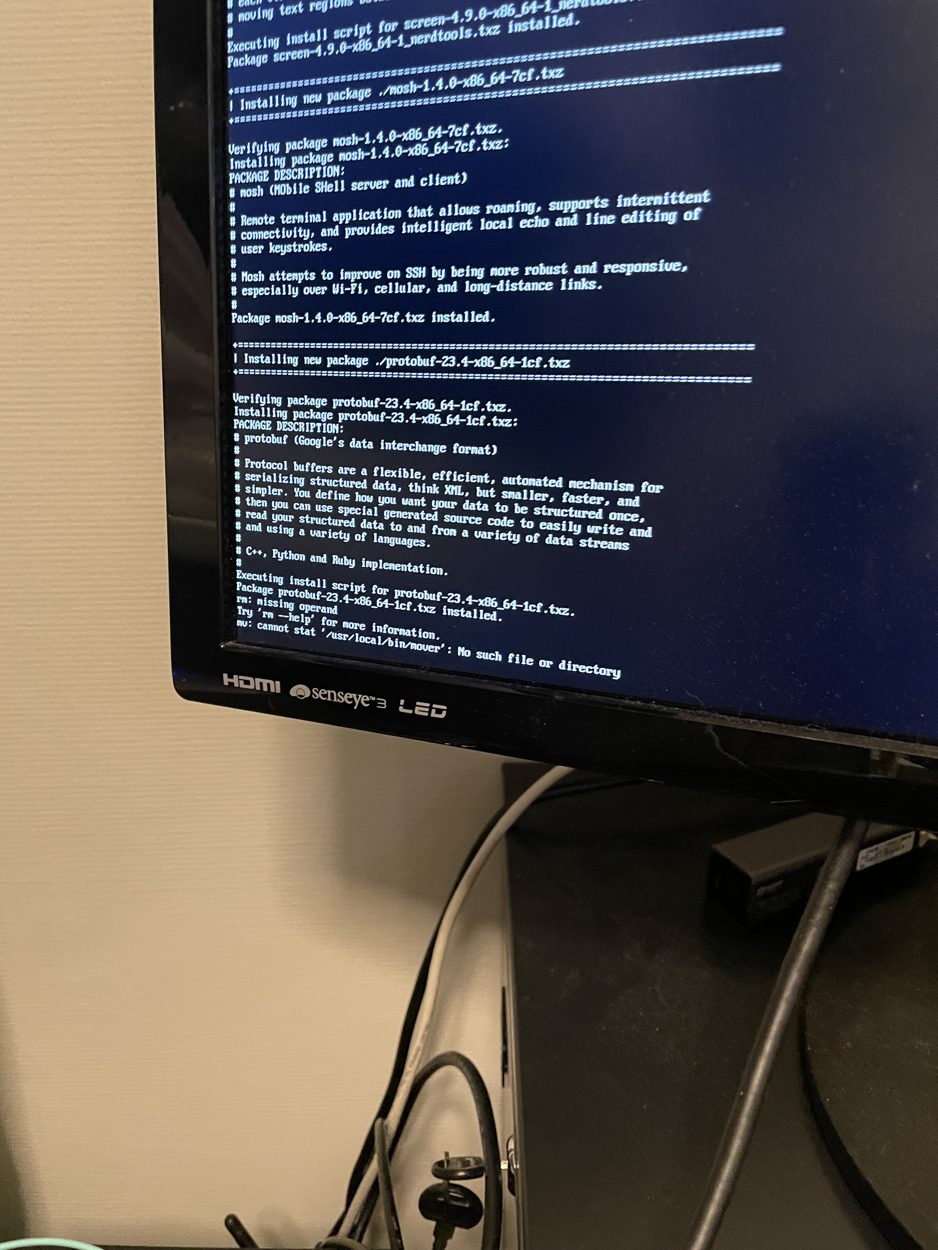

July 19, 20233 yr This is a fairly new installation, with a 10G spf network card. In general it works fine, but from time to time it get no DNS response, and after 30 seconds its back. Especially plex cant run cause it loose connection every 30 seconds. I also have an issue with booting takes a long time, very long, up to 10-15 minutes. It halts on the two photos I am attaching. Im also attaching the diagnostic file Any ideas? Im very happy with unraid, but would like it to work perfectly P.S I have been a good boy and switched my TLD to home.arpa (server.home.arpa) as this is not the officially only domain name that is supported by standards (never use .local !) server-diagnostics-20230719-2259.zip Edited July 19, 20233 yr by Aumoenoav
