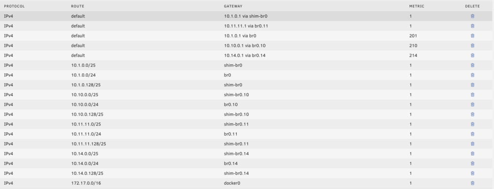

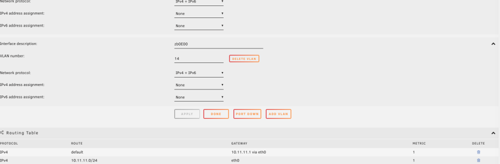

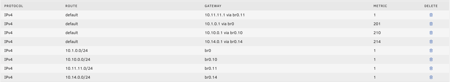

When Docker is enabled, my custom networks switch around the gateways in a way that the parent interface (or native VLAN) becomes the default gateway which is undesired. The default gateway should be on VLAN 11 of the bridge, i.e; br0.11.
Docker disabled (✓):416309618_ScreenShot2023-07-19at13_10_36.thumb.png.55b594f7977babb3361fd2988cdca739.png

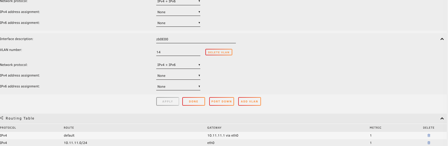

Docker enabled (✕):

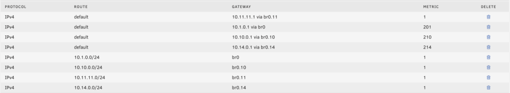

1028704198_ScreenShot2023-07-19at13_14_13.thumb.png.6eafbea515c873d039ef59890b20b680.png
As seen above, routes have high metrics (unimaginatively 200 + the VLAN's ID number) to avoid overriding VLAN 11's gateway as the default. When Docker is down, this is obeyed; when Docker is up this is partly obeyed but there's what it seems like a shortcut of sorts related to DockerDHCP/IPAM that overrides the default gateway even if the checkboxes for that functionality are unmarked (and thus I assumed it meant for it to be off).

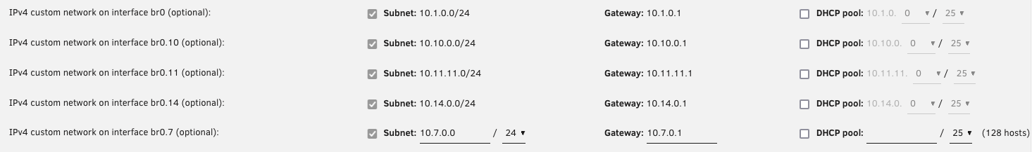

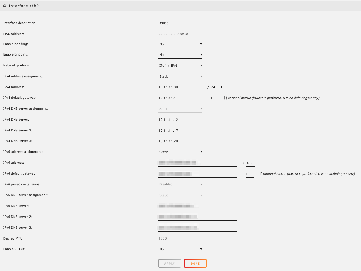

On the Docker settings regardless if it's on macvlan vs ipvlan there aren't settings that could potentially be used to fix it:
490260068_ScreenShot2023-07-19at13_09_23.thumb.png.1a30bec1ae663d33f0dc6bb8318bdb2f.png
I have not tried it yet — partly because all input in Docker's network definitions except for the last in line have been grayed out — removing the network definition entry causing the problem but I have a feeling it'll just move (the default route) down to the next in line listed if I do anyway (i.e. from br0 to br0.10).

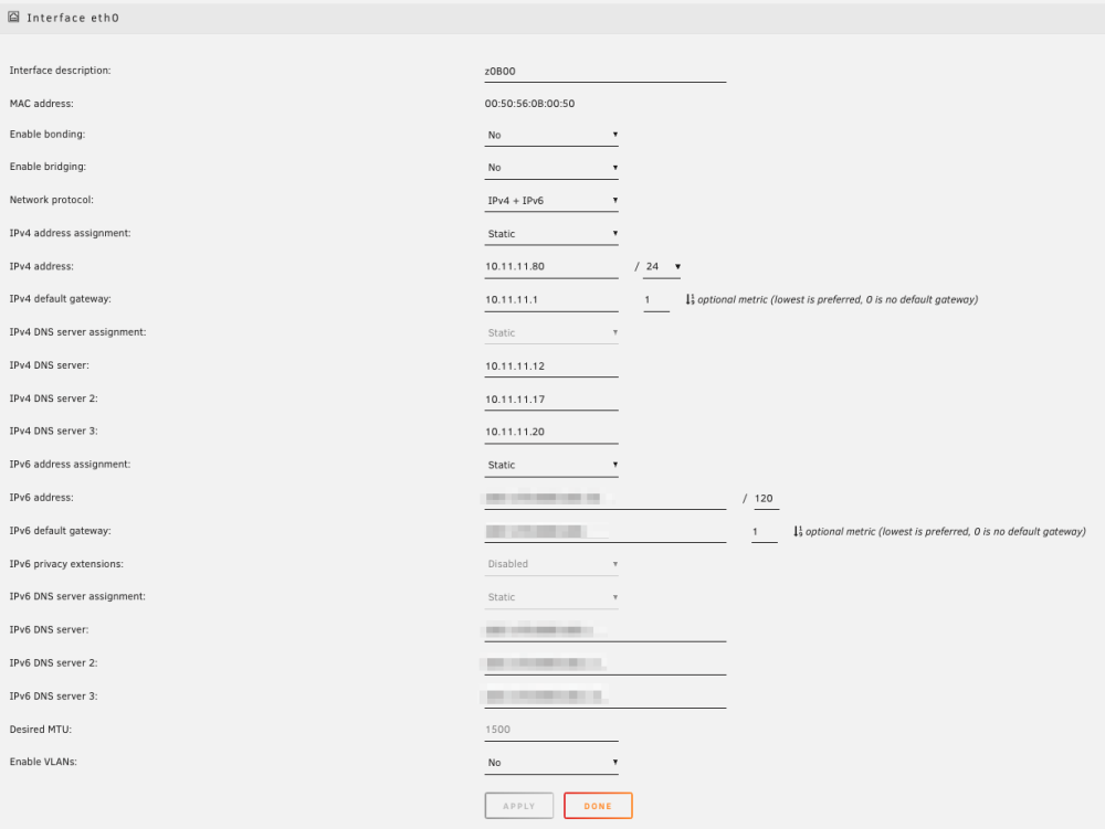

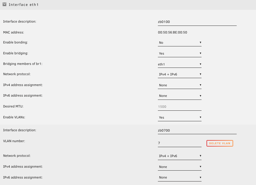

I created an interface for management:

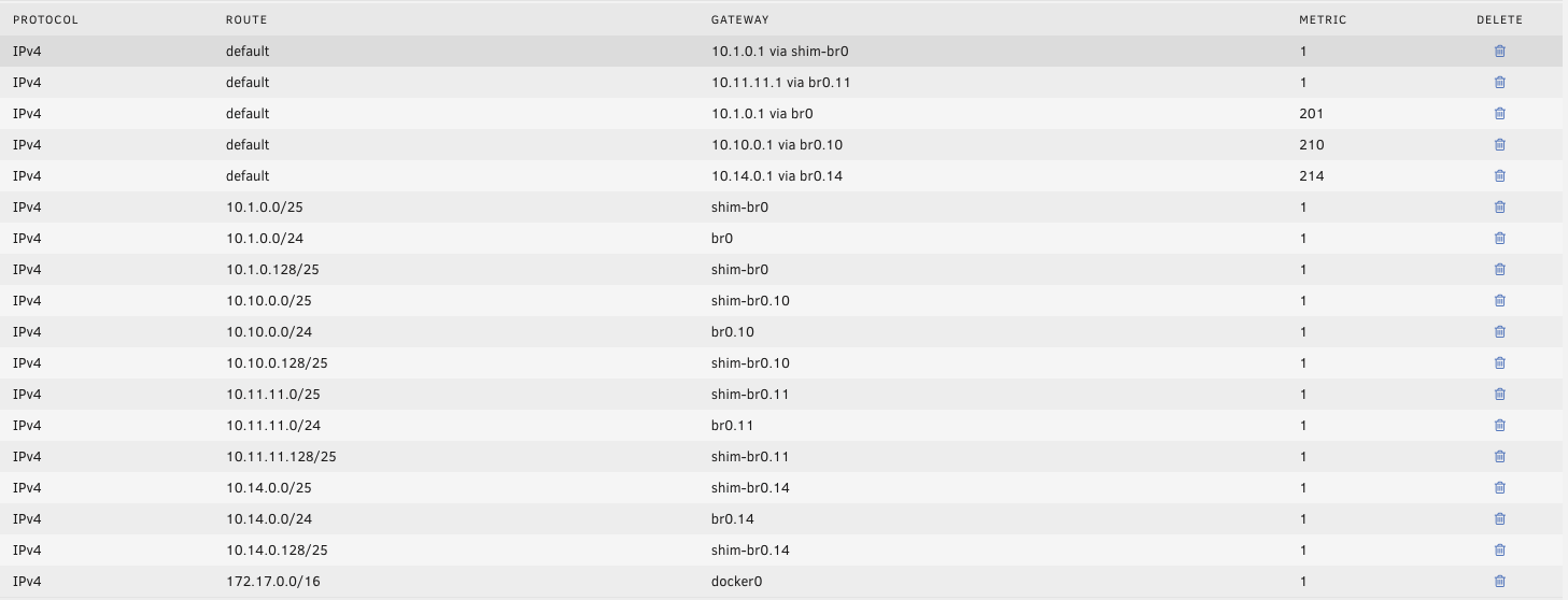

…and another to serve solely as a bridge without any addressing whatsoever:
1260822301_ScreenShot2023-07-19at15_40_53.thumb.png.2e91725404f73e3854b6d8c06912c538.png
I just realized I need another for (heavy) data transfer, but that should do it. :)
