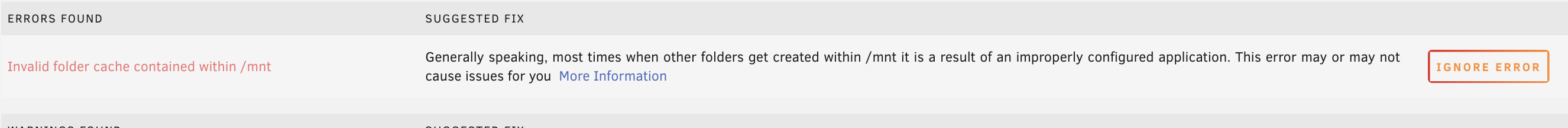

July 24, 20233 yr Author As an update. Even when doing a safe shutdown I lose everything. I went and did a full setup of the system and backed up the appadata so a quick restore there is getting things running but it's not a fix. I am now seeing this error which is new in Fix Common problems. tower-diagnostics-20230724-1819.zip
July 25, 20233 yr Author I'm seeing this thread which sounds like an issue for me. All of my dockers are /mnt/cache/********** which is what I've always done. I removed my 2.5" SSDs and replaced them with two nvme drives each as their own drive. I have a 1tb for the appdata and another drive general use. The 1tb system drive shows 139GB used for the appdata. Is there something I should have done after swapping out the drives where it is perhaps putting everything into RAM instead using the nvme?
July 25, 20233 yr Community Expert 24 minutes ago, FlyingTexan said: I'm seeing this thread which sounds like an issue for me. All of my dockers are /mnt/cache/********** which is what I've always done. I removed my 2.5" SSDs and replaced them with two nvme drives each as their own drive. I have a 1tb for the appdata and another drive general use. The 1tb system drive shows 139GB used for the appdata. Is there something I should have done after swapping out the drives where it is perhaps putting everything into RAM instead using the nvme? it appears you no longer have a pool called ‘cache’ so any docker mapped to a path that starts with /mnt/cache is writing/reading from a RAM location. You need to change any mappings to be mapped to a path that is valid in your current setup.
July 26, 20233 yr Author On 7/25/2023 at 8:32 AM, itimpi said: it appears you no longer have a pool called ‘cache’ so any docker mapped to a path that starts with /mnt/cache is writing/reading from a RAM location. You need to change any mappings to be mapped to a path that is valid in your current setup. So instead of having everything /mnt/cache is should be /mnt/system_cache because that's what one of the drives is named now?
