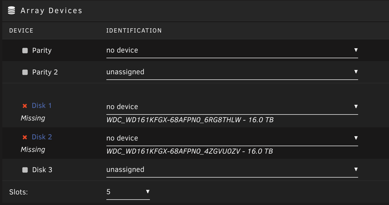

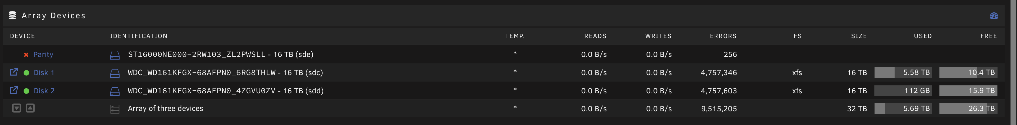

I copied my Plex library into my drives and have set up my Docker containers. However when I initiate my parity check it returns with a ton of errors. After it returns the errors, the parity check stops and changes to a read check. Then it tells me that my parity drive is disabled and I am unable to manually initiate another parity sync, it only shows read check.
To attempt to remedy this I have tried the unRAID dance where I shut down the array, remove the parity drive, start the array, stop the array, re add the parity drive, and start again. However one of two things will happen when I do this. Either the parity check will start again and return a ton of errors and disable the drives again, or it will flat out just not see my drives at all until I restart unRAID again. I’ve also tried formatting the parity drive before re adding it to the array.

I have attached diagnostics and am hoping someone can tell me how to resolve these errors and what is going wrong. Do I need to nuke my array and start over?
I find it very improbable that all 3 drives are damaged, since the Seagate is a known working drive and the WD Red’s are brand new.
