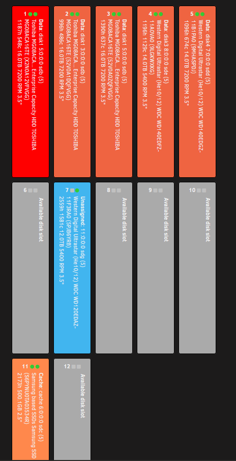

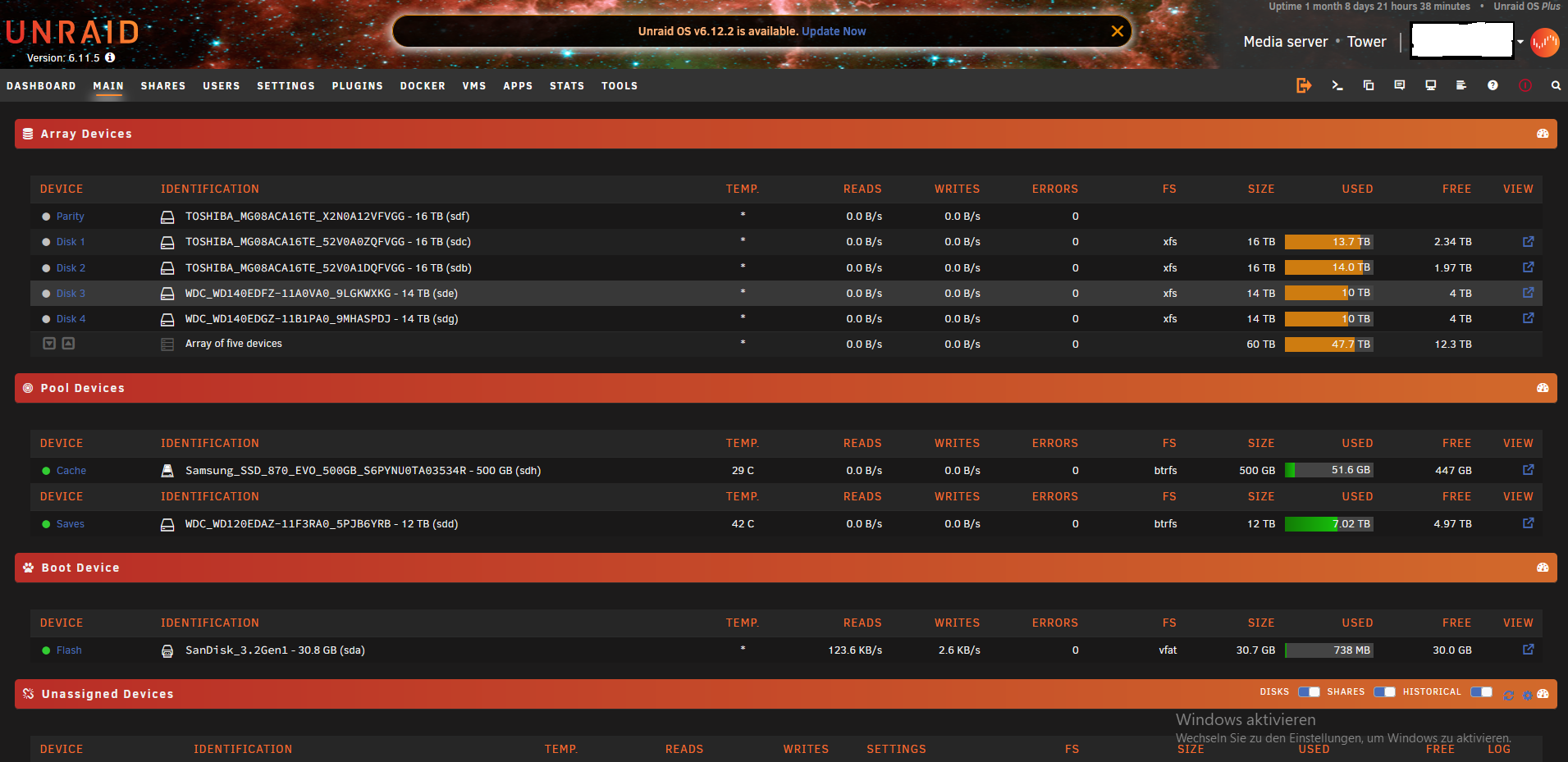

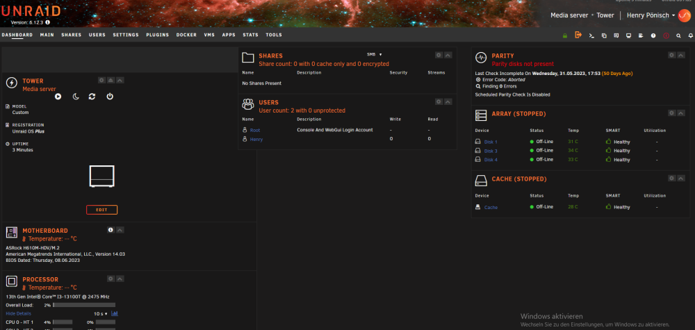

July 20, 20233 yr Hello, I used for my unraid system amd ryzen pro 4350ge with an ASRock A520-HVS mainboard and an m.2 sata controller card. Months ago I switched to an Intel 13100t and an Gigabyte H610M S2H mainboard. I tried to save a little energy. And it worked for a few weeks. But then the sata controller and its connected hard drives went missing, why the array stoped working. I think it just broke (because, it is very fragtile; touching a connected cable let the light blink, which shows, if a drive is connected) So I purchased a pcie x4 sata controller (ASM1166+575-Chip). But that won't show up on the Gigabyte Intel combination. When I went back to the ASRock AMD combination, it shows up and everything woks fine. I tried everything in the BIOS, but I coundn't get it to work on the Intel platform. So I used the AMD combination for a time. I recently bought a new Intel board (ASRock H610M-HDV/M.2) and a new pcie X1 sata controller (ASM1166-Chip) to try. I see the controller be detected (all 6 lifhts switch and after a second only 3 lights stay on; for the the connected hard drives, and when I connect a drive to another port, the light pattern for the connected drives is different, but still 3 light are active). But the sata controller doesn't show up in Unraid. I got the original m.2 sata controller to work on the new board for once (but one drive connected didn't show up) Can sombody help me? Do I have to change a setting in Bios? Thanks in regard. I have attached the diagnostics the amazon pictures of the sata controllers. I have also screenshot of the Dashboard and "Disk Location". On Disk Location, the missing drives would be 1, 3 and 7. tower-diagnostics-20230720-1922.zip
July 20, 20233 yr The controller is not being detected by Linux, this is not a software issue, try a different slot if possible.
July 20, 20233 yr Author I have tried it an all slots (both pcie x1 and the pcie x16) and it doesn't show up on any.

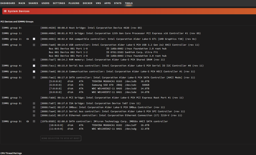

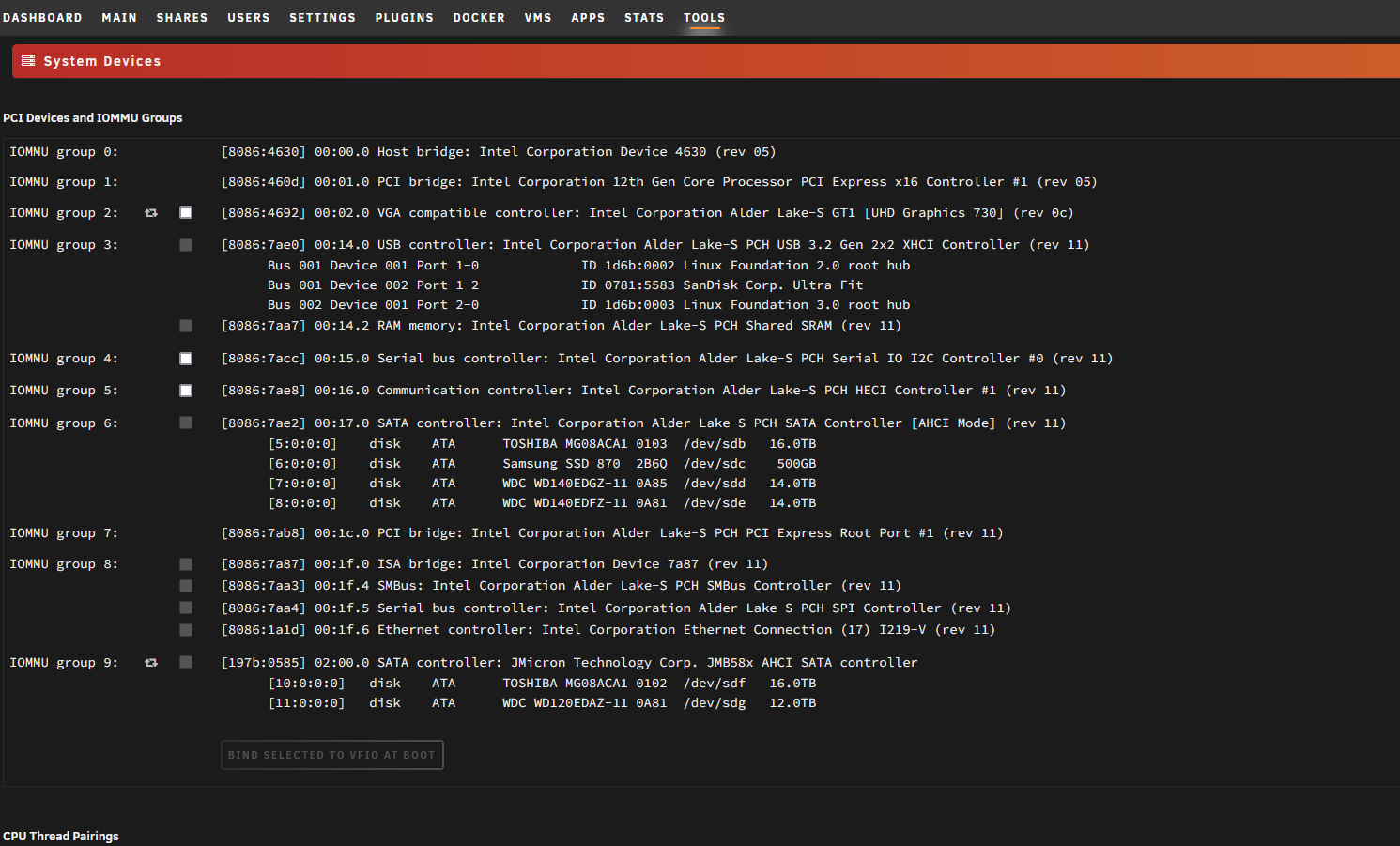

July 20, 20233 yr Author I have also now seen, that IOMMU group 7 (PCI bridge: Intel Cooperation Alder Lake-S PCH PCI Express Root Port #1 rev 11) doesn't show up either. Is this the m.2 slot?
