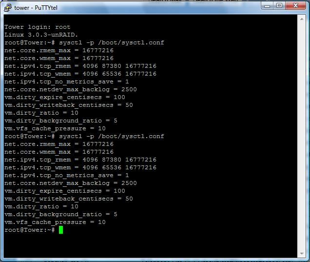

Please download the attached file and put into root of your flash share (same directory where bzimage/bzroot, etc., is located).  Then from command line type this:
sysctl -p /boot/sysctl.conf
Now see if studdering still happens.
Thanks, Tom.
1.  Downloaded file and installed on root of flash share.
2.  Upgraded from b9 to B12 (installed bzroot and bzimage files in their requisite locations).
3.  Rebooted server.
4.  Reviewed all drives (okay).
5.  Started array.
6.  Opened putty telnet session and typed in command as requested (attached copy of output).
7.  Accessed test file on my TViX M6500a
8.  It stuttered immediately, like before.
I've downgraded to b9 again.  Test file plays like a charm.
Thanks, and let me know if you need anything more or want me to try something else.

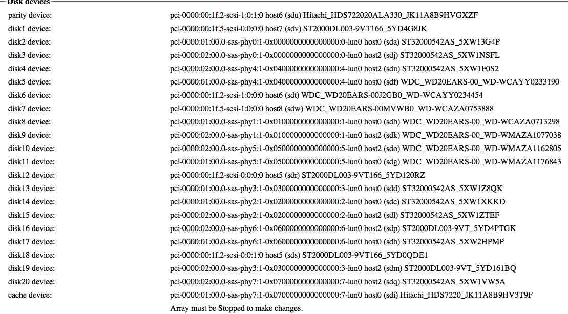

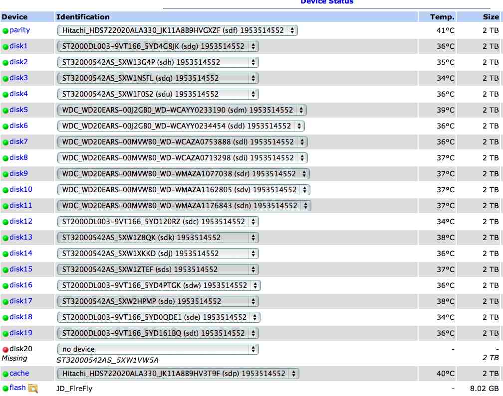

Having a slight issue with a disk not showing up in the dropdown list under 5.0b12.
I have 20 disks in the array and have moved from 4.6 -> 4.7 and that update when well.  All disks were present and seen after the update.
I followed the update instructions from 4.7 ->5.0b12 and all disks were see EXCEPT FOR disk20.
I have attached the output of and ls -al /dev/disk/by-id, ls -al /dev/disk/by-id | grep 5XW1VW5A, a screen shot from 4.7 showing the disk recognized and in the array, and a screen shot from 5.0b12.  The only disk that shows up in the dropdown is a disk I recently precleared.
Attach your syslog. It includes the device inventory that unRAID sees.
Sorry about that, forgot to attach it to another post, the pictures in the first one took up all the allowed 192KB worth of space.
Anyway, syslog is attached now.  The unRAID machine sees the drive just fine, but you can see from a "grep sdx" that emhttp is complaining about there being "too many devices"
root@Darryl_Jacksons_Tower:~# cat /boot/syslog.txt | grep sdx
Aug 26 11:38:59 Darryl_Jacksons_Tower kernel: sd 10:0:7:0: [sdx] 3907029168 512-byte logical blocks: (2.00 TB/1.81 TiB)
Aug 26 11:38:59 Darryl_Jacksons_Tower kernel: sd 10:0:7:0: [sdx] Write Protect is off
Aug 26 11:38:59 Darryl_Jacksons_Tower kernel: sd 10:0:7:0: [sdx] Mode Sense: 00 3a 00 00
Aug 26 11:38:59 Darryl_Jacksons_Tower kernel: sd 10:0:7:0: [sdx] Write cache: enabled, read cache: enabled, doesn't support DPO or FUA
Aug 26 11:38:59 Darryl_Jacksons_Tower kernel:  sdx: sdx1
Aug 26 11:38:59 Darryl_Jacksons_Tower kernel: sd 10:0:7:0: [sdx] Attached SCSI disk
Aug 26 11:38:59 Darryl_Jacksons_Tower emhttp: too many devices to add ../../devices/pci0000:00/0000:00:06.0/0000:02:00.0/host10/port-10:7/end_device-10:7/target10:0:7/10:0:7:0/block/sdx
Aug 26 11:40:13 Darryl_Jacksons_Tower emhttp: too many devices to add ../../devices/pci0000:00/0000:00:06.0/0000:02:00.0/host10/port-10:7/end_device-10:7/target10:0:7/10:0:7:0/block/sdx
Aug 26 11:40:15 Darryl_Jacksons_Tower emhttp: too many devices to add ../../devices/pci0000:00/0000:00:06.0/0000:02:00.0/host10/port-10:7/end_device-10:7/target10:0:7/10:0:7:0/block/sdx
