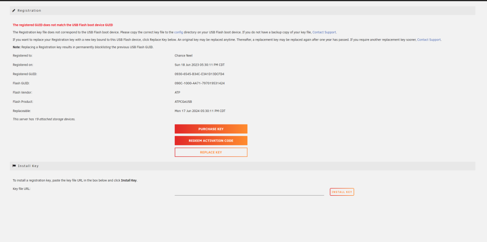

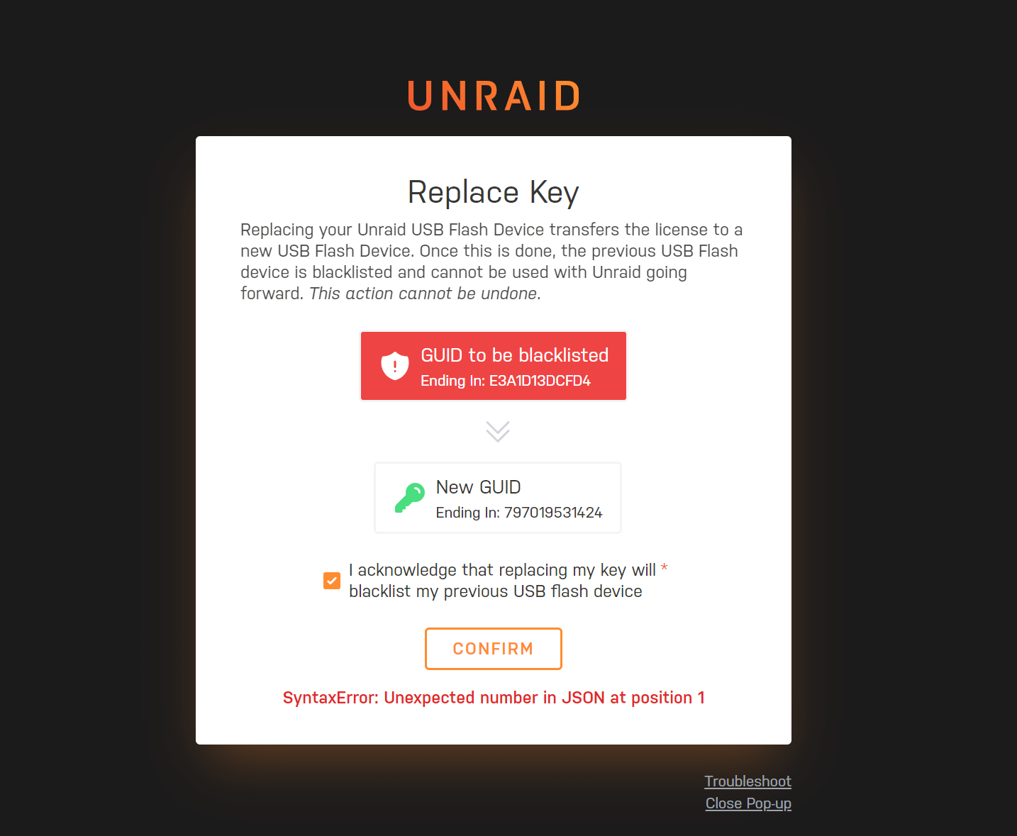

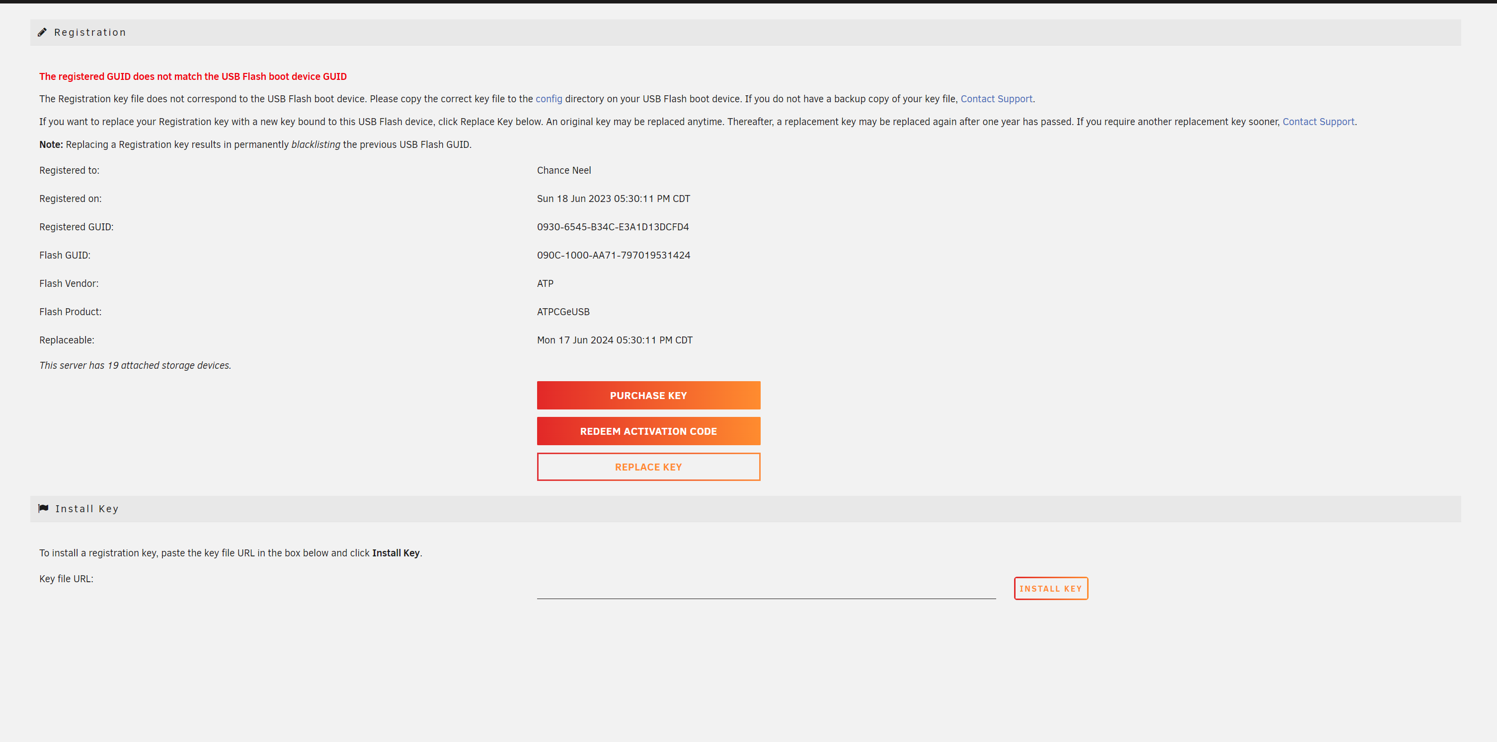

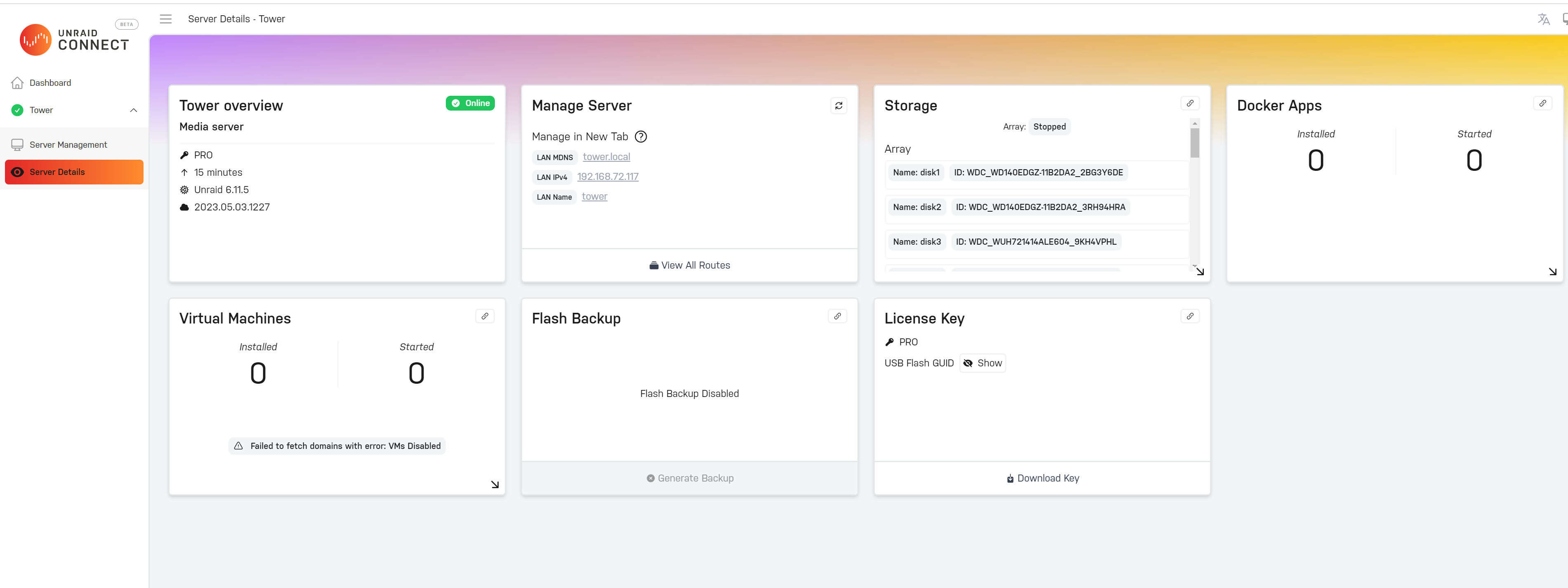

July 21, 20233 yr I get in and have errors that my key isn't activated. I tried going to connect and it simply ends up giving a JSON error at the end. I go look at the my servers and can see my pro key listed there as well as it showing the current server online. What's the deal here? It wants me to buy a second license. I downloaded the pro key then copied it to the directory as it instructed and it's still not working. What other options do I have? Edited July 21, 20233 yr by FlyingTexan
July 21, 20233 yr Community Expert That usually means that the key was replaced less than a year ago, you need to contact support.
