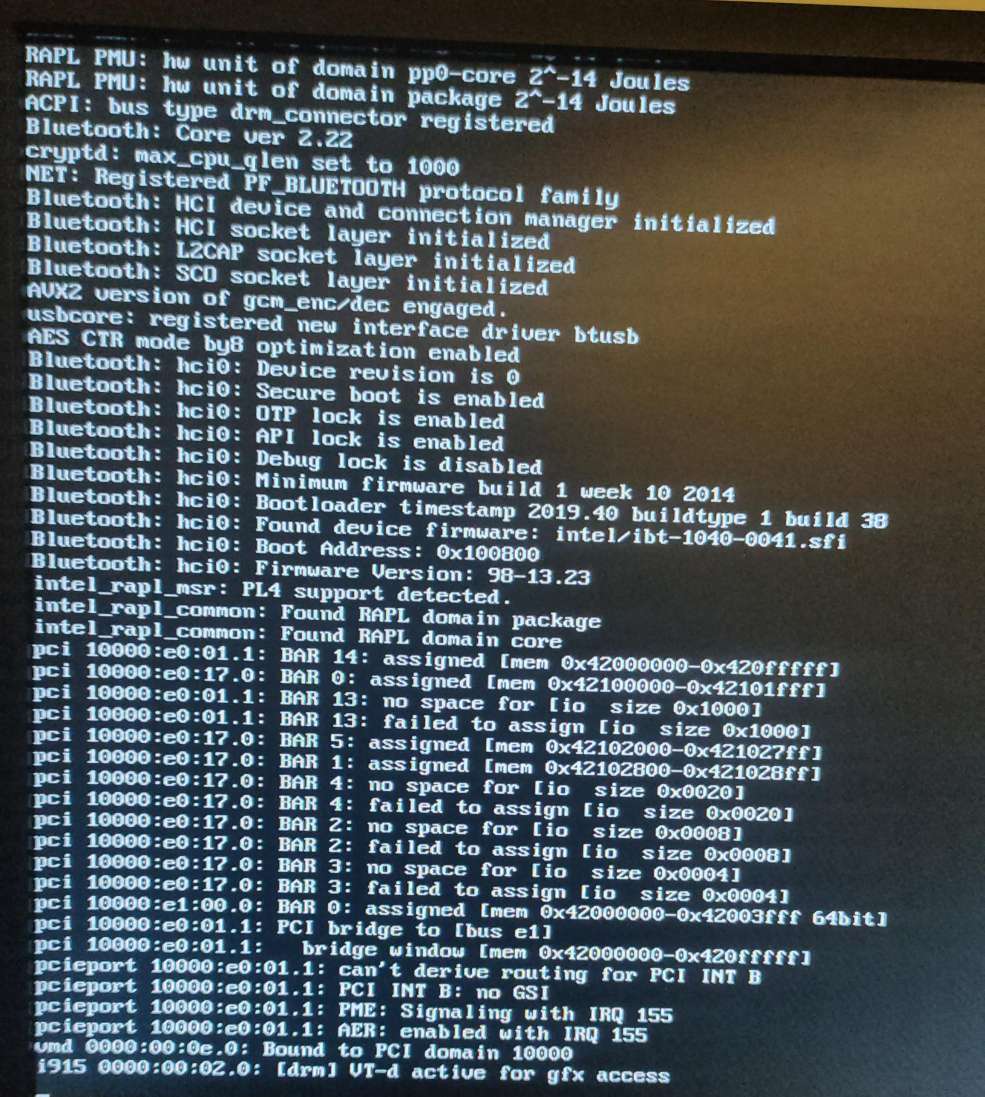

July 21, 20233 yr I am new to Unraid. I would like to try unriad for few days before buying the license. I am using Aorus Z790 Master Motherboard with RTX 3090 graphics card. I have created the USB flash drive successfully trying to boot the system for the first time and system is getting stuck on message visible in screenshot below. Please help.
July 21, 20233 yr Community Expert Try blacklisting the i915 driver: https://docs.unraid.net/unraid-os/release-notes/6.10.0#linux-kernel

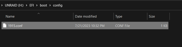

July 21, 20233 yr Author Hello JorgeB, Thanks for reply. I have created a config file on following location with following content, but its not solving the issue blacklist i915
July 21, 20233 yr Community Expert Solution Is the monitor connected to the RTX or iGPU? Does it boot without the RTX?
July 21, 20233 yr Author Just noticed that the conf file need to be in "modprobe.d" directory. Tried this as well Issue is still present.
July 21, 20233 yr Author I tried display port from Motherboad directly and I am able to boot the system. Thanks for help. One more question, with 1915 drivers disabled, the RTX 3090 will work or not?
