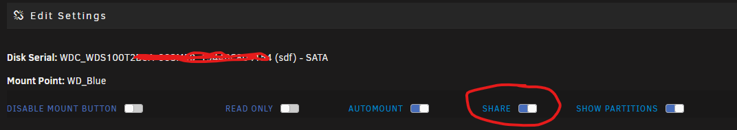

July 23, 20233 yr Ok, so I've connected an external hard drive (4TB, exFAT) to my server via USB. It is recognized via Unassigned Devices. It's mounted (cd mnt/disks/). Everything seems good. I can see the drive via MC and UnRaid's GUI file browser. I want to transfer about 3.3 TB of data from my array onto this external drive. I have tried Filezilla and Krusader and neither are able to "see" the external drive as a destination to copy files to. Is there a setting in the external drive I should have clicked to make the drive visible? Something I should have set up when I installed Filezilla or Krusader as dockers? I feel really dumb here; can someone walk me through how best to set up this file transfer? It's big, and I'm squeamish about using MC because I don't know a way for me to log in later and see the transfer's progress.
July 23, 20233 yr Solution 37 minutes ago, Serverus said: Is there a setting in the external drive I should have clicked to make the drive visible? In the settings for the drive in Unassigned Devices, did you enable sharing?
July 24, 20233 yr Author Well, now I did. 🙄 Thank you - I knew the solution was staring me in the face somewhere.
