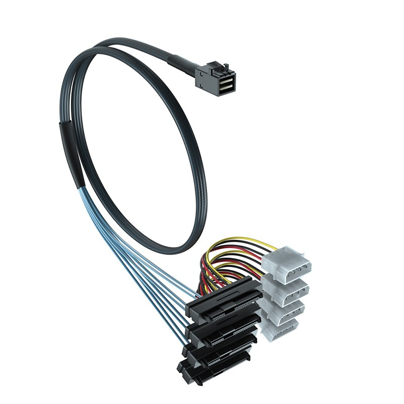

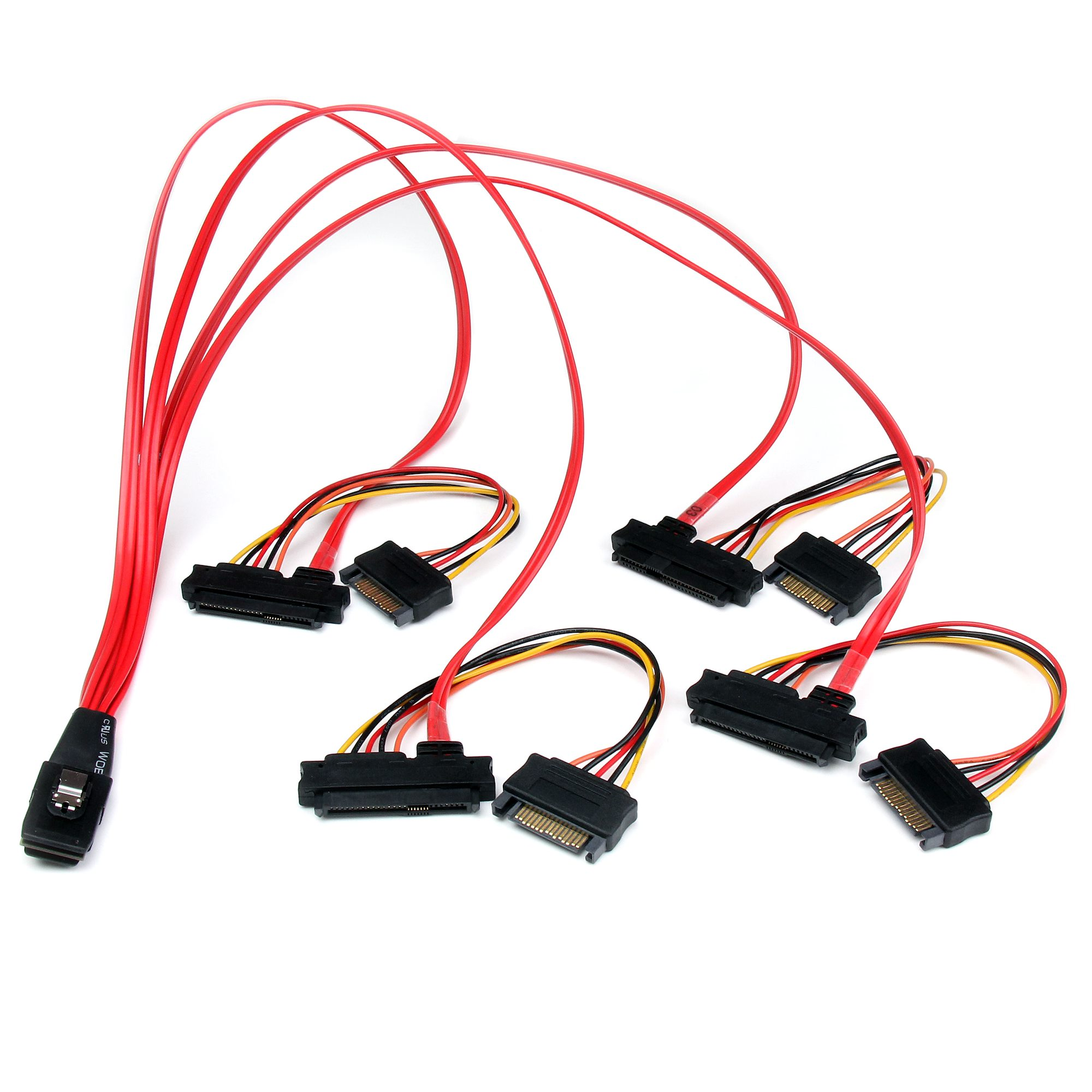

I apologize for what is surely a stupid question.  I'm building a new server, transferring my SAS drives out of an extremely noisy rackmount with a hard backplane for the drives, to a much quieter desktop.  I have a LSI 9305-16I picked out and four SFF-8643 Host to 4 SAS 29Pin cables.
What provides the power for the drives?  Is the HBA powering the drives (and is that why it gets hot)?  Or do I need a special power cable for each of the drives?  I didn't think the PCIE slot could provide enough power for 16 drives.  It looks like the 19 pin connector is meant to have a power cable attached, but I can't find one to order.
edit: Does the sata power cable connect to the 19 pin connector to provide power?  This is the connector I'm looking at using.

I'm not using a backplane in the new case.  That's what I'm moving away from.  So the drives will be connecting directly to the HBA...and power supply via SATA power?
The link can't open, btw you can powerup by SATA or molex power plug will correct adapter. But SFF8643 (LSI 9305-16I) quite expensive then SFF8087.
