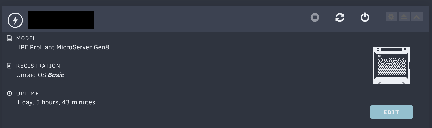

July 25, 20233 yr Hey Guys, Thanks for having me on the forum I'm reaching out to you as I'm facing difficulties with my server. It keeps crashing.. It seems like it was crashing once a month, then once a week and now once a day... I'll start with this.. I'm completly new to the NAS/Unraid world AKA. I'm a noob ! What info would you need to help me with this subject ? I'm runing Unraid 6.12.3 on an HP micro server Gen8, 10G card, 3*18To Dockers : DuckDNS, FileBrowser, NginxProxyManager Please let me know Ben
